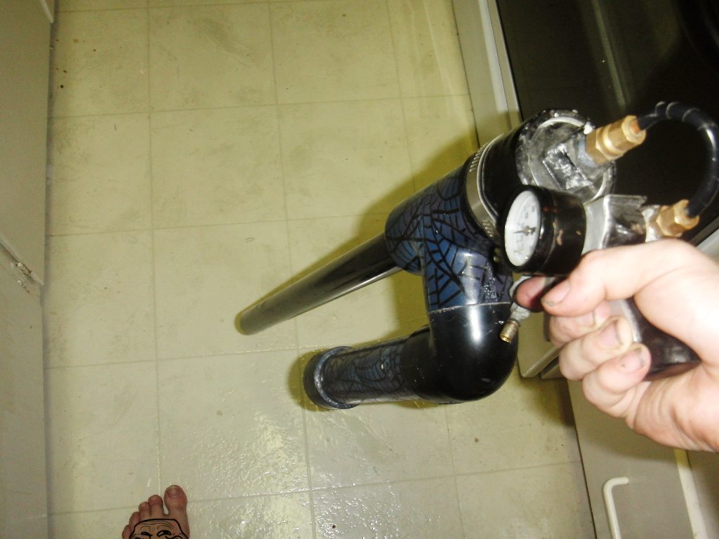

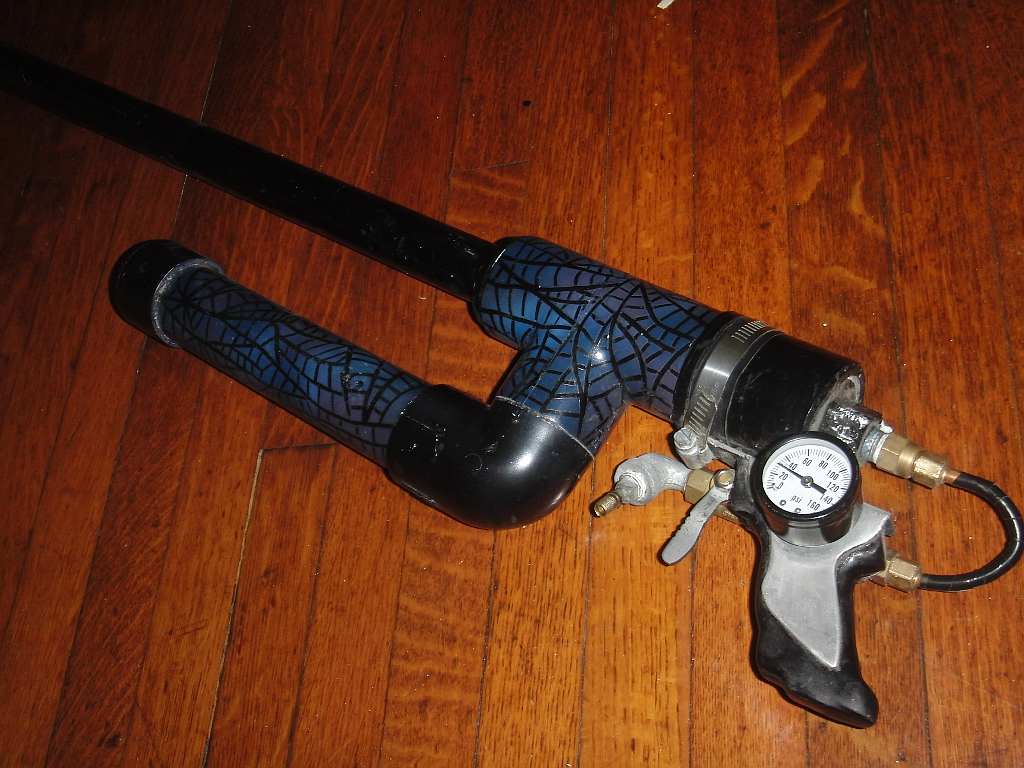

I wanted a general use and test platform pneumatic so I made this. I have some experimental data at the end which I compared to GGDT predictions as best I could. The results lined up quite well and I believe most of inaccuracies were the result of my human-error in pressurizing the gun accurately and consistently.
Video link (with obligatory death metal, of course)
Note for D_hall:
I tried using your valve flow coefficient calculator, but it got through the first couple data sets then got stuck in an infinite loop for some reason.
Also kudos for making this thing so damn accurate. Tweaking the numbers sightly can get near perfect data alignment, but I believe the ones I used are the most representative of my gun.
Specs on the gun:
Chamber: 30 cubic inch
Barrel: 1.05" x 23.75"
Valve: 1.05" porting piston valve
Piston travel: about 1"
Piston mass: 98 grams
Pilot: 1/4" ballvalve
Maximum muzzle energy: ~160 Ft-lbs (217 J) with a 31 gram projectile, 160 psi

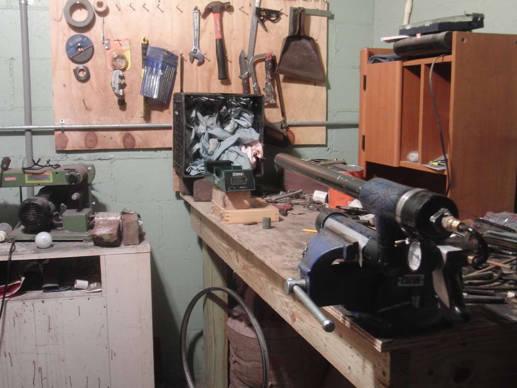

Test bed. I added a plywood shield later to help stop the muzzle blast.

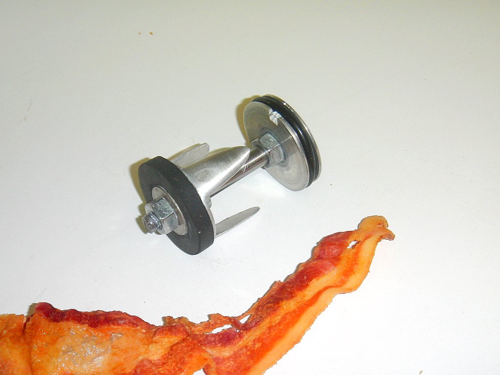

Stainless and aluminum, floating oring. This was made with a hand drill before I got my drill press. And it was very intimidating sanding it down by hand while it was whirling away at 2000rpm.

I like the piston support.

I also like your piston design, very neat and looks efficient.

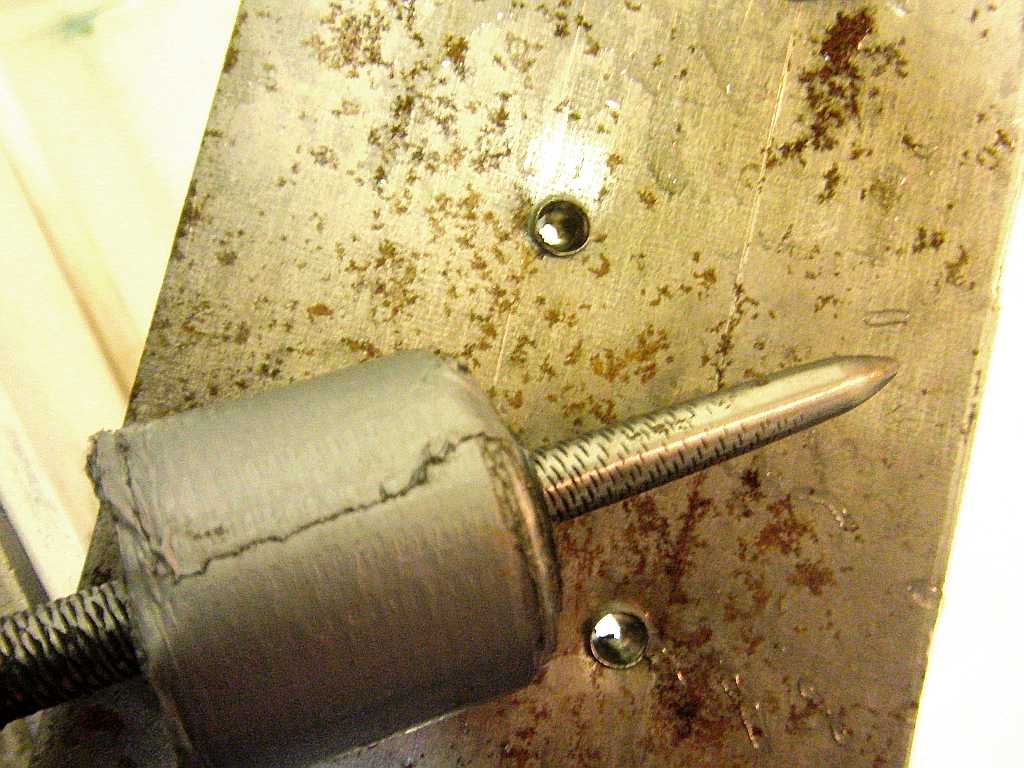

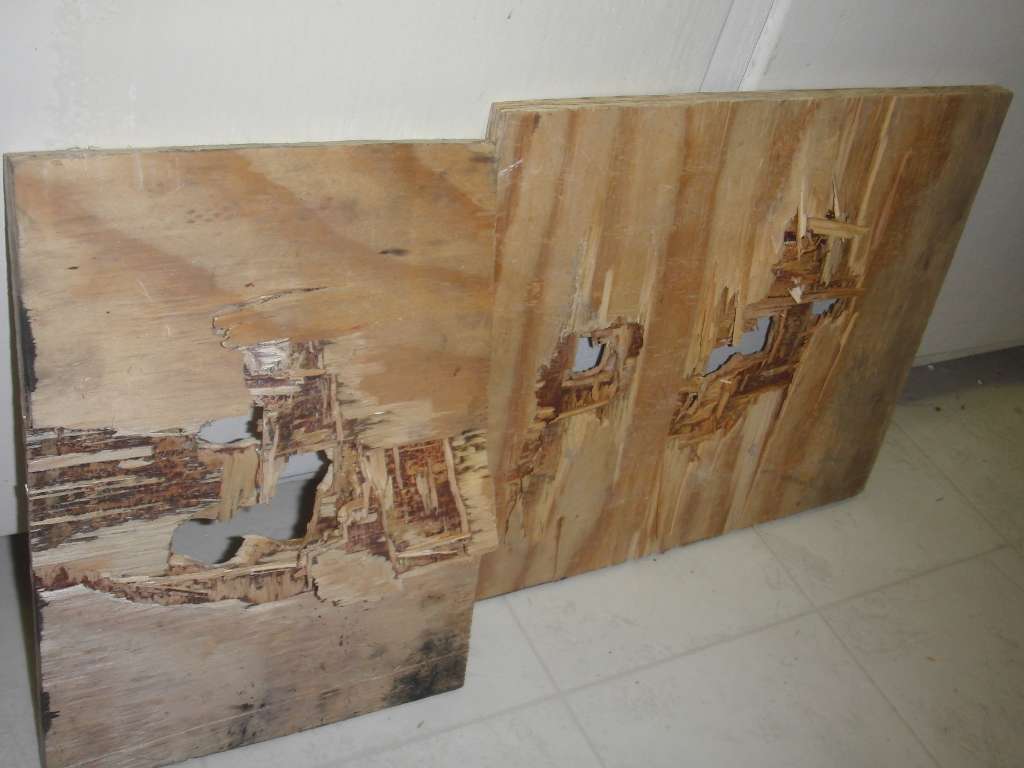

Little penetration test for sh*ts n' giggles.
15 gram chunk of round file vs. 0.130" (3.3mm) mild steel. Technically made it through, but the 'exit' hole is only about 1/16" wide
The ducttape sabot weighed an additional 15 grams and separated on impact, so this was only the equivalent of 75 ft-lbs (~100) joules of kinetic energy against the target.
entry holes are 0.2&amp;quot; wide
entry holes are 0.2&quot; wide
