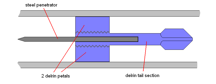

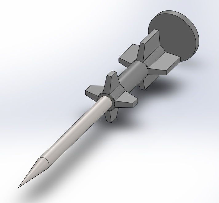

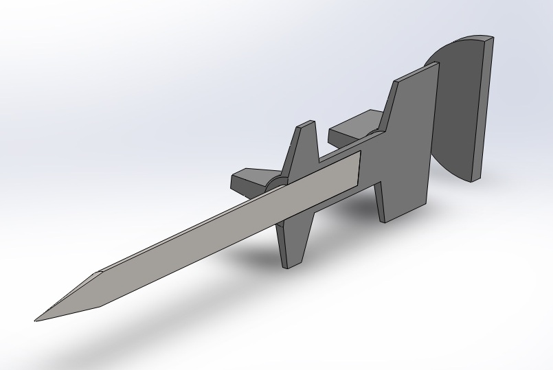

I was into penetrator rounds with sabots earlier and flooded the forum with posts on the subject. I ran into problems with my hybrid before I got to try what I think was my best design so I wonder if anyone else saw my diagram and tested the design. And if not, is anyone with a 1.5"+ bore interested in testing it for me?

Good design, I might try some of these in my mini.
I will also have a read through the topic you linked to as it slipped through my fingers -_-
How do you feel about making a prototype of the design I have above? I know you are the right man for the job as it involved casting :)

SpudFarm wrote:Good design, I might try some of these in my mini.
It's pretty much what I had suggested to you here :D
http://www.spudfiles.com/forums/sabot-idea-t21956.html
I still think the fullbore fin design is the best approach.

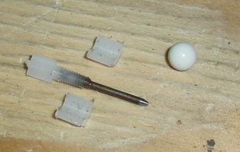

Casting is so last year, it seems you missed this thread too: http://www.spudfiles.com/forums/jsr-wan ... 22750.html
Could give it a go on a smallish scale. What calibre options do you have?
Ouch, I haven`t ever precisely managed to remember my calibers.
I have the Golf ball hybrid - I think 42.8mm IIRC.
I have a mini pneumatic with a 5 and 6mm barrel.
And last I have the marble pneumatic, 16mm?

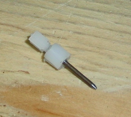

I had impressive results with a AA battery in a sabot for 2.5 inch.

Epoxy casting ≠ Using epoxy as adhesive ;)
That sounds about right. Give me an exact diameter and we'll talk :)

Umm.... I don't believe that's an APFSDS. Unless I'm "seeing" that design wrong, it's more along the lines of an APFSNS.
D_Hall wrote:Umm.... I don't believe that's an APFSDS.
We'vehad this conversationin the same thread ;)
Thanks!
I will measure exactly tomorrow, early morning tomorrow -_-

However, measured the barrel today and its 16.1mm ID.

SpudFarm wrote:However, measured the barrel today and its 16.1mm ID.
Ooops, had missed this :oops:
So, the design I am proposing is roughly the one below, let me know what you think. I would need the size of the nails you have available.
