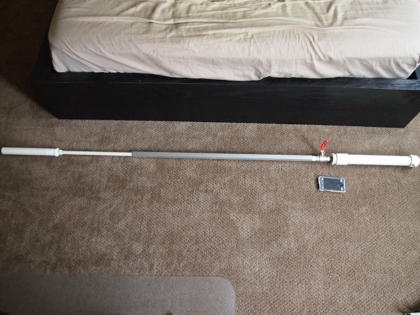

This is my throw back BV launcher, i have had the desire to put holes in things. Being unsatisfied with the performance of my previous launchers I gathered my spare parts and threw together a launcher with the plan of attack being simple but effective.
here she is, No Spare Parts (because I like the Rolling Stones and i now have no parts left)
Barrel: 4 feet of 1/2'' SDR 11
Valve: lubbed chrome 1/2'' BV (gives great flow cause the ball is the same size as the id of the barrel :D )
Suppressor: made for my paintball gun (15 year old sl-68ii) so I know its functional,
note about the suppressor: it works for NSP but only to a degree
Typical ammo: 10mm lead balls
Range: 300-350m at 160psi (feel free to doubt but i will stand witness)

unsuppressed it stands 5' 6'' :)
Heavy ammunition and a long barrel make up for the ball valve's low opening speed, but I would still fit some sort of detent ;)

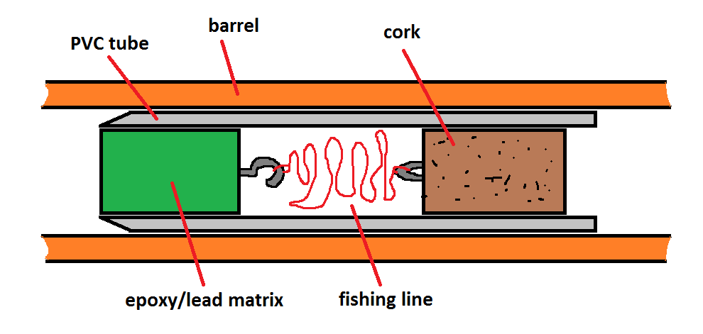

Here's a proposal:
Find some PVC tube with the same OD as your barrel ID. Cut a section 3-5 inches long, and cap and weight one end (epoxy + lead shot for example :D). In the hollow part, put a cork or polystyrene float attached to a length of nylon, the other end of which is attached to the nose.

JSR, with your float idea the cork wont eject, It would have to have a spring epoxied to the inside of the nose. Also I might need a 40lbs test leader to absorb the initial shock of the projectile leaving the spigot and putting a whistle on it would be awesome (trumpets of Jericho).

kydavies wrote:..JSR, with your float idea the cork wont eject, It would have to have a spring epoxied to the inside of the nose. Also I might need a 40lbs test leader to absorb the initial shock of the projectile leaving the spigot and putting a whistle on it would be awesome (trumpets of Jericho).
This is roughly what I'm taking about. Not a spigot type projectile, this fits inside the barrel.
Firing would force the cork against the nose, but it shouldn't come out in flight because it's not being exposed to air drag. You could argue that the low pressure area behind the projectile could create a pressure imbalance that would pull the cork out, but I dont think this force would be sufficient.
Once it's in the water, the cork's bouyancy should be sufficient to eject it.

Ok, then the projectile need holes behind the epoxy but I front of the cork to let it be pulled out by the corks bouyancy. A 1" sdr 21 barrel (24" long give about a 1:1 ratio excluding the length of the hollow projectile because that would have holes near the end) and corks fit in 3/4" sdr 21 which fits in 1" with a bit of tape.

kydavies wrote:Ok, then the projectile need holes behind the epoxy but I front of the cork to let it be pulled out by the corks bouyancy.
Why? If there is air trapped between the cork and the epoxy, it will only help the cork pop out ;) Besides, such holes would allow turbulent air to enter in flight which might pop the cork prematurely.

I was working under the assumption that the cork stays in during flight and basing my idea on the difference in density of corks and leaded epoxy.
When fired the cork is going to slam in to the back of the nose leaving Little to no air. Also residual compressed air from firing will have built up in front of the cork, potentially ejecting the cork shortly after leaving the barrel. Here's a compromise between areodynamics and pressures. Check valves between epoxy and the cork.
Edit: I forgot that its going to slam into the water and going to fill with water (not immediately because of super cavitation) so ya scrap the holes and check valves
Edit***: the end of the projectile can not be flat because the fishing line has to be attached to the back... Cut the PVC on a shallow angle?
