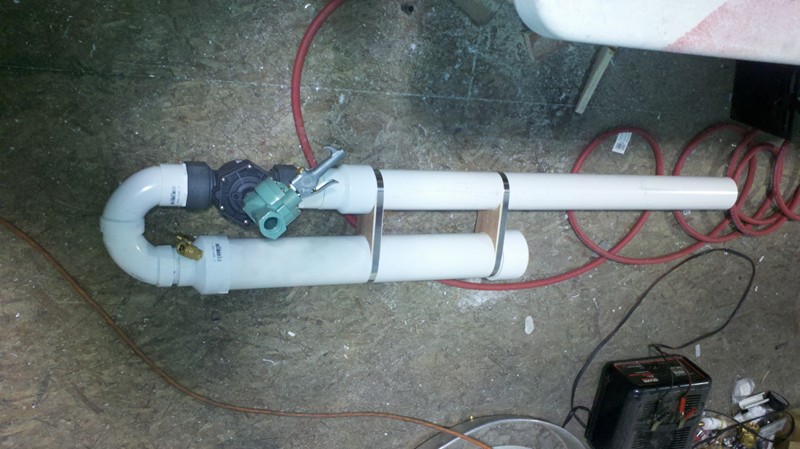

Alright, I think I have settled on a design. I want this cannon to be able to sit as a mortar or hand-held (actually, it will be used as a mortar nearly 100% of the time). It will be fed by my compressor attached to my regulated "Pulsed" output. That output is regulated (0 to 150 psi) and run through a small solenoid valve so it only puts out air when a momentary button is pushed. So, the cannon will sit on the ground attached to the compressor and a tennis ball will be dropped into the barrel, the pulse button will be pressed to charge the tank and it will be fired. This will allow more repeated shots. I may need to setup a large secondary tank to allow more repeated shots before recharging.

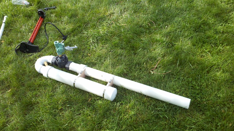

OK, the cannon is finsihed and has dozens of shots from it at this point.
First, the tennis balls sure do fit tight into the 2.5 inch barrel. I was assuming they would slide right in. They really require a firm push to insert. No biggie, though.
Second, this thing is a riot! My boys and I have had so much fun with this thing. For starters, we have been using our bike tire pump. I did not feel like lugging my big compressor home. Plus I wanted to teach my boys how much energy was used with each shot. Letting them pump up the cannon themselves is a good way to demonstrate that. :wink:
So, at 70 psi (about 35 pumps), the tennis ball nearly disappears if shot straight up. I was shocked at the performance of this thing.
We tried numerous things with the cannon. One of the coolest things is to fire two balls at once. The second ball follows right behind the first and is dragged along in the draft of the first ball. You can see the second ball wagging back and forth in the turbulence behind the first. It has turned into quite a physics experiment. This is what this is all about, anyway--- spending time with each other and having fun. This saturday we go out and fire the all metal HPA guns and blow stuff apart. But, for today, we are having alot of fun just popping balls up in the air and trying to catch them.
Thanks for the advice on this gun.
Matt
Exotic E-bike builder, air cannon builder, and overall crack-pot. ;~)
Gun Freak
Lieutenant 5
Lieutenant 5
Posts: 4971
Sweet but Y U USE DWV!? :lol:

Ha ha, good question.
First, AFAIK the only thing that is DWV is the 3 inch tank tube (how can you tell from the pictures, anyway?).
Second, I did not realize it was DWV until I brought it home. The wall thickness is the same as my pressure rated stuff, though.
I am ordering some pressure rated PVC for it. It is cheap enough. I tested this to over 80psi. I would not go any higher, though. 70 psi is best for our application anyway.
I have looked locally and no-one that I have found carries pressure rated stuff above 2 inch diameter.
Matt
King_TaTer
Posts: 265
Joined: Fri Nov 17, 2006 6:14 pm
The two 90° elbows and the bell reducer on your chamber are definitely DWV. You can tell by the socket depth.
As far as your 3" chamber goes, if you thought it was DWV then why did you use it? If it does not read NSF-PW in red or black ink along the side of the pipe, it is unsafe. You may be dealing with cell-core PVC, which is a big no-no for pneumatics especially, regardless of wall thickness.
Great looking cannon otherwise, would love to see it when it's rebuilt. We're all concerned about your safety here and since DWV pipe and fittings aren't rated for pressure, and known to fail, we're obligated to guide you in the right direction.

I am actually ordering schedule 80 pipe and fittings for it anyway. I used this only because it is what I had. I tested it beyond what I am pressurizing it to. So it is OK for now. But the rest of the cannon is good to 150 psi. So, I want to be able to hit that. Schedule 80 is what I will switch over to once it comes in.
I appreciate the words, though.
Matt
