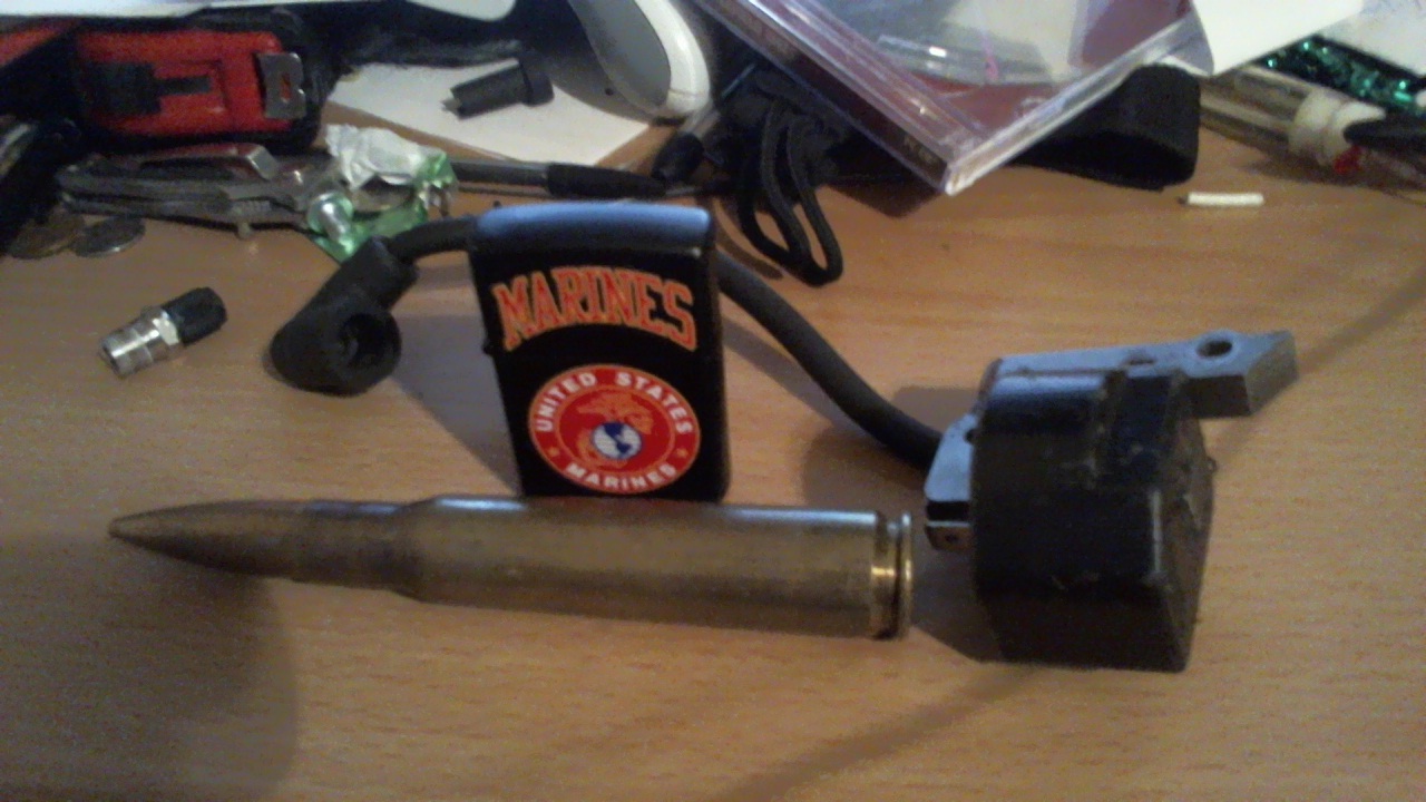

warhead052
- Staff Sergeant 3
- Posts: 1769
Nice .50 cal round. Wait, was that supposed to be your ignition source?
- battlelava
- Posts: 142
- Joined: Wed Oct 26, 2011 9:13 pm
No it was just for size referencing the ignition coil I have. I tried my prison which broke, and I tried steel wool which was a horrible failure.
warhead052
- Staff Sergeant 3
- Posts: 1769
I know. Just messing with you. Yeah, a ignition coil should work, if it doesn't, your fuel mixture is way off.
