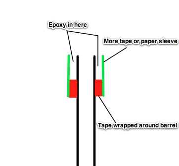

thicken up the barrel where it meets the sealing face. On my latest marker gun I used some tape wrapped around the barrel as a mold around the barrel so I could cast some epoxy in order to make that area of the barrel thicker. Don't worry if this sounds complicated, jsr will probably pitch in and give you 10 more ways to to this if he hasn't already :lol:

I'm gonna keep messing with the gasket material too because it keeps blowing out. Thanks for the ideas i like the flairing idea but it looks complicated. I might try to use epoxy on the barrel or something
