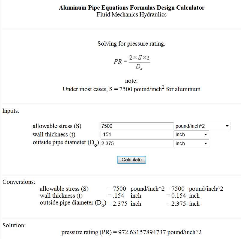

I was looking on McMaster's web site at schedule 40 aluminum nipples. It says to use 150 class fittings which are only rated to 150 psi operating pressure.
They don't have a pressure rating on the nipples but I'm assuming it would be the same as pipe. I went to the following web page to calculate the pressure rating of the size nipple or pipe I want to use.
http://www.ajdesigner.com/phpaluminumpi ... uation.php
According to the calculations the 2 inch pipe is pressure rated at about 972 psi.
I'm guessing the nipple can take 300 psi easily but I'm limited to 150 psi because of the fittings. Is this correct?
Pressure rating for schedule 40 aluminum

- Aluminum-Pipe-Equation.jpg (32.81 KiB) Viewed 11128 times
150 psi rated fittings will not suddenly explode at 151 psi, you're likely to be ok at twice the pressure given the safety factors thrown in by the manufacturers. This isn't of course recommended, but hey, neither are most fun things

Keep in mind that Mc masters pipe is almost certainly not seamless. Its hard to see with aluminum pipe visually, but there is seamed and seamless versions of extruded pipe. Check the ASTM spec.

Thanks moonbogg. I thought all aluminum pipe was seamless.
I just checked and McMaster's says it's seamless ASTM B241 so it looks like it's truly seamless. I was going to buy some aluminum pipe from SpeedyMetals and thread it myself. Their pipe is about 1/2 the price of McMaster. If it's that much cheaper it might not be seamless. Their web site doesn't say if it's seamless or what standards it meets. I'll have to email them to find out. Thanks again for the heads up.
