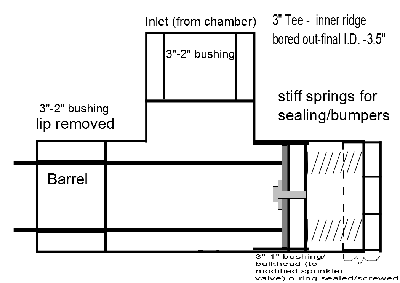

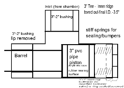

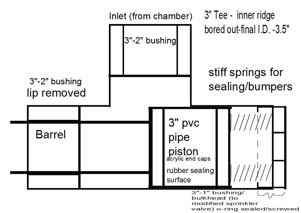

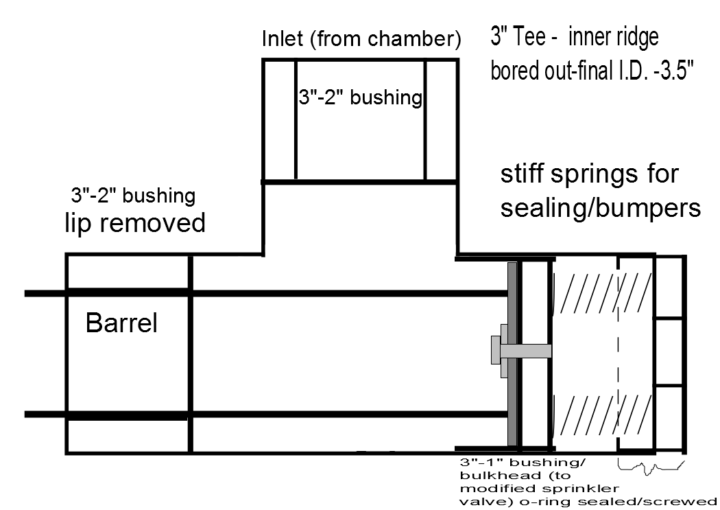

Hi, I'm new to the forum, but I have made a few spud guns before. Most of the valves designs I see on this site and others use a sleeve inside of a PVC tee. I thought up this design and will be building and testing in the next week. My design bores out the "Lip" inside of the PVC tee so that a 3" piston can be used that freely slides within the tee. Any input would be appreciated. Thanks.

Welcome to the forum :)
Here's how I would make it, a lighter piston opens quicker, puts less stress on the bumper and you gain some barrel length too. Of course it would depend on your barrel diameter because you might cause a flow restriction if the barrel is too wide.
I imagine the lip has some structural function, removing it might not be a good idea.

Its done like this in a supah valve so I dont see why not, also I know alot of people who have done this with a two inch tee..
Go Bruins!!!!
True, I've done it myself with a hole saw but I couldn't bring myself to use it as I'm scared of large diameter PVC enough as it is. The lip probably does only act as a stopper for pipe that is socketed in the tee but I assume they take it all (the presence of pipe in the tee sockets) in to account when they rate them.

jackssmirkingrevenge wrote:Welcome to the forum :)
The outlet pipe is 2" running right to a threaded adapter for the barrel, so 1/2 should be enough space around the barrel. I like your lighter piston design, as the acrylic is heavy. It is actually scraps of solid surface countertop (Corian). It smells very bad when drilling or sanding it. Unfortunately I will not have access to the drill press or lathe until friday :cry: , but I'll see what I can do until then!

At this stage I am still prototyping, I will possible machine a one piece piston eventually. However, I have the acrylic and the pvc, and the pvc will fit so perfectly in the tee, it isnt worth the cost and effort to machine the piston at this point.
