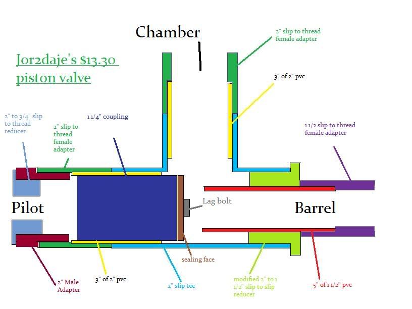

8) Yep lol Im trying to make a simple piston air cannon for my first try on a piston valve, have not made them before so il need help and a design:P.
I would prefer it to be a PVC design.
If that is possible it would be greatly appreciated by me.
Thanks

Mate best advice, go to bunnings and grab some pvc or steel/brass fittings depending on the pressure your using. (pvc for 0-150psi + anything above that use steel) buy a Quick Exhaust Valve (QEV) off eBay/local pneumatic shop. Exhaust valves are basically a ready made piston valve. it can be very frustrating designing and building a piston gun because you have to get the piston just right or the valve will fail. pilot the valve with a blowgun or ball valve and your golden.

I am feeling generous today here is a awesome diagram this is as good as it gets. If you cannot figure it out than you have issues!! Also, Mr. Crowley or any other moderator, can we make this a sticky?? I think it would be good for the noob, I mean new people!!
http://i715.photobucket.com/albums/ww15 ... 1275024415
