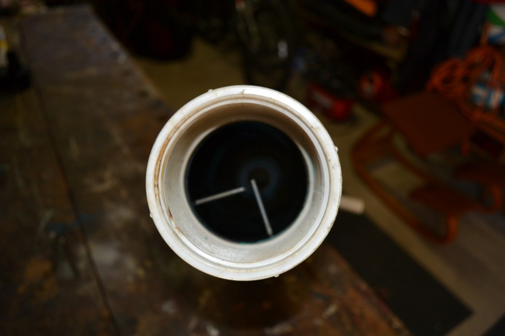

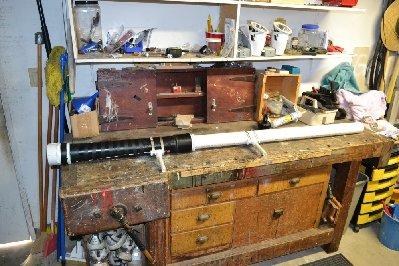

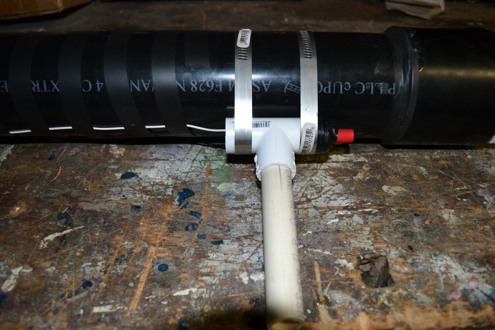

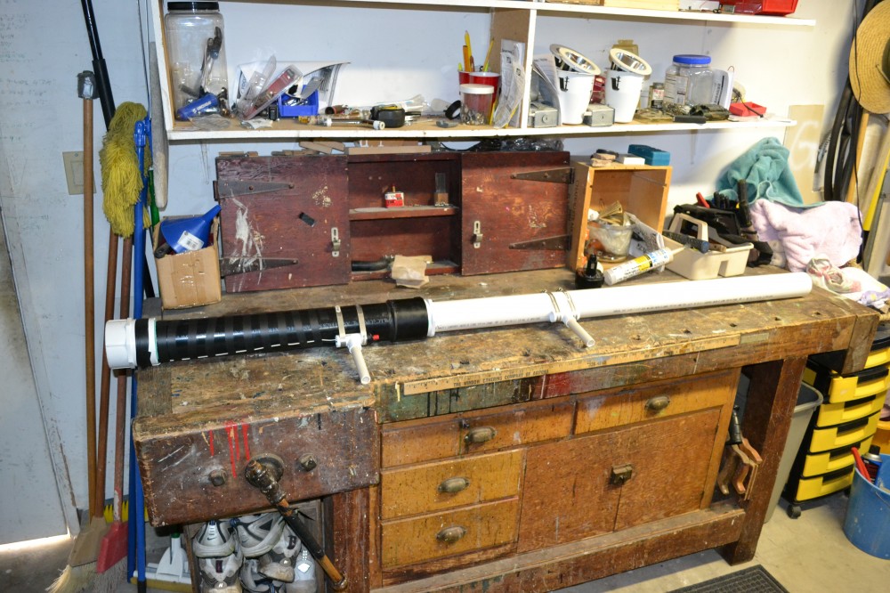

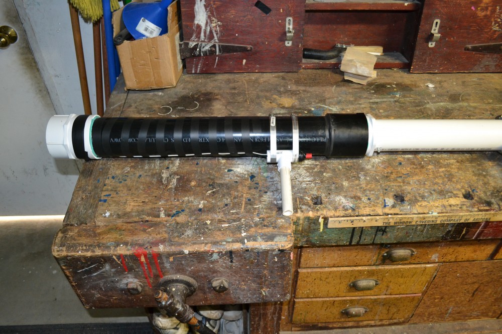

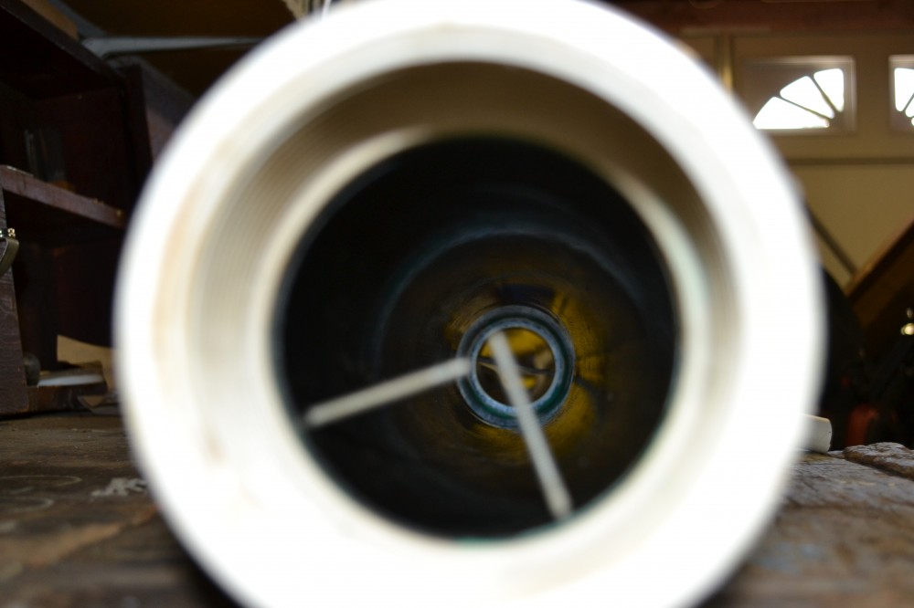

This is my first ever tennis ball cannon. Right now it is in the process of being converted from a spray and pray into a syringe injection. the reason i chose syringe injection is because right now with spray and pray it will only shoot 200 yard about 6/10 of the times.
Parts
2.5" x 48" (Barrel)
3" x 24" (Chamber)
2 Grips
In-Progress
Internal Combustion Fan
Stun-Gun Ignitor
A way to introduce 103.2cc Of Butane In
Any Constructive Criticism And Ideas For Upgrading And Making This Cannon Better Is Encouraged
My First Tennis Ball Cannon
