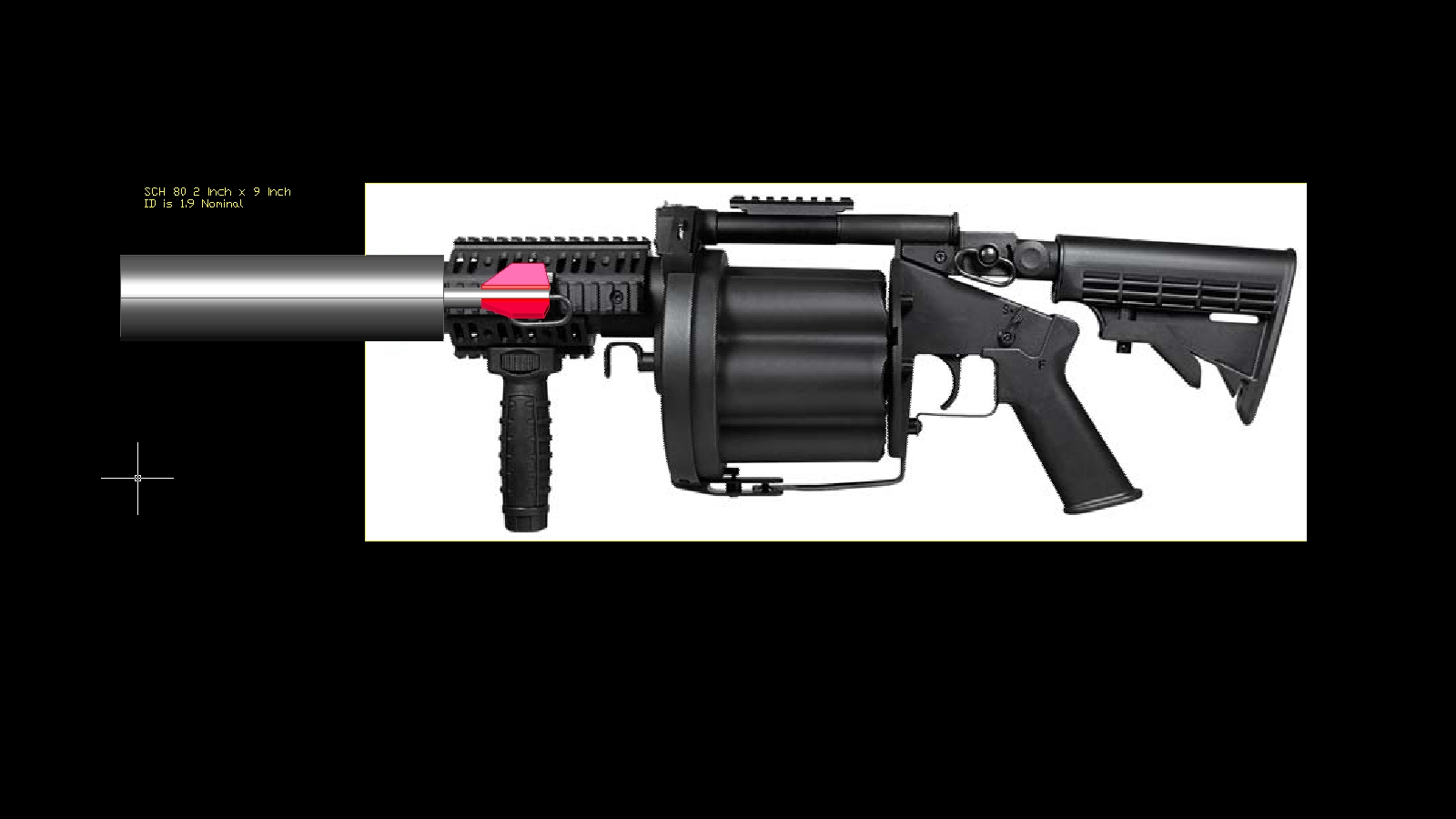

dewey-1
Posts: 1298
Location: NE Wisconsin USA
The biggest problem I see is that you have no barrel for the Nerf Rocket.
This would help substantially with much further range and accuracy.
What is the OD of the barrel behind the Orange ring?
Dewey makes a very good point, the friction is costing you a lot of velocity, especially if there is no seal between the drum and the breech.
An ideal projectile for dramatic range increase would be a sub-calibre dart, but then the question is how safe do you need it to be?

I think you guys are absolutely right about the friction you have to force the nerf round into the barrel to make it work. Safety wise, i don't plan on shooting this round at people, only tanks and buildings but there is still an off chance that a person could get hit by the round so it needs to be very safe. As for barrel OD i will need to check that,but i like the idea of an extension.
dewey-1
Posts: 1298
I have used a dry spray on mold release with PTFE (Teflon) on Nerf Vortex which will help. You should be able to find something like this locally;
http://www.imscompany.com/Public/ItemDe ... sol%20Cans
As a side thought for the barrel extension.
It could be made such that the extension has a quick attach/release mechanism to the launcher so each extension could hold a preloaded Nerf rocket that is protecting the rocket until time for use.
Example; six preloaded extensions that could be pushed on and rotated to lock in place.

Thanks for preventing me from making a stupid mistake. I think i will get to work on this round ASAP. one last question though, I see that this dart has fins so do i need to mess with the center of gravity of the dart to make it more stable or will the fins take care of that?
