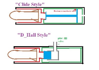

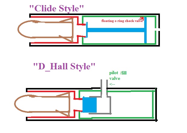

I can think of 2 ways, but is probably the "clide style" one.
Clide Style:
+ better flow
+ more streamlined
+ no solder/braze/epoxy
+more serviceable
-heavy piston
-must run pilot line to the back (mechanical or large pilot volume in hose)
-probably needs floating o ring check valve
-piston needs additional stabilization (a la coaxial barrel support type thing (not shown)
D_hall style
+ light piston
+no piston seal necessary
+pilot port near trigger area
+ easy to ghetto rig with epoxy
- not really servicable (without going to great lengths)
-hole in chamber wall
- marginally less flow
With high pressure (300 psi + maybe, a standard tee valve could be used used along with a smaller chamber, allowing a longer barrel and therefore higher velocity at a given maximum acceleration.
Clide Style:
+ better flow
+ more streamlined
+more serviceable
-heavy piston
D_hall style
+ light piston

Did D_Hall make a valve like that? I remember I drew up a very similar design years ago; always wanted to know if someone had ever tried it.ramses wrote: D_hall style
+ light piston

Yeah (sort of). He made that pneubmatic canon that he shot the watermelon in HD, >5000 fps video. I was hoping JSR would provide a link, since I didn't feel like searching.MrCrowley wrote:Did D_Hall make a valve like that? I remember I drew up a very similar design years ago; always wanted to know if someone had ever tried it.ramses wrote: D_hall style
+ light piston
I think he had a conventional tee valve, but ran the pilot line through the chamber for ergonomics/aesthetics.
Fine, yeesh. http://www.spudfiles.com/forums/john-daly-t20239.htmlramses wrote:Yeah (sort of). He made that pneubmatic canon that he shot the watermelon in HD, >5000 fps video. I was hoping JSR would provide a link, since I didn't feel like searching.
No.Did D_Hall make a valve like that?
You did: http://www.spudfiles.com/forums/linear- ... 14957.htmlI remember I drew up a very similar design years ago; always wanted to know if someone had ever tried it.
The issue is, depending on how big of a barrel you want, (diameter), you will have a fairly small chamber volume with restricted flow due to a tube-shaped column of air. Also, some part of the barrel (even if it is reduced to ~1" diameter) must go all the way to the back of the launcher, adding dead volume and using chamber space.Live1nce wrote:I really like that mouse musket design!
what I called the "D_hall style" valve (sorry, MrCrowley) has the issue of a few hundred pounds of force acting on the piston slide assembly trying to push it away from the barrel. It can be supported, but this reduces flow.
