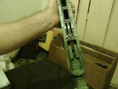

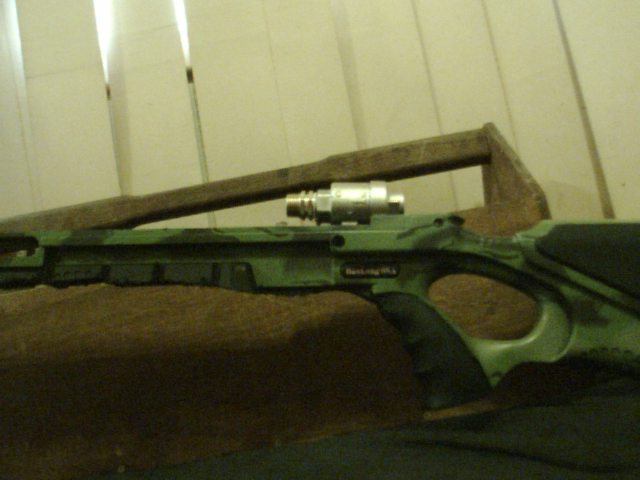

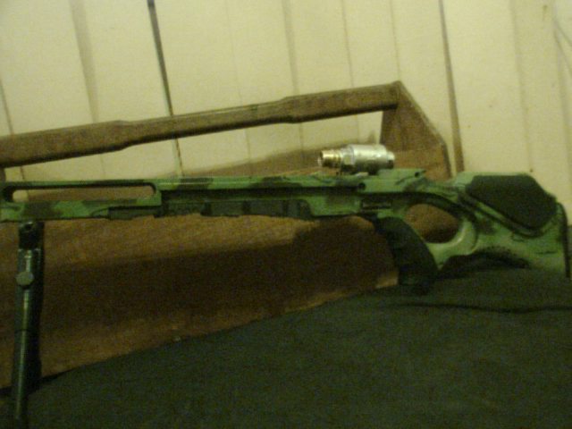

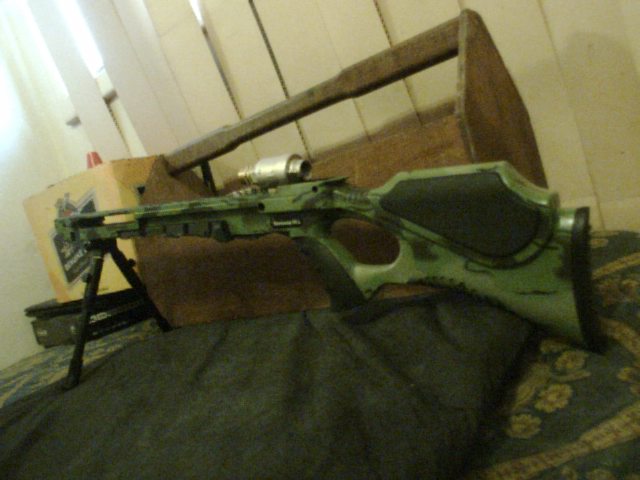

Hi guys.... I am going to use this (chinese made) full - moulded crossbow stock, for my
Qev rifle build.
I want it to be semi - auto, (muzzleloading for now is okay).
I will be using the following: 1/2 inch 250psi qev , parker 3 way trigger valve, ninja slp 300psi regulator, a 3000psi "spare air" scuba "buddy bottle"... No firing chamber made as of yet.
If you look at the pics below, i was thinking of having the main air tank joined straight out the back of the qev where it is (roughly) sitting in the pic now, but raised a little so the air bottle can sit on the top of the (rifle butt) and fasten it there?... Which in turn would allow space for the firing chamber to run under the fore-stock...,,Ive heard of better performance if mounted directly behind the pilot too, instead of going through a elbow or similar, but not sure if it matters or not?
Although mounted in this way, it would prevent me using open sights or a scope by sitting
up too high and getting in the way when the barrel is on.... Even though the "spare air" scuba bottle is quite small and light, Its roughly 400mm x 70mm.... Its at my work at the moment, so i don't have a pic of it. I will post a photo of it tomorrow.
Considering i am nOOb, any diagrams/suggestions on mounting configurations, firing chambers, remote lines, fittings etc, i could go with in my build would be greatly apreciated and considerd.
Thanks a lot spudders!
PS:, The "inner" barrel is going to be 650mm x 6.03mm in diameter

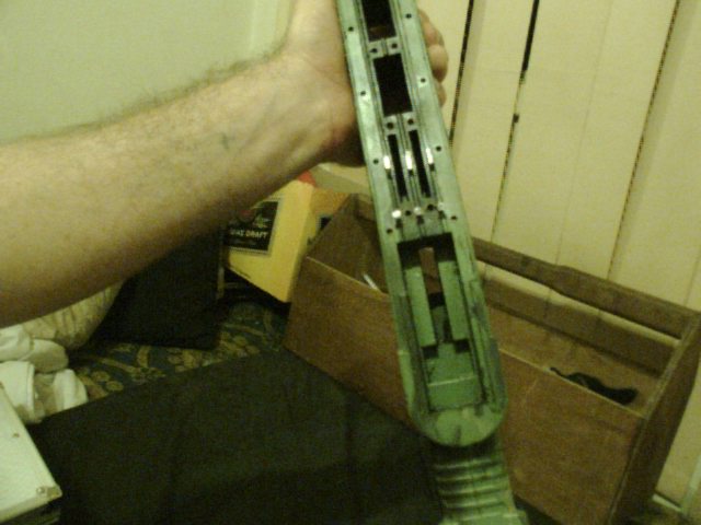

Could be modded in here to make more space if need be.

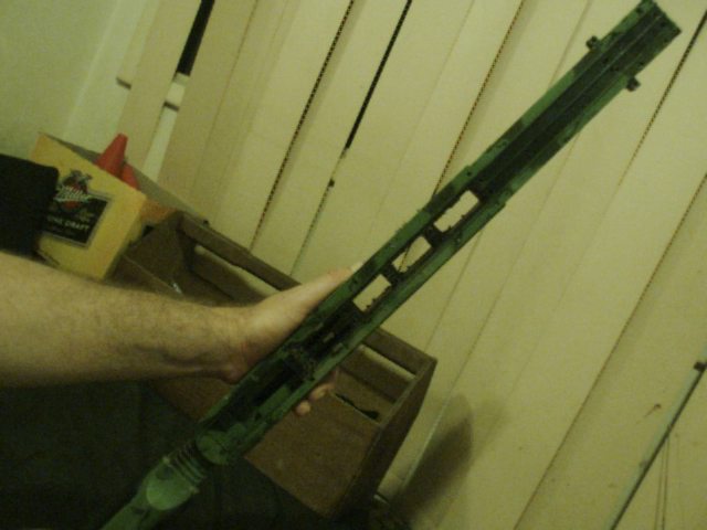

Enough space for remote lines, or 1/2 inch pipe etc, that could go through the fore- stock here, the slots are 40mm x 15mm.
The black plastic moulded stuff, under the fore stock will be removed and tidied up. My little 3000psi -  400mm x 70mm scuba tank could be mounted here, possibly?

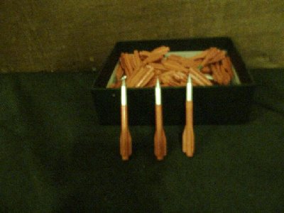

History: This xbow (used) to have 3 &amp;quot;HEAVY&amp;quot; steal rails for &amp;quot;barrels&amp;quot; and could shoot 3 darts at once (see darts other pic) at 245fps and a 268 grain combined shot.<br />Could also shoot nine 6mm balls at once (like shotgun load), sounds good hey?... But there<br />is a problem!....<br />It was HEAVY as hell, 11.3 pounds HEAVY !  By the time i stripped all the metal off of it, including<br />the metal prod!,.... it suddenly lost 5 pound!
History: This xbow (used) to have 3 &quot;HEAVY&quot; steal rails for &quot;barrels&quot; and could shoot 3 darts at once (see darts other pic) at 245fps and a 268 grain combined shot.
is a problem!....
&amp;quot;Camo tactical sniper rifle&amp;quot;......coming soon!
&quot;Camo tactical sniper rifle&quot;......coming soon!

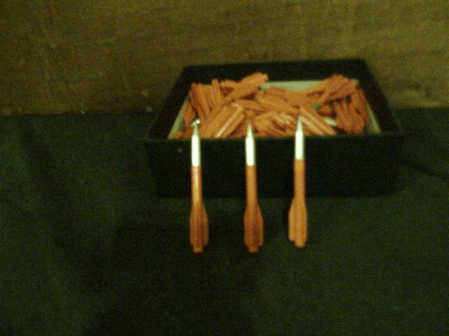

History: It (used) to shoot 3 of these little nasties at once!<br />@245fps, 170 pound draw weight, and good for 50-60 <br />metres, but still way to HEAVY to use easily. weighs about 3kg now ive stripped it down.

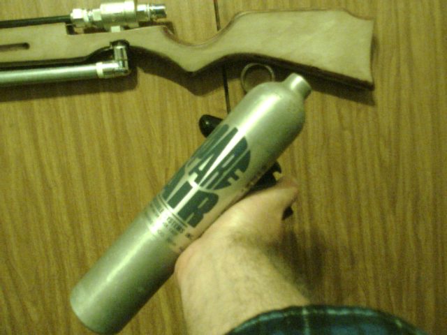

Here is the 3000psi scuba bottle

jonesy42 wrote: I will be using the following: 1/2 inch 250psi qev , parker 3 way trigger valve, ninja slp 300psi regulator, a 3000psi "spare air" scuba "buddy bottle... No firing chamber made as of yet.
Safe to assume that you have tried the regulator in that tank? Wondering if the threads match up?
If you look at the pics below, i was thinking of having the main air tank joined straight out the back of the qev where it is (roughly) sitting in the pic now, but raised a little so the air bottle can sit on the top of the (rifle butt) and fasten it there?... Which in turn would allow space for the firing chamber to run under the fore-stock...,,Ive heard of better performance if mounted directly behind the pilot too, instead of going through a elbow or similar?
Although mounted in this way, it could also prevent me lining up open sights or scope by getting in the way when the barrel is on?....
The air used for the shot will be coming from the firing chamber attached to the side of the qev and not the bottle...having the bottle positioned behind the pilot offers no benefit and will lead to the high mounted sights(and subsequent rifle cant) issues that you mention.

@gippeto,.. yeah the thread on my scuba bottle is 3/8, what if i mount it under
the fore stock, i think it would fit nice there?
Gippeto
Venezuela
Posts: 2506
Been thanked: 17 times
:? Bottle threads on the regulator will be 5/8-18UNF. Outlet thread is 1/2-14NPS BTW.
Under the forestock is a better position IMO....if it's thin enough, a cutout in the butt stock perhaps? Largely dependent on how you prefer a rifle to balance. My preference is to have the balance forward on a bench rifle, and rearward if shoulder fired.

Gippeto wrote::? Bottle threads on the regulator will be 5/8-18UNF. Outlet thread is 1/2-14NPS BTW.
I will measure up to see if the scuba bottle will fit in the stock,..
As, it is sllightly heavier on the barrel end anyway, and that shoulld balance
it out a little... Then i could run the firing chamber under the fore
stock....ill check it out...
