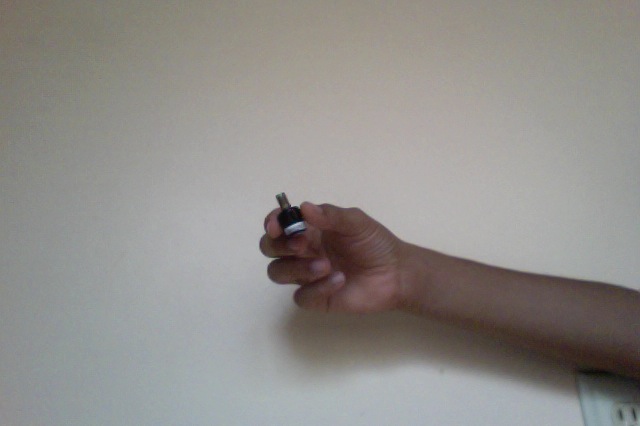

Now here are some pics
Fill/Pilot Valve
Fill/Pilot Valve

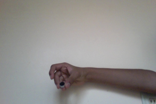

The Piston<br />Plastic cap with rubber glued on
The Piston

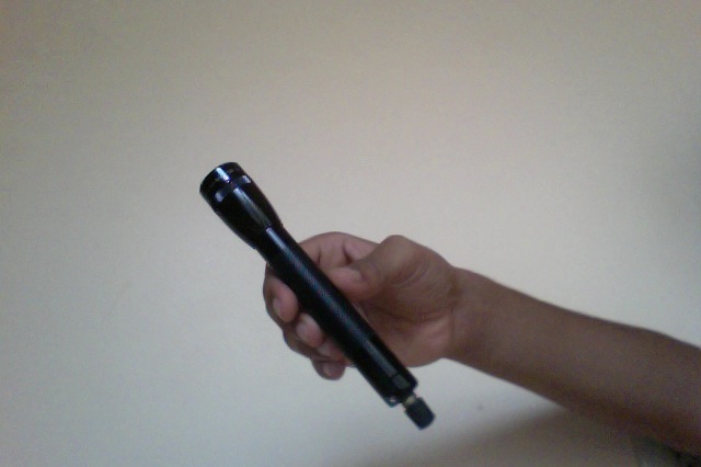

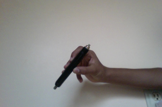

With the Front and Firing Cap Taken off
The Gun In Firing Position
