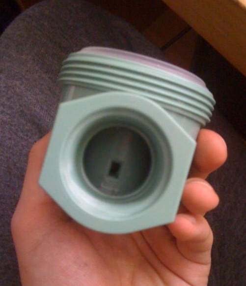

The spring is in place, also in the last picture on the guide a hole is sealed which isn't present on my valve, should I just seal the rectangular one?
you really need to check which holes go where if you do that, the solenoid section is supposed to have two channels attached to it. The retracting section of the solenoid will cover a hole in the center leading to the output. the channel to the section that the blowgun should pilot will be on the side, modifying the solenoid hole isn't that simple you should show us a picture of what you didCharmingEdgar wrote:My sprinkler valve's solenoid was in the middle so i just re-purposed the hole to fit the blow gun
