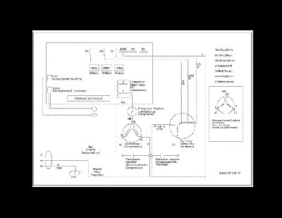

I am guessing that compressor came out of a "Frigidaire air conditioner".
Here is a typical diagram for them.
At the other end of that cable:
The start capacitor is hooked between RED and WHT.
The BLK lead to a 15 Amp 120 V switch. Other side of switch to AC Hot of power cord.
The WHT lead is hooked to AC neutral of power cord.
The compressor frame is connected to GRN of power cord.

thank you! between you, PolandSpud and this thread here : http://www.spudfiles.com/forums/air-con ... 17785.html
i have been able to get it running :) i am so happy with how incredibly quiet it is, i seriously can not thank you guys enough :)
