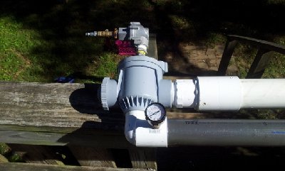

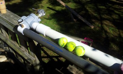

I made this cannon a few weeks ago and I am just now getting around to posting it. The chamber is about 42 inches of 2 inch sch. 80, the barrel is 60 inches of 2 1/2 inch sch. 40 sdr 21, the valve is a irritrol 2 inch sprinkler valve and I am piloting it with a 3/4 inch qev from mcmaster. This thing has alot more power than I expected it to. I am putting a tennis ball at least 300 yards at 150 psi. It kicks like a mule!!! :D It also has a pressure gauge in the chamber, 160 psi max. And thank you 8tonsemi for the tennis balls!! Paint job and breech loading still to come!! Comments and criticism welcome. This cannon has all the stuff thats hard to get. Oh yea, you cant see it in the pics, but I am using my doggies pig stuffed animal as a barrel support held in place by a hose clamp!! :shock: :shock: Doggies not happy about it!! :roll: :roll:

Looks great. Cant wait to see a video.
Also 2inch sprinkler valve or dust collector?

mattyzip77 wrote:Idk yet I havnt really tested it. I gotta put some numbers together for ggdt. I would think a dust collector because its faster. I havnt tried shooting golfballs yet with this either.
Dust collectors are only 1.5" though, right? In that case, the 2" sprinkler valve should kick its ass with tennis balls at the same pressure.
