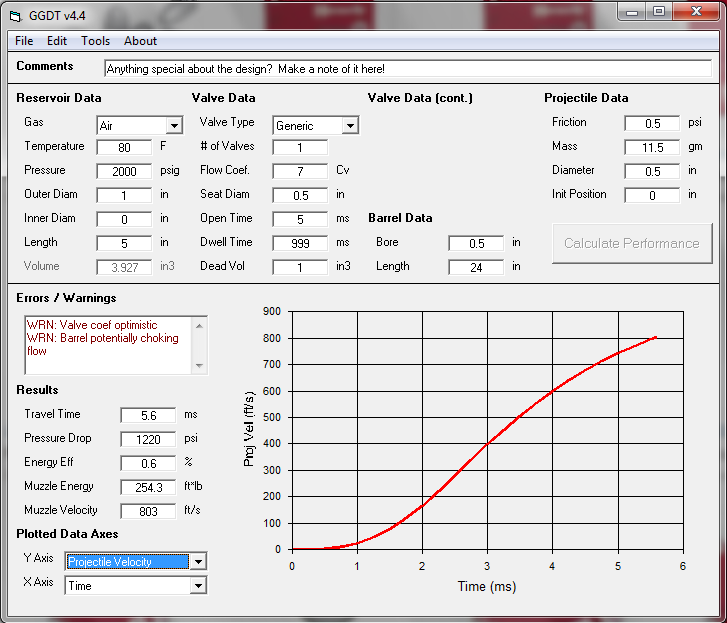

If you want to estimate power, GGDT is your friend: http://thehalls-in-bfe.com/GGDT/index.htmlUsing various attempts at calculating it, I believe if I were to use the 290 grain PowerBelt rounds and an internal pressure of 3000 PSI, then with a 24 inch barrel I should be able to achieve round performance similar to that of a .45ACP pistol round.
With a good enough valve and long enough barrel, you should be able to achieve the sort of power levels you want even with 1000 psi or less. I don't have GGDT available at this PC but will try and make some models at home.

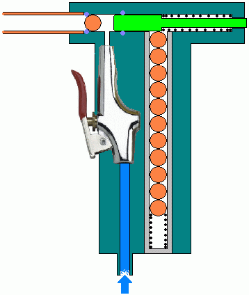

Here's a design based on a similar concept I had dreamt up a while ago, haven't actually made it though:

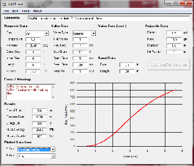

Attached a performance estimate with 2000 psi and an efficient valve pushing a lead ball through you 0.50" barrel, I think performance is close to what you would be pleased with. Do play with GGDT, it gives you a fairly accurate idea of what parameters are important and how power will vary if you alter pressure, chamber volume etc.Schlauncha wrote:Thank you very much for showing me that GGDT program. I will monkey around with it and see what sort of results I get.
HPA guns are loud. If you want power, it will be loud. Efficient guns tend to be big, so for something hand held you will have to compromise. If adding a silencer is not an option, legally I assume it isn't, then noise is something you will have to live with.Projectile to carry power equal to 9mm or higher, and travel subsonic

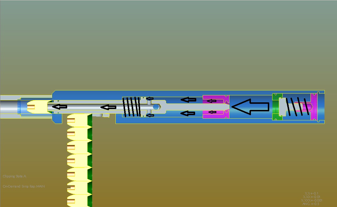

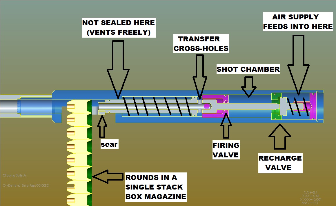

I don't think your concerns here are justified. In the case of the Caselman for example:My thoughts regarding the action's cycle, in terms of open bolt, closed bolt, direct blowback, etc, are that in order to get the most power into the round, the bolt cannot open itself to the magazine feeding area until pressure has dropped (after the round has left the barrel).
You have the same pressure acting on the projectile and the bolt.
The projectile is a tiny little thing, free to move. The bolt on the other hand is a big heavy thing that is held shut by a spring. This means that the projectile accelerates much, much faster and would have barely moved by the time the projectile leaves the muzzle.
Still if that doens't convince you, take a look at the mechanisms I mentioned in the previous post as they literally have no option to function before the projectile leaves the barrel and the gas can escape to affect the mechanism.

Try this mech.
but instead of blowgun use a pressure release valve ment for more then 1000psi
Try this mech.
