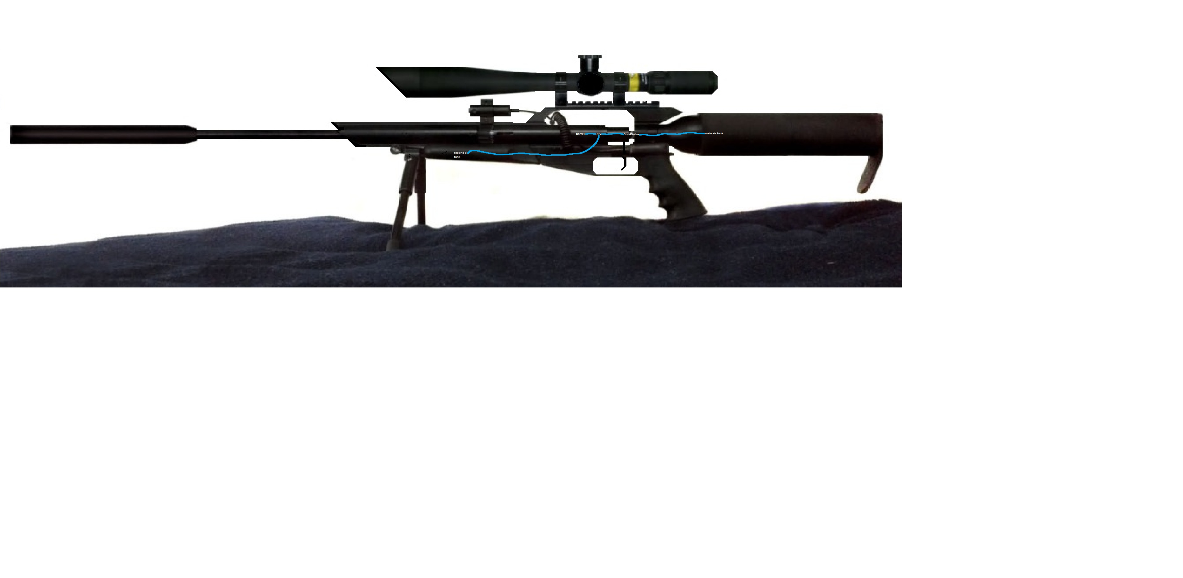

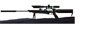

sounds good u will need a hole in the piston though
- jakethebeast
- Corporal 5
- Posts: 945
- Location: Jakes cave
Why? if i had the point the idea in the hole in the piston is just to make it semi auto...
Est Sularus Oth Mithas
- Lockednloaded
- Staff Sergeant
- Posts: 1566
- Location: Texas, USA
- Been thanked: 7 times
You're going to need a regulator between your primary air tank and your slide valve, but besides that your design looks great. Very similar to the inline setup on my inline paintball semi. If you scroll through my thread you'll see the evolution of my loading mech, you should be able to scale them down to airsoft caliber pretty easily
I love lamp
Why do I need a regulator? I am only going to use 115 pli cus my air compresor can't go any more.Lockednloaded wrote:You're going to need a regulator between your primary air tank and your slide valve, but besides that your design looks great. Very similar to the inline setup on my inline paintball semi. If you scroll through my thread you'll see the evolution of my loading mech, you should be able to scale them down to airsoft caliber pretty easily
- Lockednloaded
- Staff Sergeant
- Posts: 1566
Will the gun be constantly hooked up to the compressor? If not, then you'll need a regulator on the gun otherwise every shot will become weaker and weaker as your tank pressure drops
I love lamp
Ok that makes sens. Will this regulator do? BTW can I us a regulator to pump my air tank to say 500psi or more with a commpresr that only dose 100psi? http://www.ebay.com.au/itm/Astro-Pneuma ... 2c650c4948
jake321 wrote:can I us a regulator to pump my air tank to say 500psi or more with a commpresr that only dose 100psi?
Lockednloaded makes a good point, however if you don't want to use a regulator you can compensature by having a large main chamber and small firing chamber. If this is for airsoft then with such an efficient valve you don't need a lot of air for good performance, especially with a long barrel.
