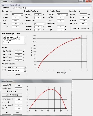

what is the best chamber size for a 16 inch golfball barrel?
i know the 0.8 rule and i used hgdt.... but it seems so small with only 29inch^2.
the finished cannon will be as quite as possible but with resonable power.
what chamber size should i choose?
what is the power i can estimate?

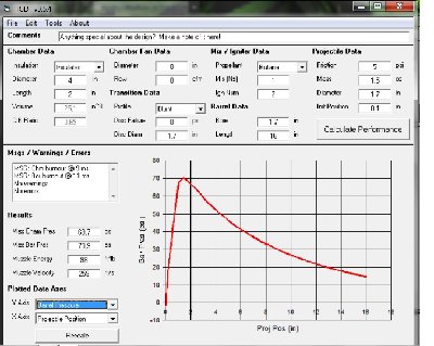

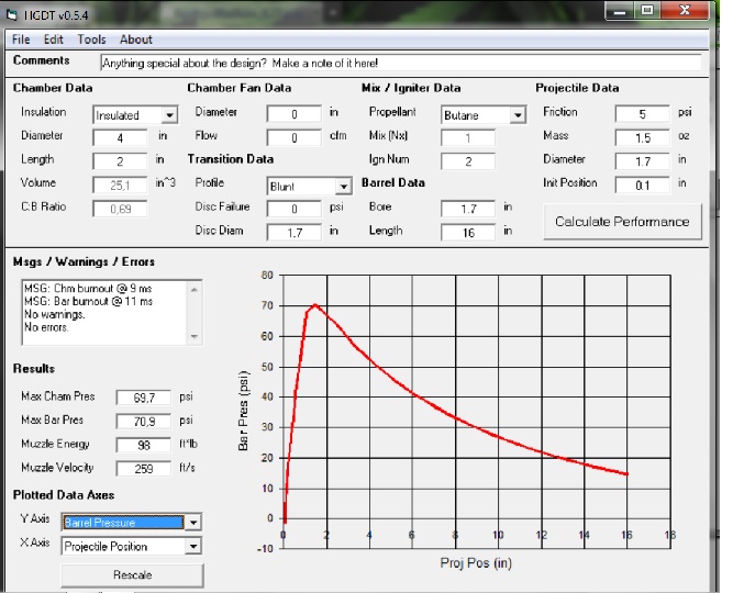

http://www.thehalls-in-bfe.com/HGDT/ok what do you think how far can shoot this thing?

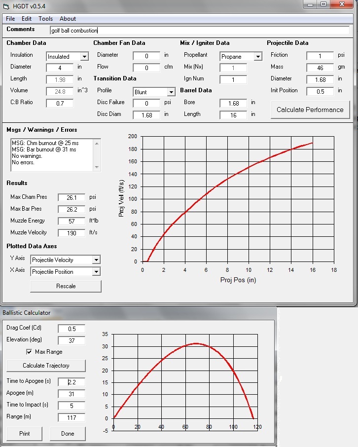

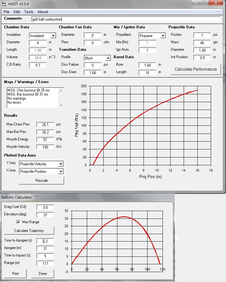

Here's a rough simulation assuming you're using propane:

I would go for 0.7-0.5:1, and of course, syringe metering
