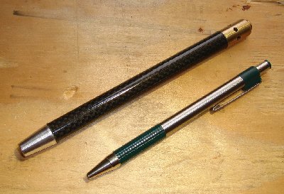

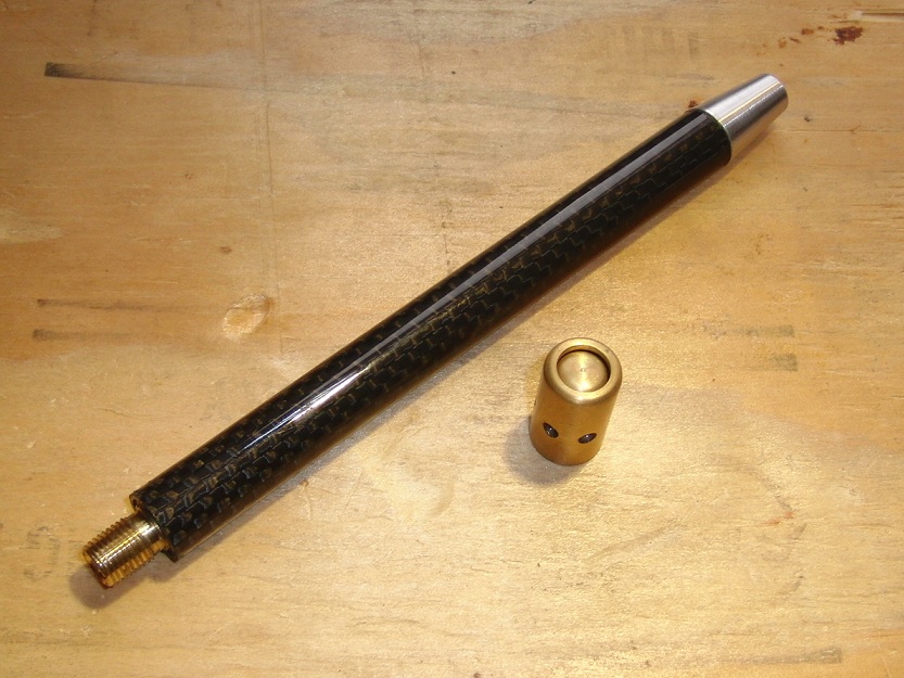

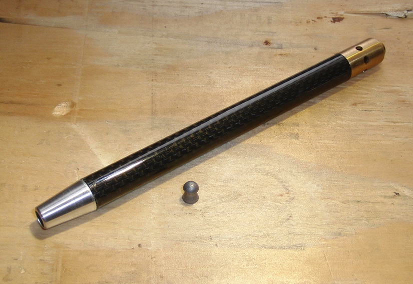

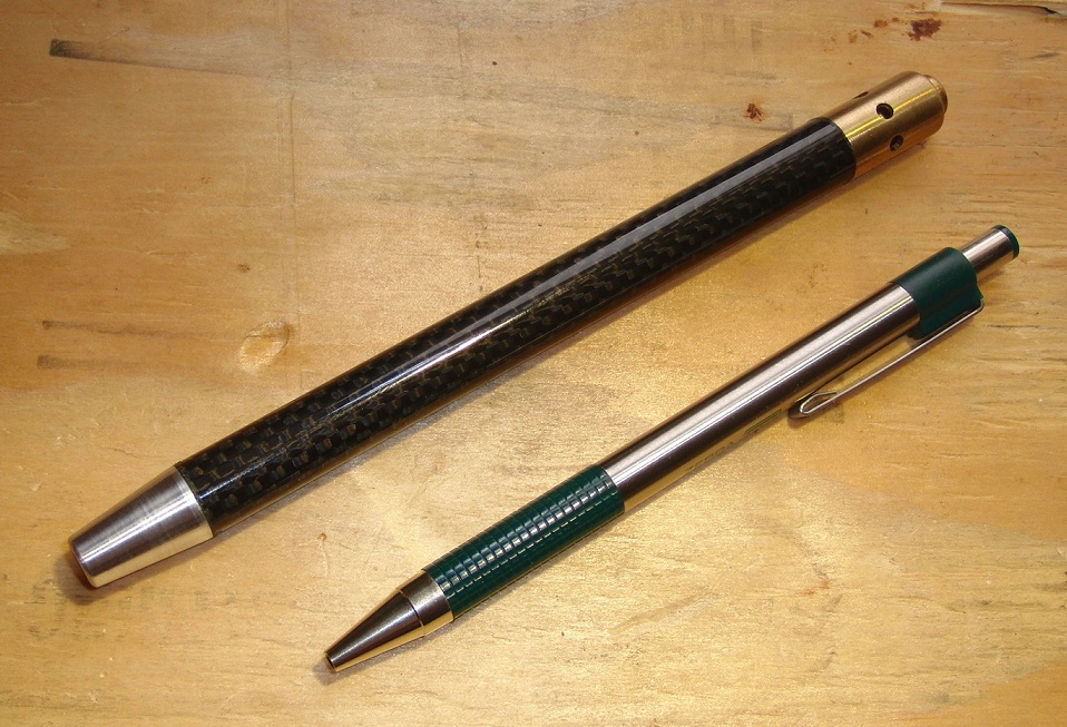

Just a little something I've been playing with, same old pengun design but using new materials.
I upped the calibre to 0.22", a bit overambitious and the 10mm internal diameter of the body tube does not allow for much air but still, it will happily push a 16 grain pellet through a beer can. Here it is in action at 300 psi:
carbon fibre pen gun

No, pure CF tube. This stuff.pneumaticcannons wrote:So is the body re-enforced or completely CF?
I don't know if I'd trust this one with that pressure, but there's definitely scope for a 200-300 bar pengun...A 4.5 mm at 200 bar would make this thing a serious killer

Just had a "why didn't I think of that" moment. I mean, those arms are perfect; robust, sexy, and practically made of epoxy.No, pure CF tube. This stuff.

... and this is at just 300 psi! Tried it at 400 and it leaked :-/
With your machining abilities ....couldn't you get the most out of the concept by using hydraulic tubing?
The little sherline doesn't really like steel, but there's no reason why a sufficiently thick walled brass or aluminium small bore tube couldn't safely take 300 bar.
