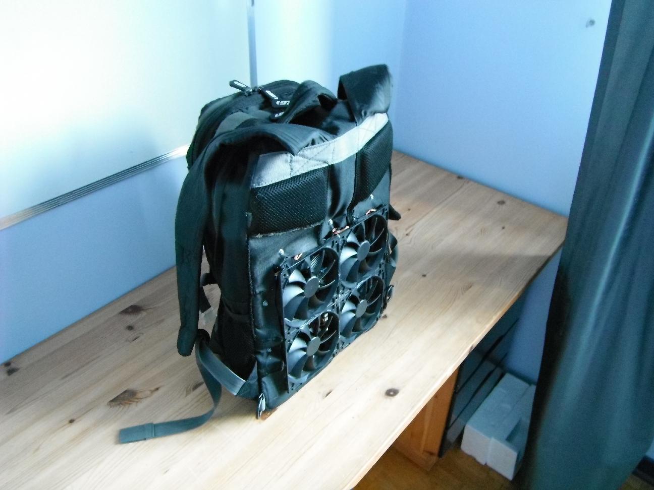

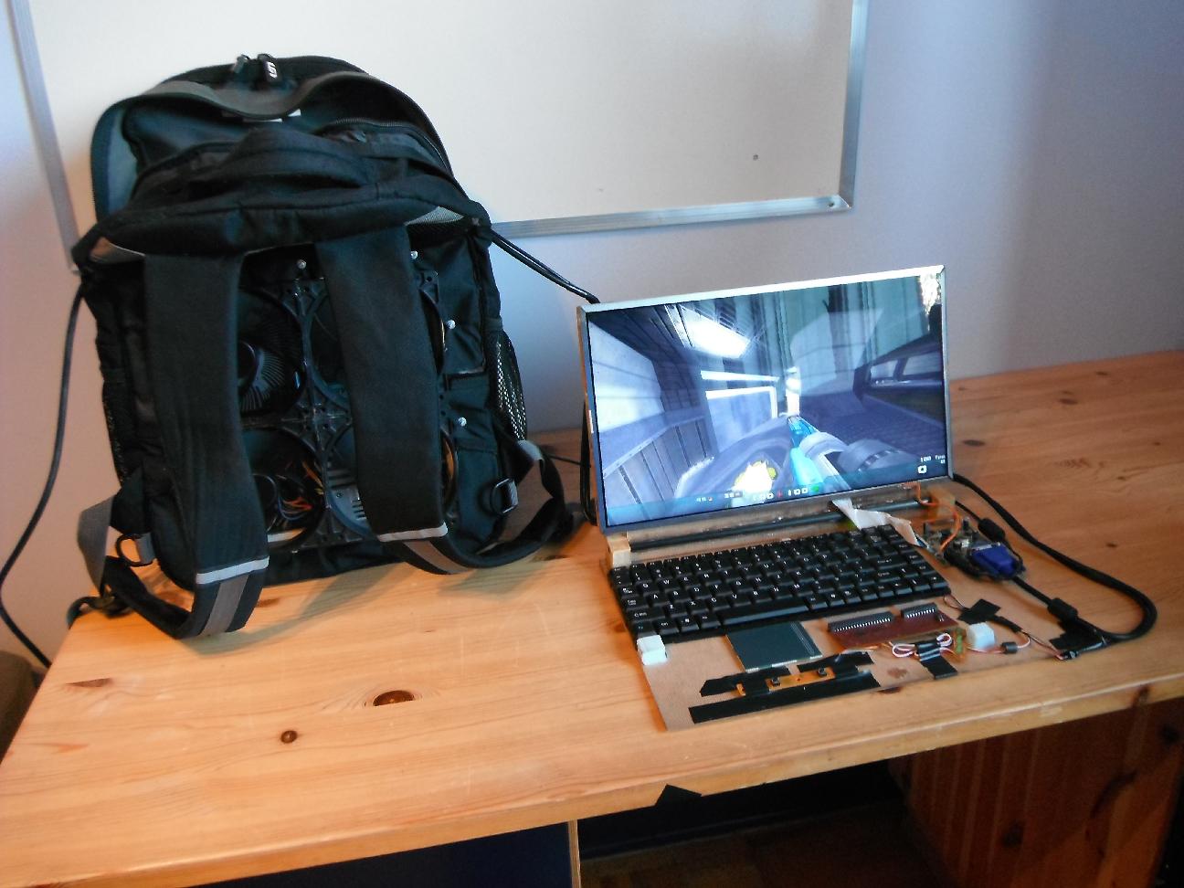

This computer Hybrid saved me 700$ had I bought a laptop equivalent in any store.
I3-3220
GTX650 (GTX 670m equivalent)
Dead silent cooling system (4x120mm silent fans)
60gb SSD and 160gb HDD
Wifi, HD screen, Keyboard, etc.
All those goodies for 600$. Its runs Nexuiz at 150fps, at ultra/maxed out.
If you need a good portable computer but you are torn apart by a tight budget, give it a try.
For those tight on money.
mikehunt042084
- Private
- Posts: 9
- Joined: Thu Oct 25, 2012 10:37 am
I need more details about that beauty, I have to have one.

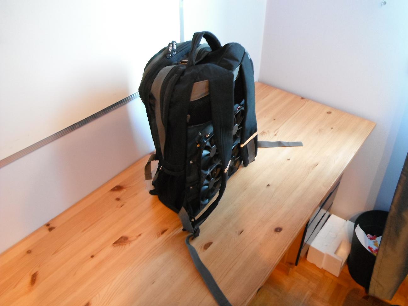

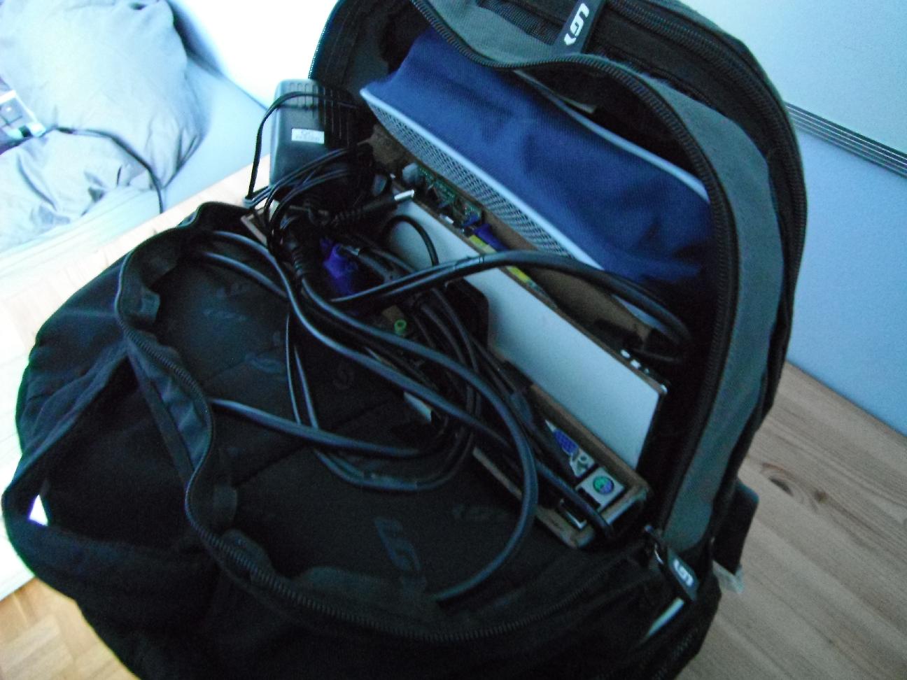

The PSU is already in there, it's a 300W one. What do you mean by SLA, Zeus ? The first box you can see in the picture with the bag open is where every single component of the computer rests. The gpu, cpu, psu and both drives. The other white panel is the screen and keyboard.
mike the design is very simple. It's a box with the motherBoard fixed on it along with the PSU and the drives. The only tricky part was to have the graphic card to lay in parallel to the motherboard. I stripped off the cooling fan and used a 10" pcie extension to have it lay flat and as close as possible to the motherboard.
Then you glue 4x 120mm fans together and have them blow air directly over the naked heatsinks of the GPU, PSU and CPU.
