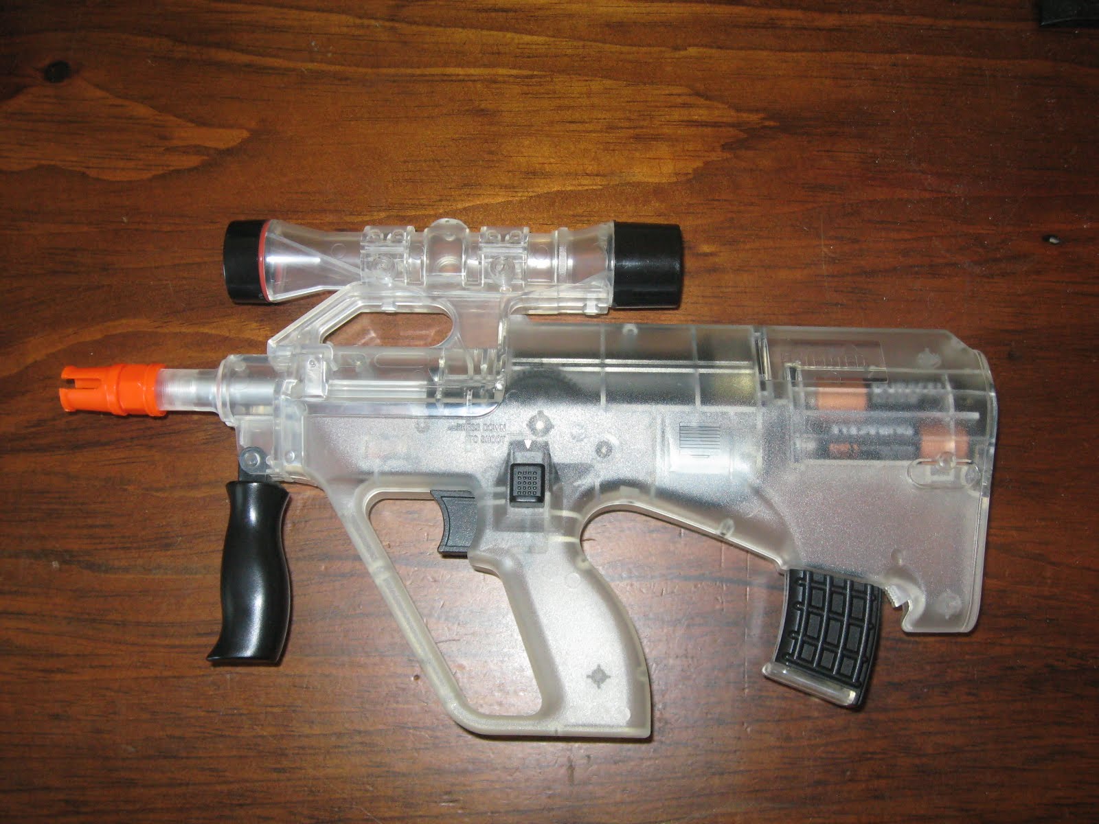

i'm currently in the middle of a conversion from airsoft to co2. I have an airsoft gun "shell" that i'm filling with my own DIY internals. I have all my bits, but am having trouble getting them to work how I want hence the need for a bit of help.
basically, i want my setup to be the same as the drozd i use to own. In the drozd, a battery powered solenoid is used to hit a button on a valve, which releases a "shot" of co2, which propels a 4.5mm bb down the barrel. I have all my bits - namely the solenoid, the valve, my barrel etc but the problem I have is that my solenoid cannot hit my valve hard enough to release the gas.

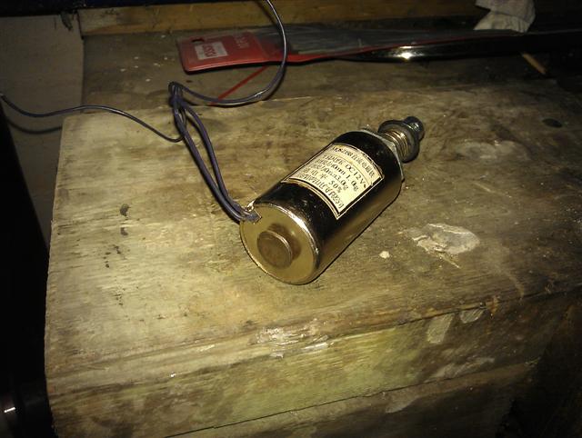

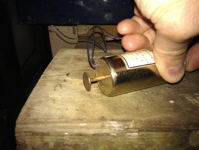

some pics of my acquired parts:
solenoid

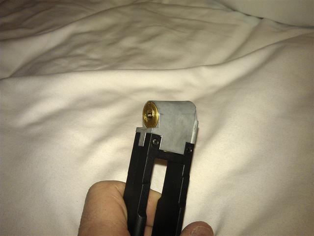

valve - taken from an umarex walther CP99 magazine

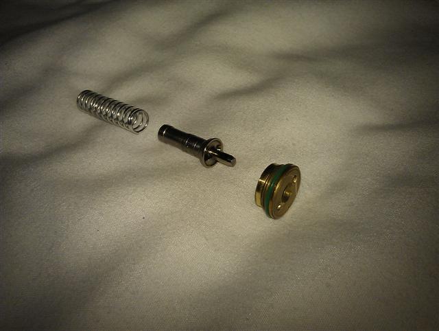

valve internals
I have my electronics sorted out, in that a trigger press makes the solenoid operate for approx 1/4 of a second (duration adjustable with a potentiometer) the solenoid is rated at 1kg at 10mm stroke, 3kg at 0mm. The solenoid is 12vDC.
how can i get this solenoid to hit this valve hard enough? I have already tried using a weaker spring inside the valve, the solenoid still wasn't able to open it and when I did it manually (pushed it with a screwdriver!!) the valve stayed open and dumped all the co2 in one shot so it was obviously too weak to close the valve. I am using 12g co2 bulbs that I believe operate at around 850PSI.
Any and all comments or help will be much appreciated, I know this can be done as it how my old drozd worked

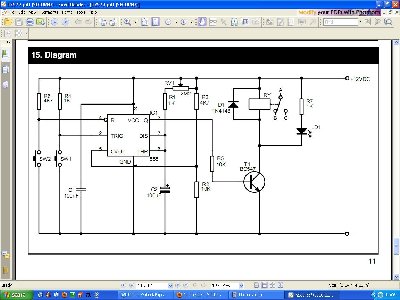

This is the Drozd circuit board. See the capacitor on the right? That discharges into the solenoid to give it its "oooomph".
Daystate airguns use a similar system: http://www.airgunsofarizona.com/Daystat ... mation.pdf

the board you have pictured is the drozd upgrade board, which gives full auto. There are a couple of reasons this is no good for my application - 1) I don't want full auto 2) full auto here is illegal (over a certain power) and carries a 5 year mandatory jail term. I appreciate you are bringing the size of the cap to my attention, but my electronics are already sorted out in that I have my PCB already soldered together.
I have read the daystate CDT literature before, and have met Tony (Belas) daystate CEO and electronic engineer on a few occasions as he is a regular guest at my rifle club. I understand the reasoning behind a large CAP in daystate applications, but their rifles are PCP and run at around 2600 PSI in non FAC form, hence the need for a hefty shunt of power to the solenoid

One thing I have noticed between the drozd solenoid and that of my solenoid is that the drozd one seems to have weight on the end of the plunger arm that strikes the solenoid? would this make a difference? I have been turning this over in my mind all day and it seems to me that the weight would act as a hammer thereby enabling the solenoid arm to hit harder? I know a few of you will now be "face-palming" and thinking jeez what a dumb-ass, but I am a complete noob at things like this. I have spent the best part of about a week reading through these forums and am coming to terms with the theory and terminology (I am currently on sick leave from my work as I have contracted pneumonia) so I am getting there slowly

That was the point I was trying to make, in order to use a solenoid as a hammer, it only needs a short burst of electrical energy, but a large one - unlike a solenoid that is used to open a door for example.spaspeckerthedull wrote:There are a couple of reasons this is no good for my application - 1) I don't want full auto 2) full auto here is illegal (over a certain power) and carries a 5 year mandatory jail term. I appreciate you are bringing the size of the cap to my attention, but my electronics are already sorted out in that I have my PCB already soldered together.
I have a FAC Mk.3 that does 28 ft/lbs, lovely bit of kitI have read the daystate CDT literature before, and have met Tony (Belas) daystate CEO and electronic engineer on a few occasions as he is a regular guest at my rifle club. I understand the reasoning behind a large CAP in daystate applications, but their rifles are PCP and run at around 2600 PSI in non FAC form, hence the need for a hefty shunt of power to the solenoid
Even though you have lower pressures and pressure areas, you still need to smack the valve, and I don't think you can do this with a low volt DC power supply without the aid of a capacitor. After all, the Drozd runs on 850 psi CO<sub>2</sub> and still needs a capacitor.

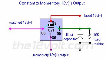

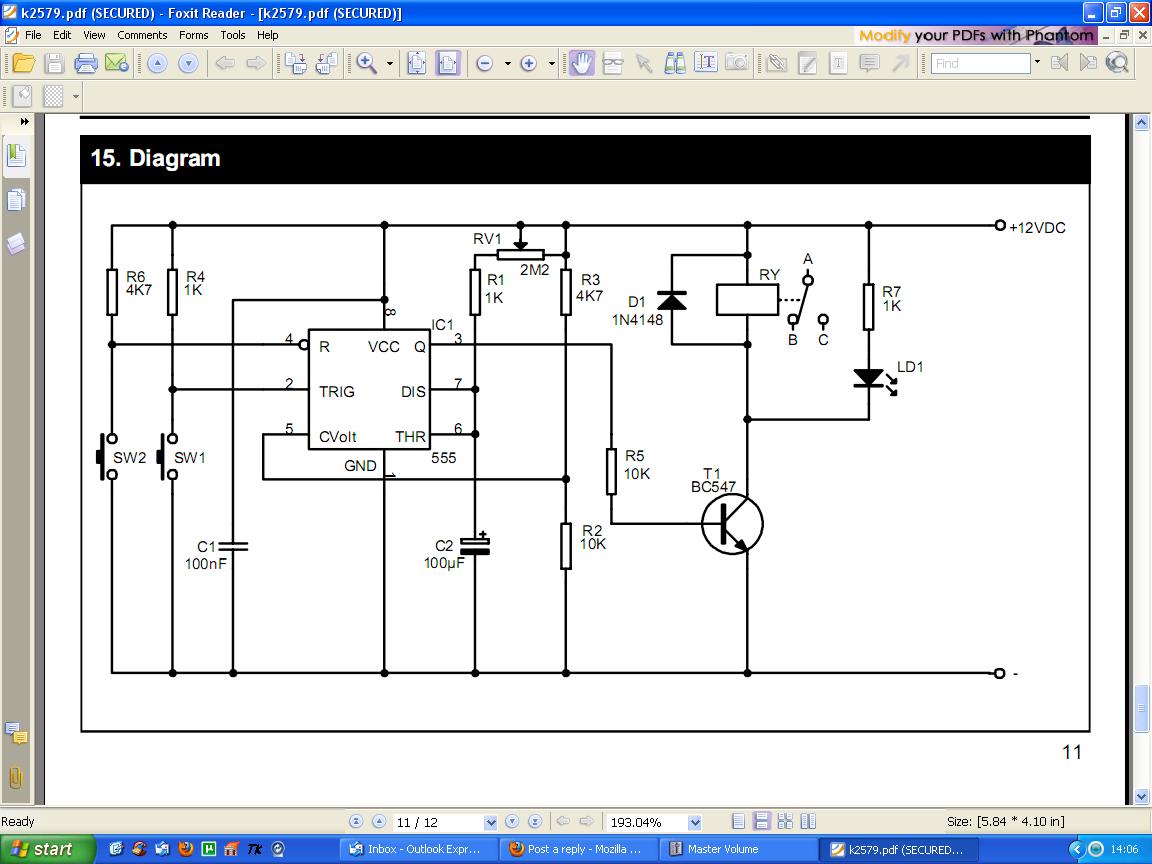

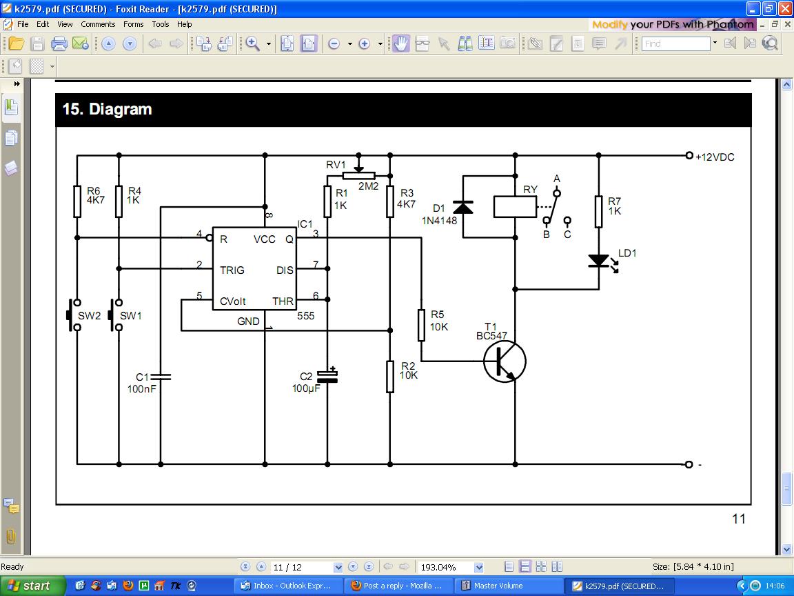

I've posted a picture of my existing circuit, just note that I changed C2 to 1µF to bring the discharge time down to a more controllable level using a pot. Is there any way I could mod this existing circuit to give me the "belt" that I need to punch this solenoid hard enough?
Also added a very simple 12v relay diagram - is there any way this could be altered to give me the same outcome?

I've tried adding weight to the plunger arm of my solenoid, and when the glue dries i'm going to try over-driving it by a couple of volts to see what happens, unless someone can come up with a sort of DIY hammer type affair for me to try?

You will need more than a couple of volts!spaspeckerthedull wrote: I've tried adding weight to the plunger arm of my solenoid, and when the glue dries i'm going to try over-driving it by a couple of volts to see what happens, unless someone can come up with a sort of DIY hammer type affair for me to try?
A 12 volt solenoid could be actuated by 24 volts in a low duty cycle.
You could get a 6 volt solenoid and use 12 volts.
More volts, simple as that.I've posted a picture of my existing circuit, just note that I changed C2 to 1µF to bring the discharge time down to a more controllable level using a pot. Is there any way I could mod this existing circuit to give me the "belt" that I need to punch this solenoid hard enough?
Stuff like a toy cap gun or an automatic staplercan be adapted as ready made hammers.
Another possibility if you want it to be electric is to hack one of these:
The spring piston becomes the hammer, also gives you the potential for full auto.

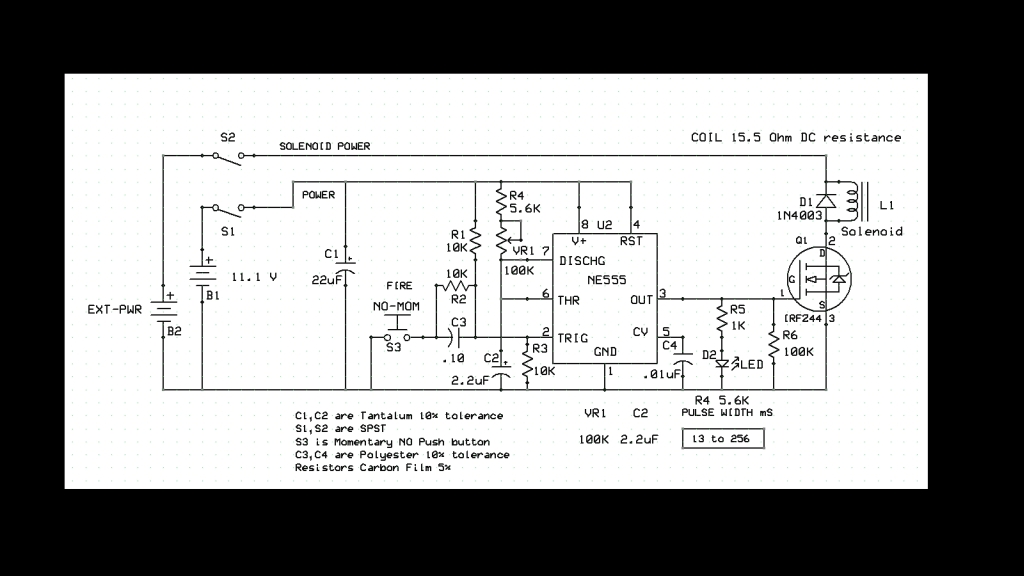

Did you look at the schematic I provided?spaspeckerthedull wrote:Also, it seems that my existing electronic setup is of no use as well, reason being the 555 timer in my circuit does not start to countdown until after I release start button/trigger. This is regardless of how the "pulse" time is trimmed using the pot, because the 555 does not activate the circuit/output relay until after the release of the start button/trigger. Not an ideal setup as I am looking for a semi-auto trigger action - one pull of the trigger, one pulse to the solenoid is what i'm after regardless of how long the trigger is held down
It will do; one pull of the trigger and one pulse to the solenoid regardless of how long the trigger is held down.
A circuit that is over 30 years old and a proven design!

I have looked at your schematic but do not know how to build it. I have a VERY limited understanding of electronics. The board I have came as a kit with all parts provided and very clear and concise instructions, ie "solder part C1 into hole 5" type of thing. Whilst I have no doubt that your design will work, unless it is available as a kit to buy with very easy instructions, it is of no use to me but I appreciate you trying to helpdewey-1 wrote:Did you look at the schematic I provided?spaspeckerthedull wrote:Also, it seems that my existing electronic setup is of no use as well, reason being the 555 timer in my circuit does not start to countdown until after I release start button/trigger. This is regardless of how the "pulse" time is trimmed using the pot, because the 555 does not activate the circuit/output relay until after the release of the start button/trigger. Not an ideal setup as I am looking for a semi-auto trigger action - one pull of the trigger, one pulse to the solenoid is what i'm after regardless of how long the trigger is held down
