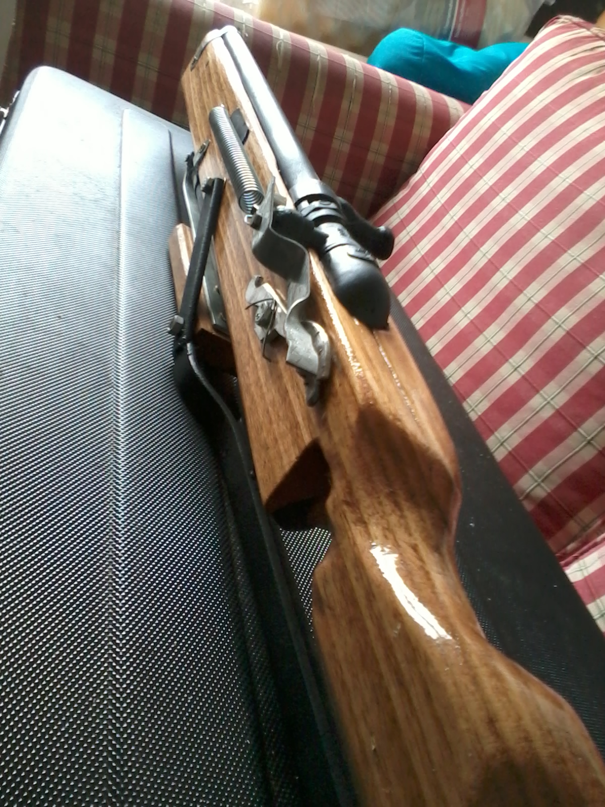

I've been dabbling here and there making pistons and valves and bits and pieces, but finnaly last week i put the effort into making a gun i can actually use.

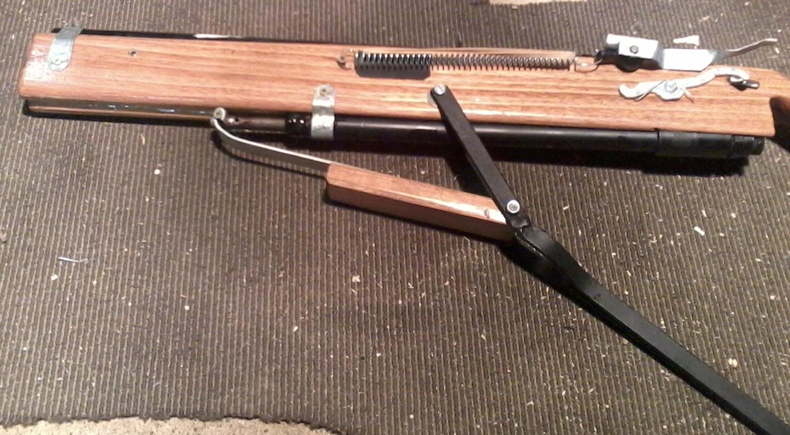

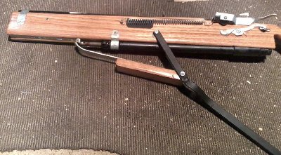

So, its a 6mm plinker, ball valve actuated, homemade check valved, single shot, on board pump, rifle.
Bits'n'pieces:

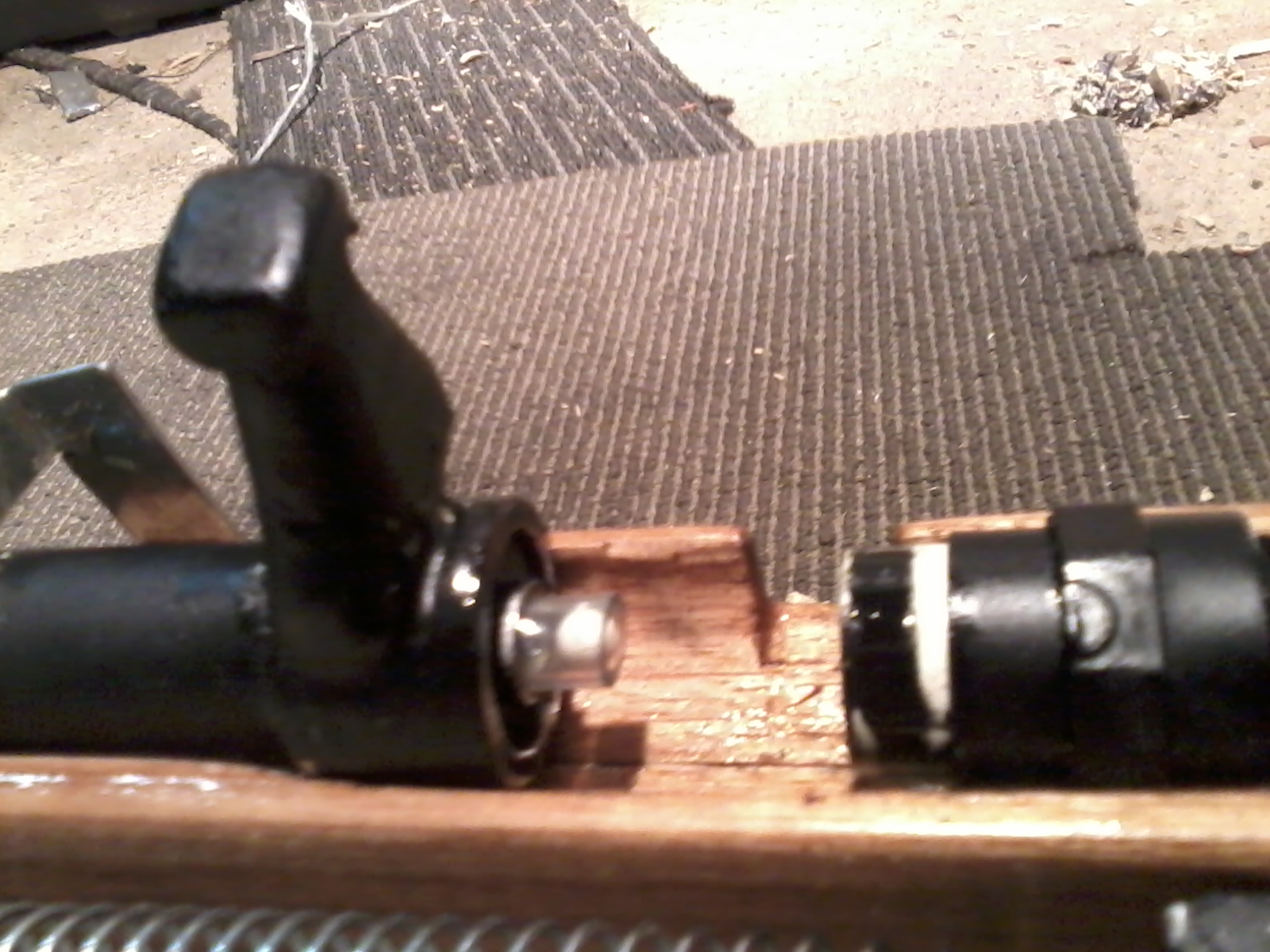

Pump: The pump is the shaft and piston end from a standard bicycle hand pump, carefully cut down to fit into a 15mm piece of PVC pipe.
Check Valve: The check valve i made by flattening 3 layers of PVC from a large diameter tube using a heat gun, then cutting them to rounds and glueing them inside the connecting fitting between the pump and the bottom tee. a hole was drilled into these flats and a shaft with o-ring from a standard hose trigger valve installed, serviceable by a threaded brass endcap.

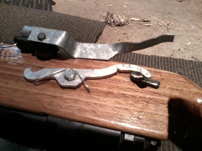

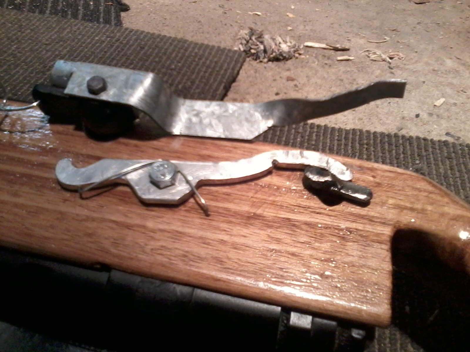

The rest: everything else is fairly self evident, i made a stock to fit, installed a lever for mechanical advantage, installed a trigger mechanism with a safe hidden trigger (which i forgot to take a picture of)
the barrel is a 6.42mm ID aluminium pipe i bought from a hobby shop. i pushed a piece of 6mm clear plastic tubing onto the end to hold bbs in position (pictured)
Done alot of shooting with it over the last few days, its impressively accurate.

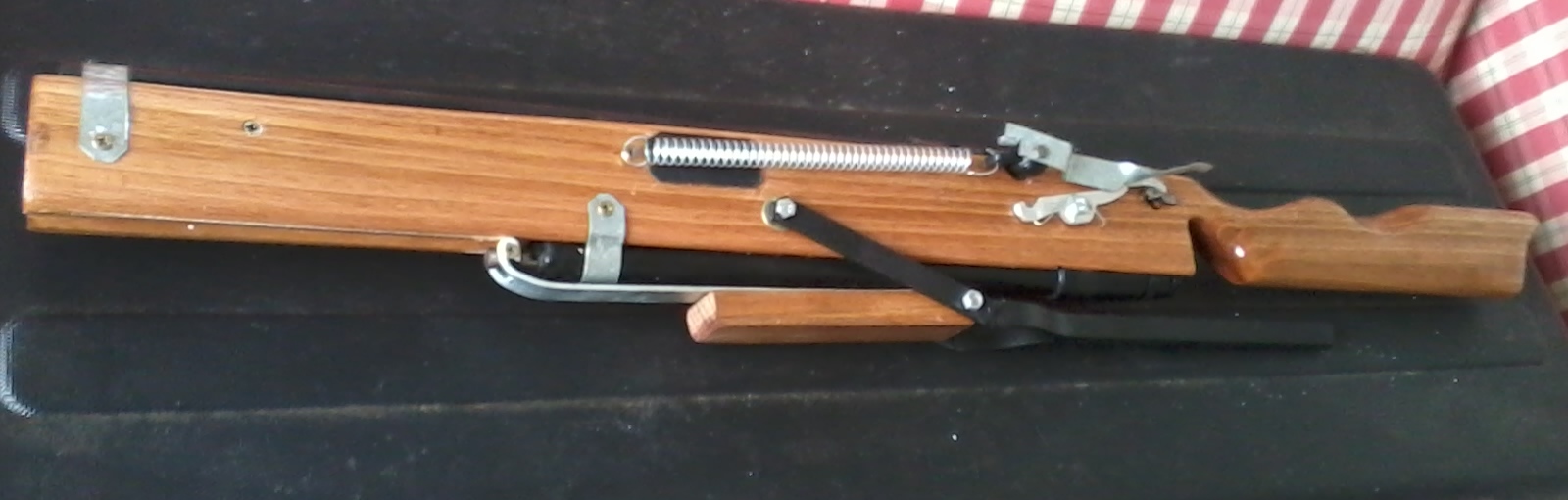

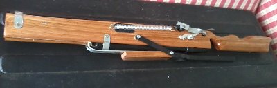

My Second gun... Same thing, neater
