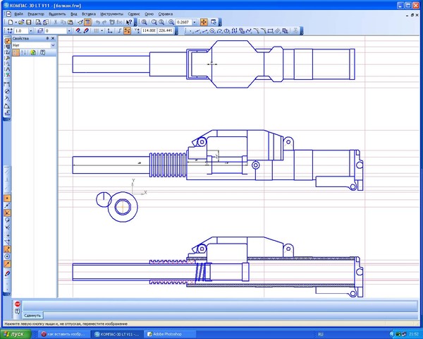

I do new airsoft launchers. I drew some designs - all sizes chose in photos. These products will have belt loading of shells. All pneumatic details at these launchers the identical.
АГС-40 "Балкан" (6Г27) (AGS-40 "Balkan" 6G27)
real
drawing

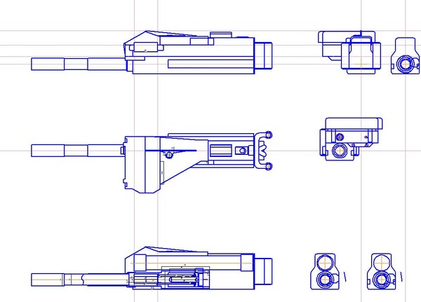

Mk 19 drawing - blow forward bolt - bad design :evil: breaks shells. I developed a new design

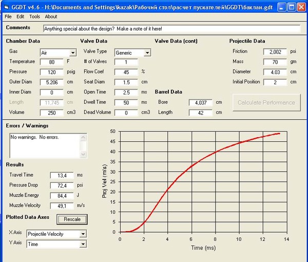

GGDT data
I will use the valve of Camozzi 1/2 inch (inside chamber)

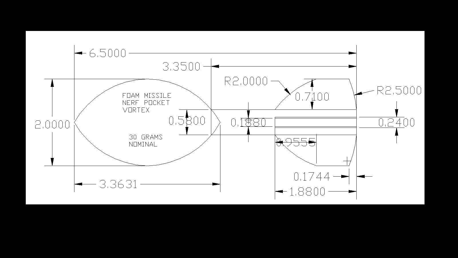

I have a question - what diameter and weight of similar Nerf Vortex Ball
Specification
Length: 34cm
Weight: 140g
http://www.ebay.com/itm/Nerf-Vortex-Aer ... 3a7b1f72c5
It will be nice to see this design in action.

dewey-1
Posts: 1298
Location: NE Wisconsin USA
The Nerf Pocket Vortex has these dimensions. (All in inches)
