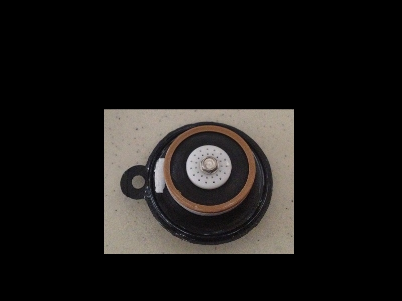

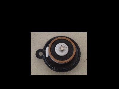

Thinking I had a defective diaphragm, I picked up another valve. I put the diaphragm in the modified valve and hooked it up, same issue.

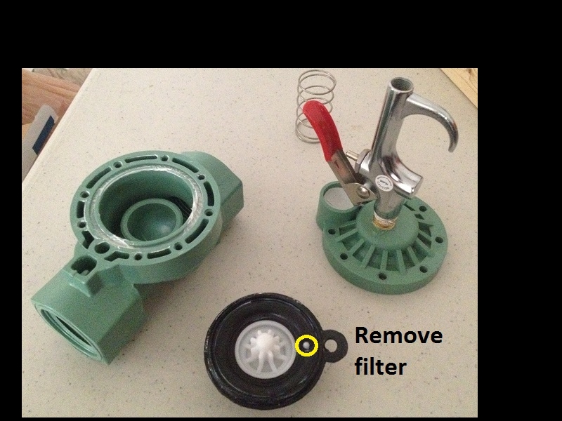

Your first picture shows a "jar top" valve.

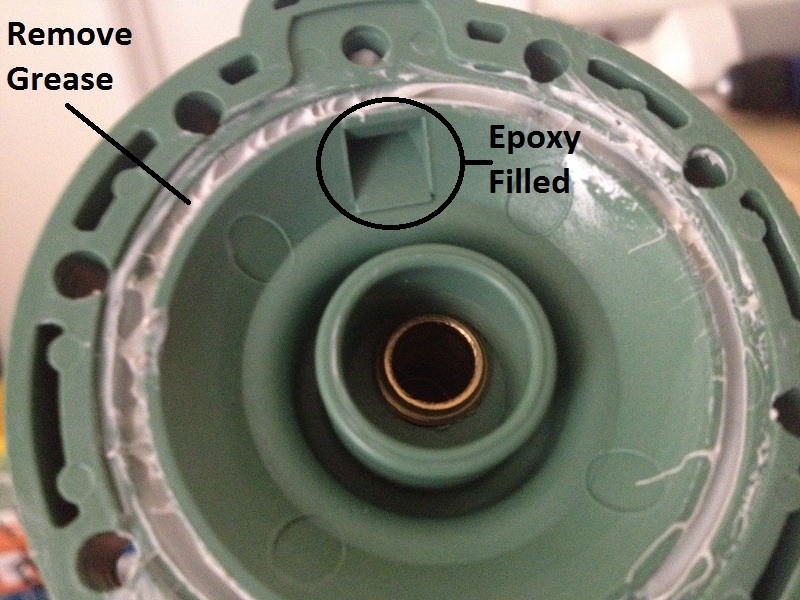

You have two different diaphragms so you must put them in the correct valve.
Remove the white filter screen as shown.
Remove all the white grease you have put on. It is not on the sealing surface of the exhaust port.

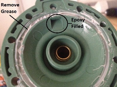

Add epoxy as shown, this will prevent leak to barrel.

D_Hall: it does seal, I don't know what that bolt is, but I removed it, thinking it was the filter described in something I read here (and the one dewey-1 points out)
dewey-1: please correct me if I am wrong, but isn't a jar top valve one where the lid screws on (like a jar)? this valve is an inline, with 8 screws securing it in place. Trying your suggestions now, but I'm not sure how the extra epoxy will help; the hole you refer to is already sealed by the epoxy in the solenoid hole

My mistake if it is inline with 8 screws. I could not tell for sure based on the cannon picture.schadenfreud wrote: dewey-1: please correct me if I am wrong, but isn't a jar top valve one where the lid screws on (like a jar)? this valve is an inline, with 8 screws securing it in place. Trying your suggestions now, but I'm not sure how the extra epoxy will help; the hole you refer to is already sealed by the epoxy in the solenoid hole
Why the different diaphragms then? Different brand or model number?
The additional epoxy is to insure that the vent to the output side is filled.
If you look carefully at the valve output side you will see the vent hole.

the short version: I may have bought a chamber sealing valve, lost the guide pin. Wanted something simple, so I just bought a barrel sealing valve (the orbit in the rest of the pics) and I'm leaving the other one to modify further when I have time to sit down and make a diaphragm and all the other things in the advanced modifications part of The Sprinkler Valve book.
I just noticed the vent hole when I was cleaning it haha.

These are the newer diaphragms for the 3/4 and 1 inch inline valves.
They changed the design of these valves slightly in the solenoid area of the lid.

I fixed the sealing problem by adding a ball valve between the chamber and the sprinkler valve (it also acts as a safety) and adding epoxy to the areas referenced by dewey-1
