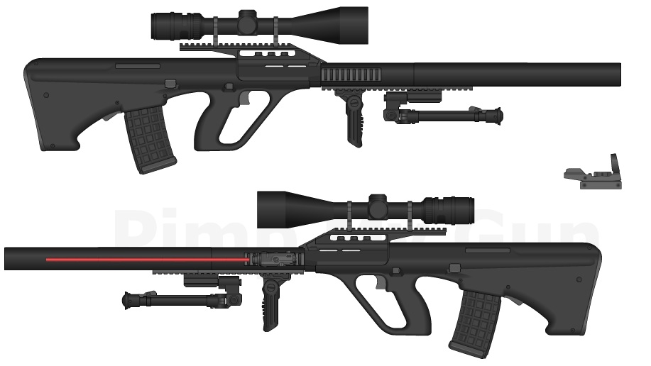

As stated before, this will be mounted into the body of a 1-1 scale Styre, though i will be making some modifications. I would like to build a DMR version of a Styre. Using the wounders of pimp my gun, this is the design i think im going to go with.
integrated suppressor (most likley not real)
Side and under barrel Rails
Folding bipod
New folding front grip
Low profile laser
Air rifle scope
45 degree offset rail with Red-Dot sight
Currently the "supressor" Is as long as the body of the steyr, i dont know if i should shorten it or leave it
