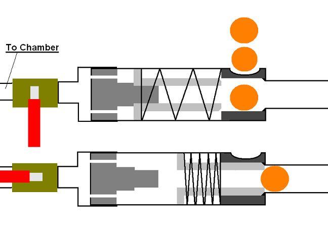

I was looking at the design used in paintballs. So I put together a blow forward design. I wondered if this could work as a full auto? If it would work maybe you could attempt to modify it to accept shells so you could use any ammo. Have them on a belt. I wanted to put a trigger system on it but couldnt figure out how to.
To Be Feared If Not Respected
A trigger would just be a High Flow pushbutton valve...
Look at the valve on the sprinkler modding tutorial, that's not a blowgun, it's a high flow air valve...
Nice design, it wold work, just not that way, the bolt woul need a seat by the ball port to keep it straight and you would have to make the thing that runs inside of the the bolt longer and cut holes in it and down the center of it, so intead of the bolt coming off of the guide to let the air out it just has to go out so far and it'll open...

It's been done.
http://www.gizmology.net/pbm.htm
Very simliar designs, eh?
EDIT: Not implying that you took his work, just commenting that they were similar in design.

Maybe it would work on a smaller calliber like bbs?

yeah does any one here no how a blowback mechanism works? I live in australia and am desperate for a semi auto kinda pistol. Even though we cant get bbs here we can use dried peas with wadding.
