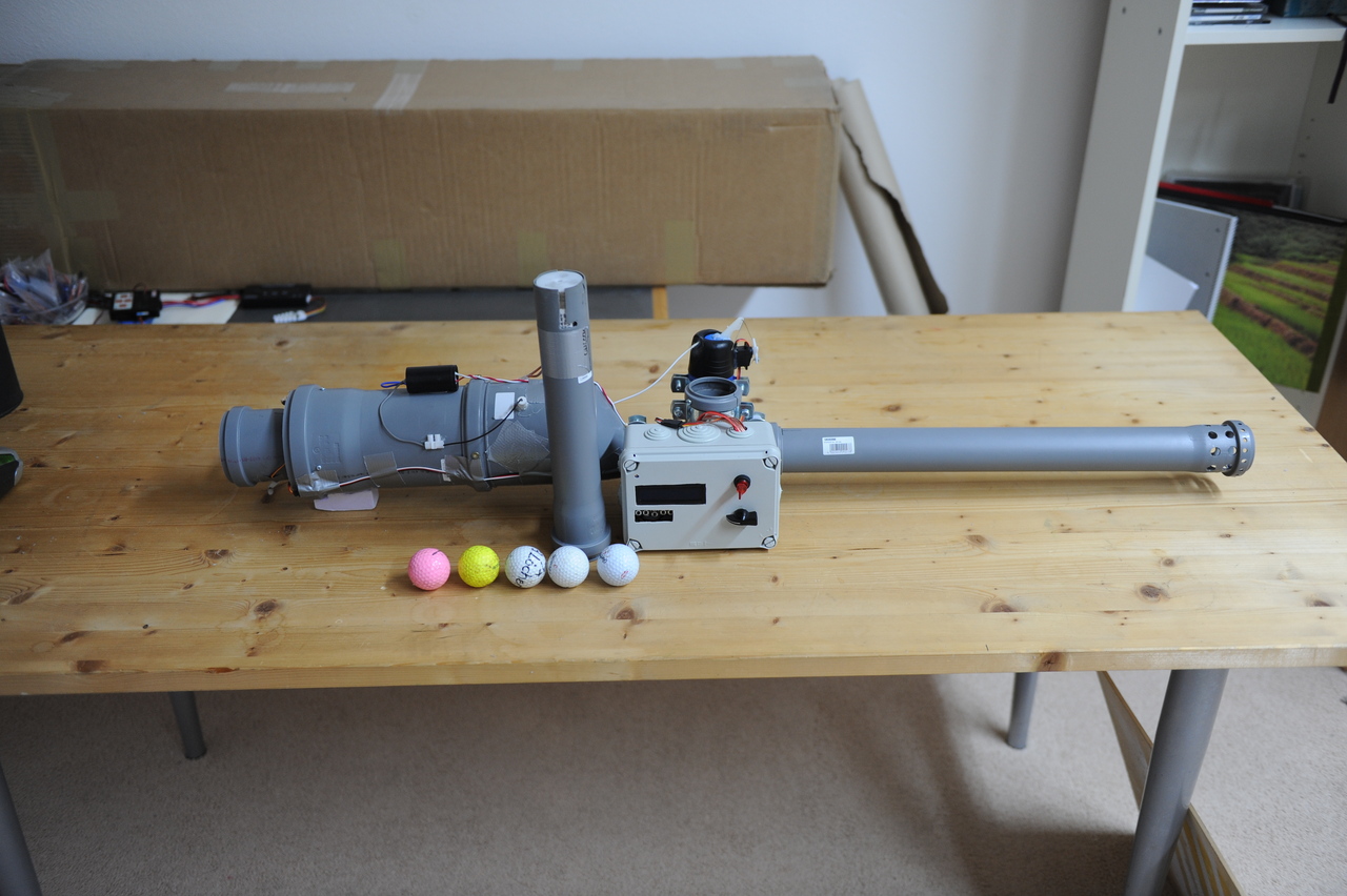

Hi,
i just wanted to share with you my first spudgun i have build.
I tried to do it "First Time Right", and not go with a simple kiddie-spudgun...
The idea was to have a full automated spudgun that is portable.
One major goal of the project was to achieve 1shot per second. Right now i achieve a cycle time of 1.2seconds, but there is room for improvement. The Loading and venting times can be reduced as is assume....
For ammunition i use golf balls. The power of the gun is, as i assume, average "low". High power was never o big goal for the project.
A typical problem found is the heat-up of the barrel. After each magazin (5shots) is empty, the temperature of the barrel is pretty high --> 50°C. The gun is constantly cooled, but this seems to be not enough for a longer fire sequences.
Overal weight is 2.5kg.
As propellant deodorant is used.
Venting system utilises a EDF.
All mechanical actions are done by Servos.
I try to upload a video of it in action later...
Fell free to tell me what you think of it....

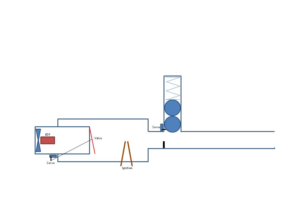

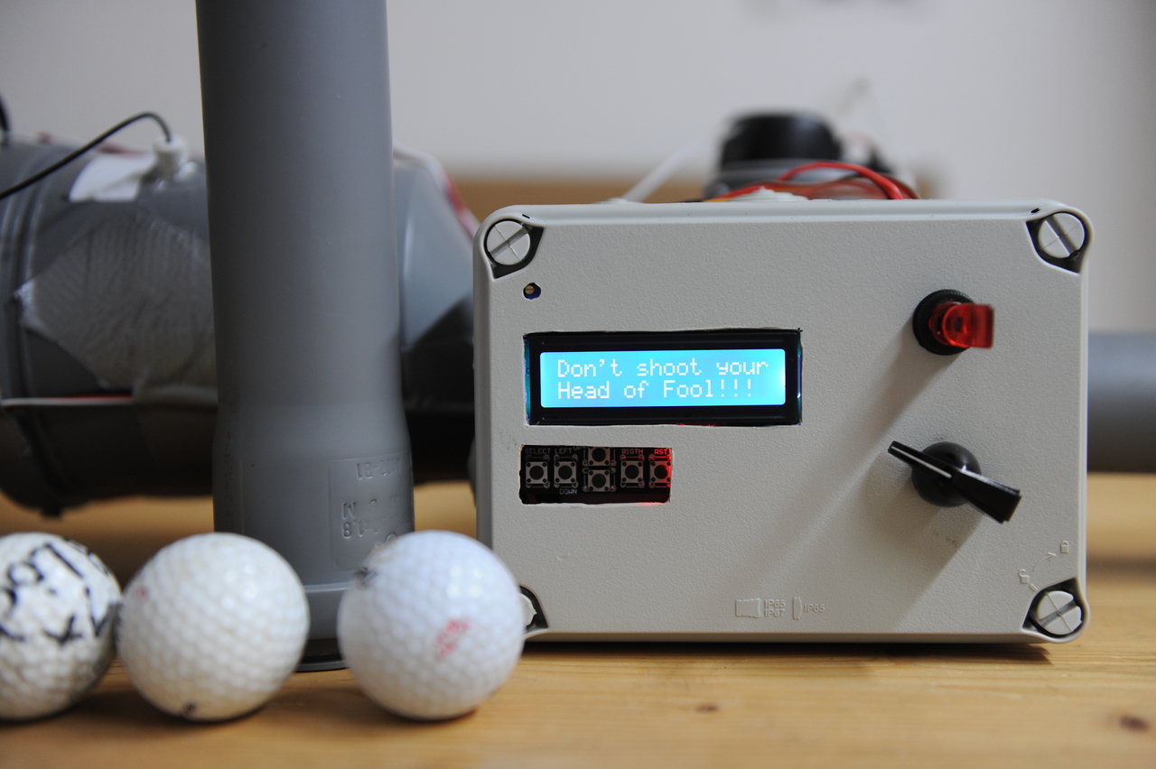

Hi,
I try to answer questions and add information whenever I find time.
The deodorant is measured by an timer. I can select the injection time in 25ms steps.
The gun is controlled by an arduino micro controller.
I can contol the ESC that controls the EDF. On top the EDF I have a valve, that is closedd by a servo. Then I have the injection-servo, and the loader-servo.
The ignition module is controlled by a relais.
The EDF is always running at low speed.
When I start the fire-sequence the controller is doing the following:
1. Close the valve
2. Open the loader to load a golf ball in the barrel.
2.a start injecting
3. Wait the given injection time
4. Start ignition
5. Open valve
6. Wait for given time
--> the edf blows all used-air through the barrel out of the gun
-------> the gun is ready for the next shot
I now have to optimize the EDF speed and the venting time to allow more than 1 shot per second.
I doubt that I will more consistent inject times with butane/propane. Maybe the bang is better, but I need way more stuff to controlled it.
Even a nearly empty deodorant can needs little adjustments on inject time. I just go from 350 to 400ms, and I can continue to fire....
The adjust man can be made from the shooting menu, and permanently stored to the EEPROM later in the programming mode...
For cooling I have a special mode, that opens the valve and blows constant fresh air in the gun. After about 1min the gun is pretty cold again.
The most useful mode is the BBQ mode!! Very handy to fire up the coal on the summer BBQ.

so, some major step forward!
The current Cycle time is not 575ms per shot!!
That 1.7Hz (shots per second!!)
I had to change parts of the magazin to metallic, and add a end-stop to the spring-plate in it.
The limiting factor for the speed of the gun is now the injection with 375ms.
Means i can completely exchange the air in the gun in 150ms!!!! And the EDF is not even working on 50% power!!
So if i really want to go faster, i would need a second injection-source (2 deodorant-cans in parralel) to remove about 170ms. That would make it then 2Hz (shots per second)!!
Concept proven, targets exceeded!!!
