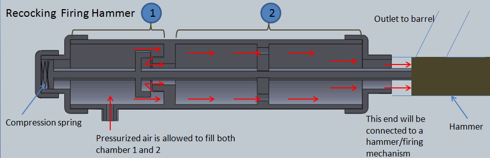

I'm kinda new to this scene and was hoping to get some advice. So here the story, I had already ordered a paintball marker from a local dealer and am really looking forward to be a paintballer. However, its taking longer then expected for my marker to arrive due to the lauzy service from my supplier. Then it hit me, why not make my own marker? So I did some research and came over this design for a pressure regulator that I think came from this forum. (I don't remember whose design is this but if you know, please inform me so that I may approach the person)

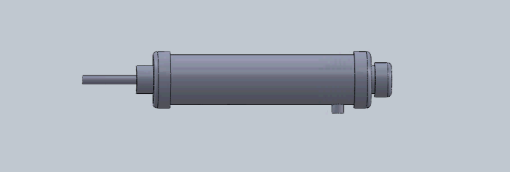

I made a model of it on SolidWorks and made a few tweaks. There are no actual dimensions yet but I'm hoping to change that in the near future. So the question I would like to ask is, if this design would work like a sprinkler valve? and how do I determine what dimensions to use so that I can contain the air pressure without catastrophic failure? Do have a look and if there is any advice or inquiries, please don't hesitate.

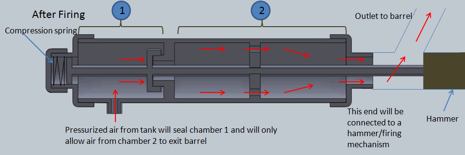

Thanks for the info guys. But I think I made a mistake when I said "pressure regulator". What I'm aiming to design is a mechanism that would create bursts of air each time the trigger is pulled and not a constant stream of air. The purpose is to create a sudden burst of air going to the barrel to push the projectile out of the barrel.
Btw, I've seen the qev valves that are available on the market only on the Internet and have never gotten a close up and personal. I was wondering if this mechanism would work similar to it or simply getting a factory made qev valve would be much easier?
