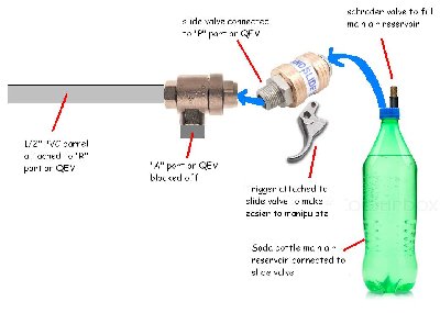

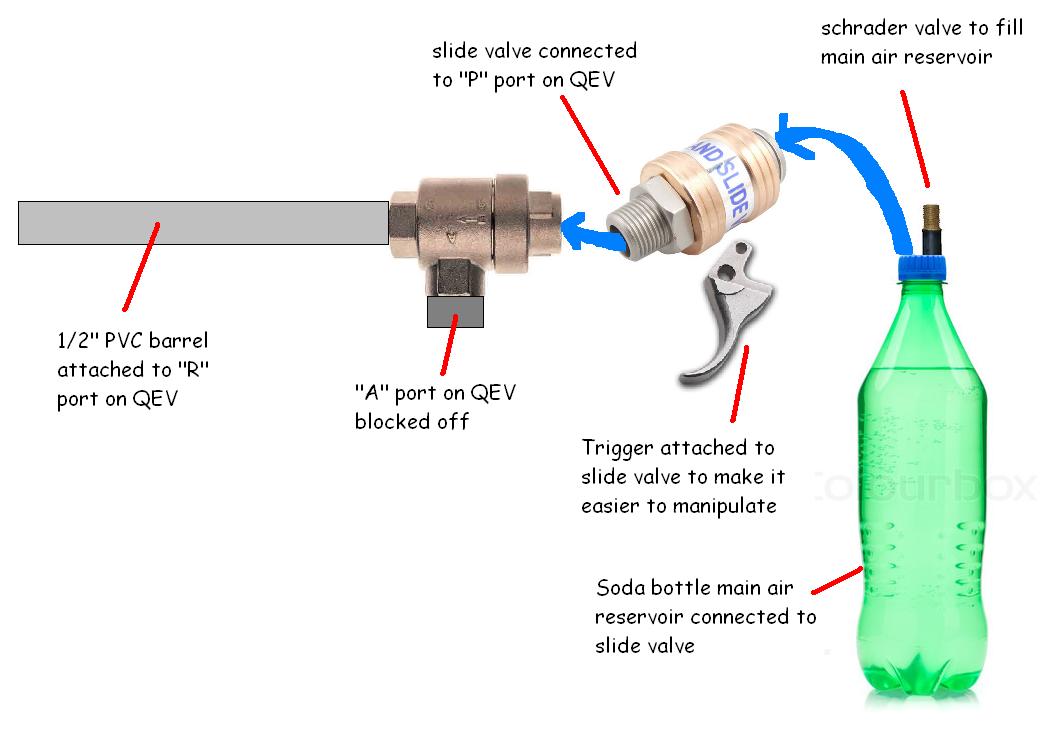

Here's how I would make it with limited tools and budget. Since Nerf darts are so light and only need a short burst of air, I would not bother with a secondary chamber - just block off the QEV "A" port and let the internal volume of the QEV act as this chamber.
Every time you manipulate the slide valve, the small amount of air in the QEV is released, firing the Nerf dart. At the same time, the main supply from the bottle is closed. When the slide valve is returned to the rest position, the QEV chamber refills and it is ready for the next shot.
Also, I drew a soda bottle as the main supply but it would be preferable to use a PVC chamber.
I understand it for the most part. So the chamber is esseguys lly the air reservoir which can be made out of PVC? The actuatiostores e will be a slide valve instead of a blow gun.
How is the pressure regulated though?
How big should the chamber/reservoir be? Or should i make multiple?
Still use a hand pump to fill the rreservoir or would a quick connect work better?
Where are slide valves and QEVs sold in stores?

Jack I've never used a slide valve, but the first link you introduced PVC Arsenal's gun, has a male quick connect on the back of a slide valve. I thought slide valves functioned as a tube which can let pressure out of it's side? Is there a hidden check valve between the quick connect and slide valve?? I'm intrigued!jackssmirkingrevenge wrote:You probably want something like this: http://www.spudfiles.com/forums/simple- ... 24849.html
QEVs are dirt cheap online: http://www.spudfiles.com/forums/semi-au ... 23626.html
Since NERF darts need so little air per shot, you could probably realistically make a semi auto without the need for a high pressure air reservoir.
That looks more like a schrader to me to be honest. In any case, if there is no check valve there the launcher will simply empty as soon as you disconnect the air source.RBurke83 wrote:Is there a hidden check valve between the quick connect and slide valve?? I'm intrigued!
There is no regulation, but because the firing chamber is so small in relation to the main chamber, power drop for a good number of shots should be negligible.How is the pressure regulated though?
I would say around 2 litres is more than enough, not too big to get to decent pressure and not too bulky but enough for a good number of shots before it needs to be refilled.How big should the chamber/reservoir be? Or should i make multiple?
