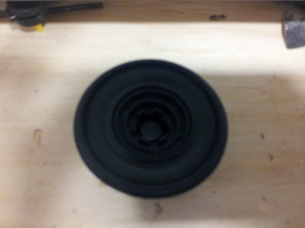

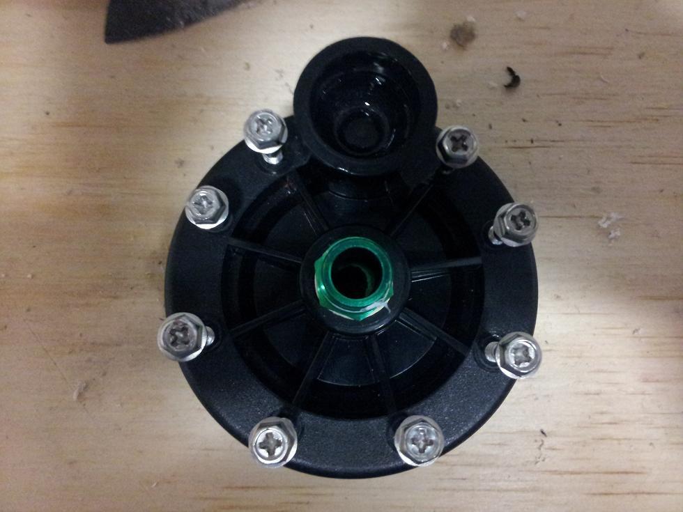

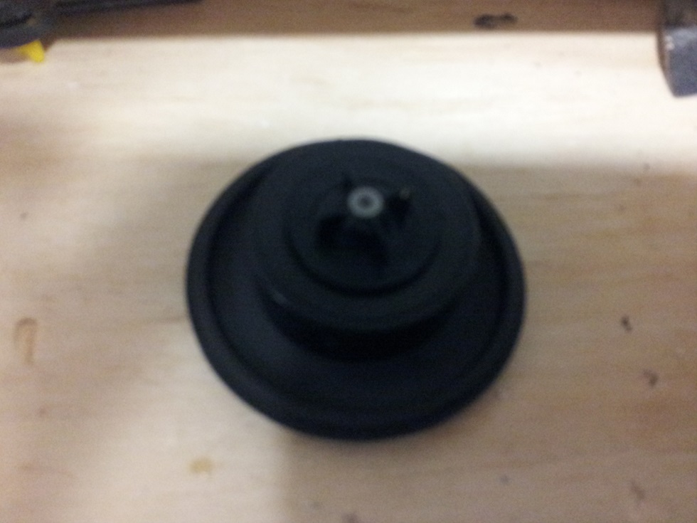

Hey everyone i have recently started to build my first pneumatic spud gun as i have only ever built propane ones before. I purchased a solenoid sprinkler valve and have epoxied the solenoid cavity and attached a blow gun with a brass nipple as a guide on you tube suggested. The problem i have is that air still flows out of the barrel not quickly but at a noticeable pace also the blow gun does not increase the air flow when triggered. i was reading so threads about how a bigger equalizing hole would help but i don't think mine even has one. what should i do should i poke a pin through the diaphragm? to crate one?

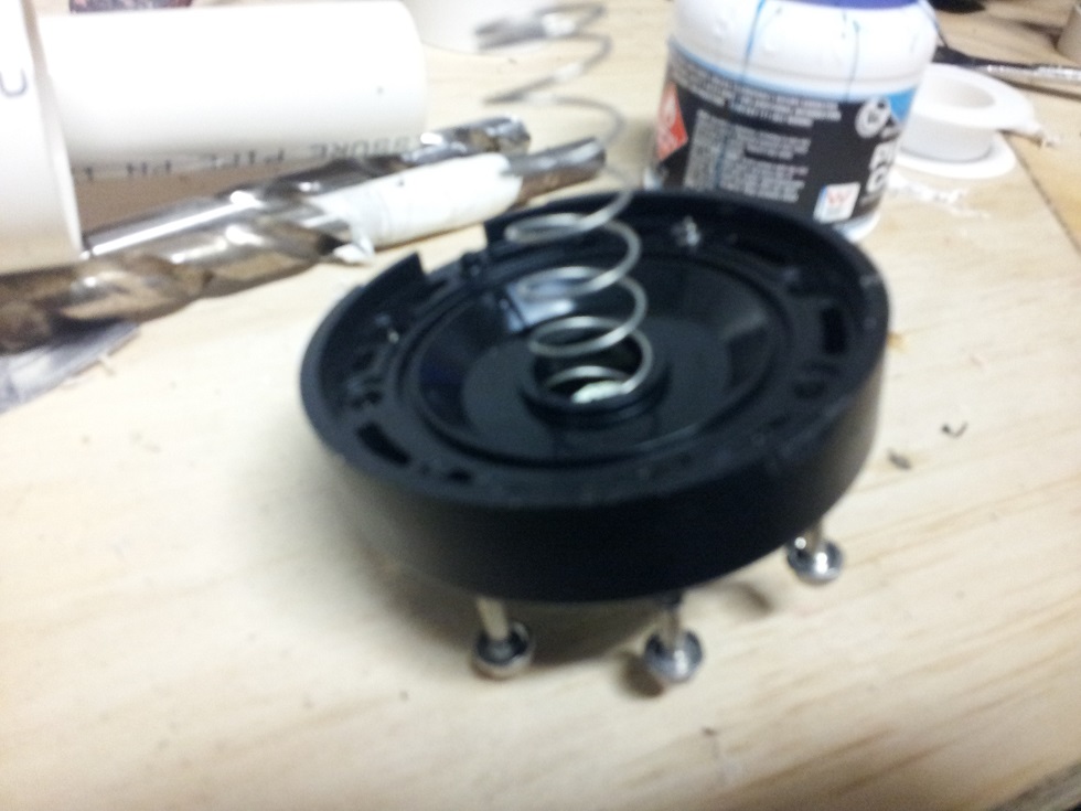

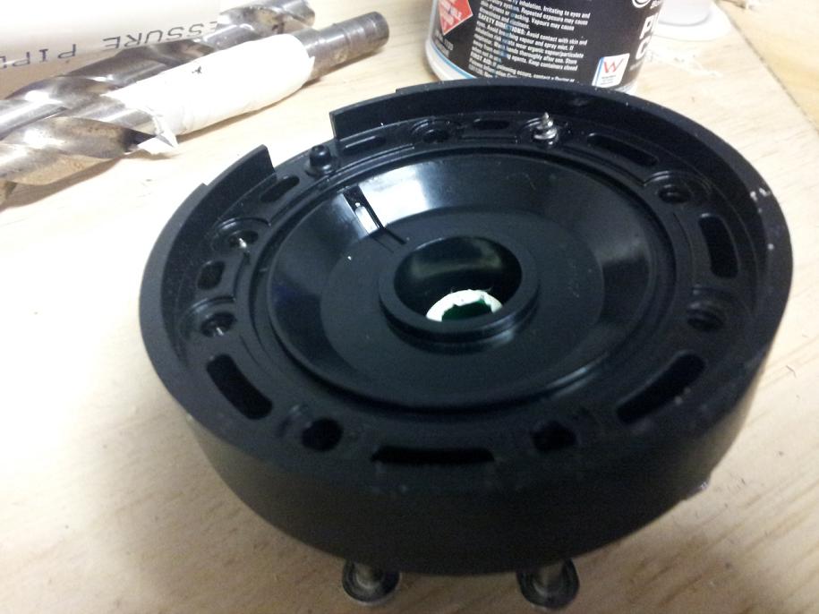

Also need pictures of spring location and diaphragm which may help.

I'm using a compreser and I have tryed a hand pump. If I think I know how these work, shouldnt the area above the diaphragm be the same pressure as the air tank? If so I don't think its happening in this valve is the diaphragm is completely air tight. Even when I block the barrel side and open the blow gun no air comes out. Could it be that with no air going in above the diaphragm that it is a lower pressure there already and the diapgram moves slightly up allowing small air flow??

Is there a hole in the center of the diaphragm with a screen in it?
Yes, drill out that epoxy with about a 2.0mm drill,
You need an equalization hole.
Hey everyone sorry to bump the thead but i kinda have it working. I drilled out the epoxy and it works well at 30-35 psi i have a resonbly small tank just the stock. I have pressued it to 120 psi however the valve does not fire correctly. It kinda just vibrates and makes a honk noise and the projectile will just fall out the end of the barrel.any ideas on how to fix? Is the equalization hole to big its 1mm atm
