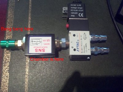

I have an SNS QE04 Quick Exhaust Valve, 1/2" type.
I have an Airtac 3V201-08 NC (note normally closed, not normally open)
This is it here
So....
On the QEV I have chamber on A, breech on R and fill from P pilot.
All as per standard operating procedure.
Is it possible to rig these two valve together such that the QEV will fill the chamber from my compressor and that powering the solenoid will act as the pilot ?

Well dang it, it don't work.
1.
Air line into NC port.
Trip solenoid
NC port opens and feeds QEV
Chamber fills just like it should
Release solenoid
NC path is closed, pilot vents through the NO exhaust
Chamber dumps out the R port just like it should
2.
Airline into NO port
Chamber fills
Trip solenoid, expecting pilot to exhaust
Instead I get this
Retries hurt from pneumatic field of battle.....................
I can change my plans and add a fill/prime circuit to the microcontroller that runs all this, then have code wrapped around the fire button that recycles the priming, but FFS it can't be this hard.

Hmmm... Lets go back to basics. I might have given misleading instructions earlier on.
The solenoid valve has three ports, A, P and R
Circuit open, if you blow into A, it should come out of R
Circuit closed, if you blow into A, it should come out of P
Is this the case?
If so, A should be connected to the QEV pilot port.
R should be connected to the compressor output.
P should be left open to the atmosphere.
Is this the case?
- Technician1002
- Posts: 5189
Flame wars are against the rules.. I don't do that.Have mercy on me Wyz and Jack & Tech and everyone else who will flame me for this, but I am f#$^&*! if I can find the right post to answer this.
Three ports A, P, R, on each bit of kit.
QEV A is chamber
QEV R is breech block
QEV P is fill side
Solenoid R is compressor
Solenoid A is fill side going to pilot of the QEV
Solenoid P is vented
Chamber fills, evilvet trips solenoid, nothing happens, evilvet considers the merits of tall buildings in the CBD with a high powered rifle.............
If I do it the other way and fill from Solenoid P it works like i said, just requires that extra step to prime then fire on loss of power to the coil.
QEV A is chamber
QEV P is fill side
