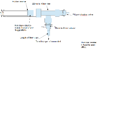

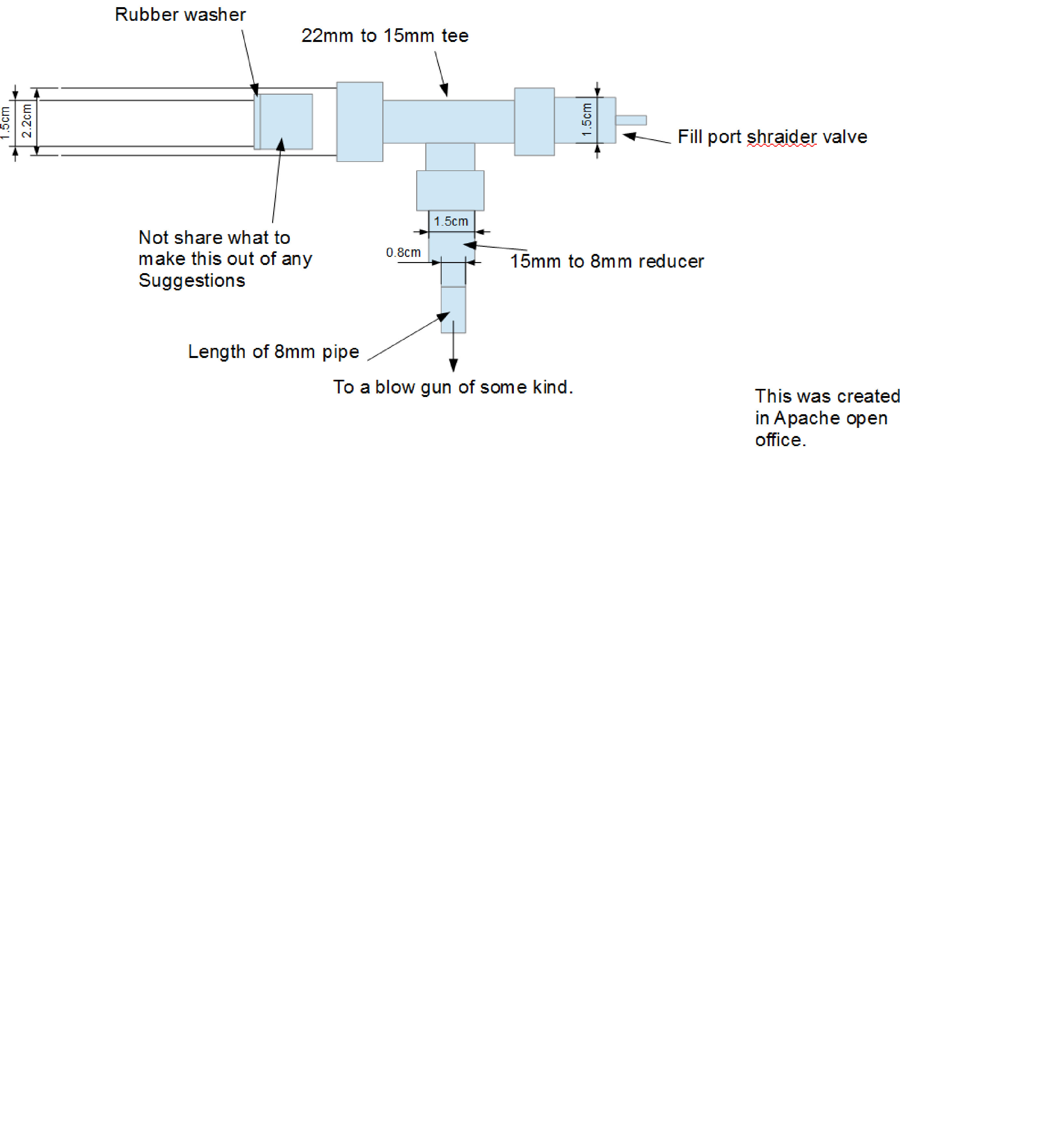

I have been thinking about making a airgun/combustion rifle but still cant decide what to do all my attempts making a pneumatic air gun have resulted in having no stock. I did make a small butane/propane powered rifle but after one or two shots it became boring. normally resulting in me taking off the barrel and using it as a blow gun. then i saw a coaxial air gun. i still cant get my head round it properly but this is what i have got so far. any advise, links would be really helpful. not looking for something advanced or flashy but something simple. easy to make.

So, where exactly is your ball valve?

@ turkey...why does he need a ball valve??
Hawk, on the right track with that.
Piston needs to be a VERY close fit. Can be made from a piece of wood dowel, or really...anything cylinder shaped and appropriately sized.
Another good option is cast epoxy.
http://www.spudfiles.com/forums/making- ... t8919.html
There are several very good examples of coax "rifles" in the pneumatic showcase section.

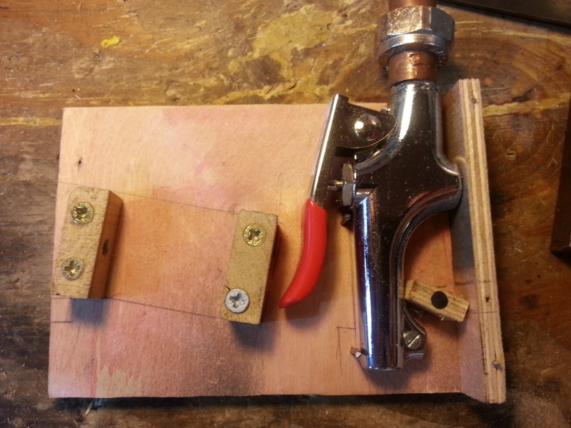

I started this weekend just gone making the housing and push rod guides for the trigger and I also bodged up a 1/4" bsp - 15mm bit of copper pipe so when I get the compression fitting it will fit nice and air tight.
I've never used epoxy before so it was fun to learn
Apart from glue it how can I make it really air tight I've had bad experience with compression fittings as they leek where the olive isn't tight enough against the fitting and locking nut when the thread has been over tightened (not by me that I suppose is what u get when you take the fittings out of the scrap pile at my old college lol)..... Any tried and tested methods plz ?

While some people will tell you that compression fittings need goopy stuff in them to seal them, it's not necessary.
Get them finger tight, then add half a turn with a wrench (less if a really large size, more if a really small one). Tighten it a bit more if that's not proving air/water tight.

I used to tighten them finger tight but didn't really help, tightening them further and too far they make this horrible grinding cutting noise but I could use some sort of sealant that will break when I dismantle it for service.
Any particular type of sealant?
