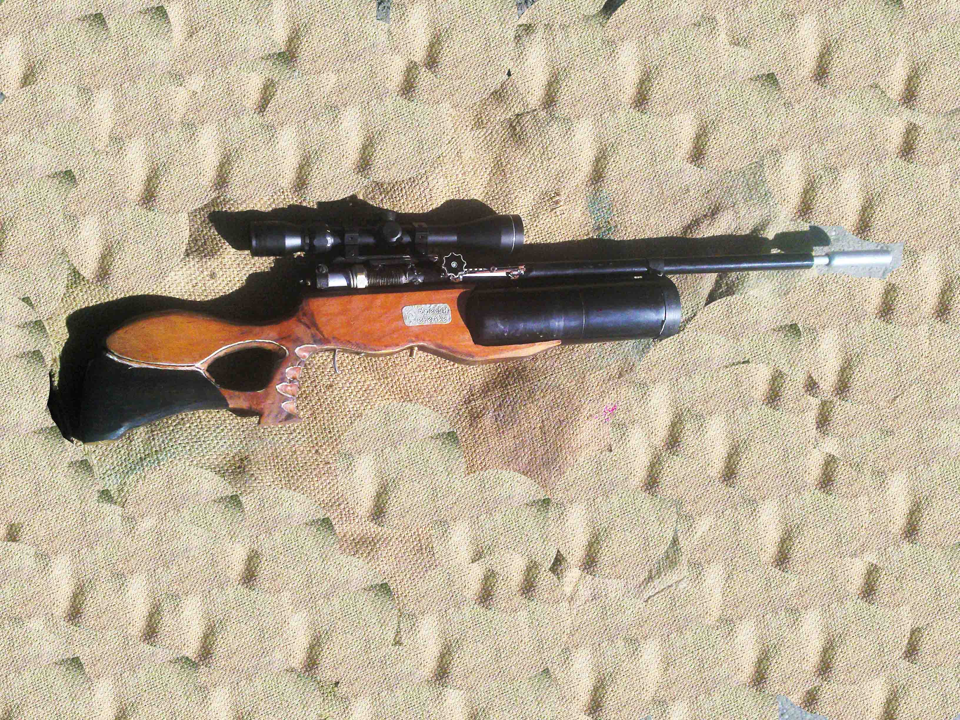

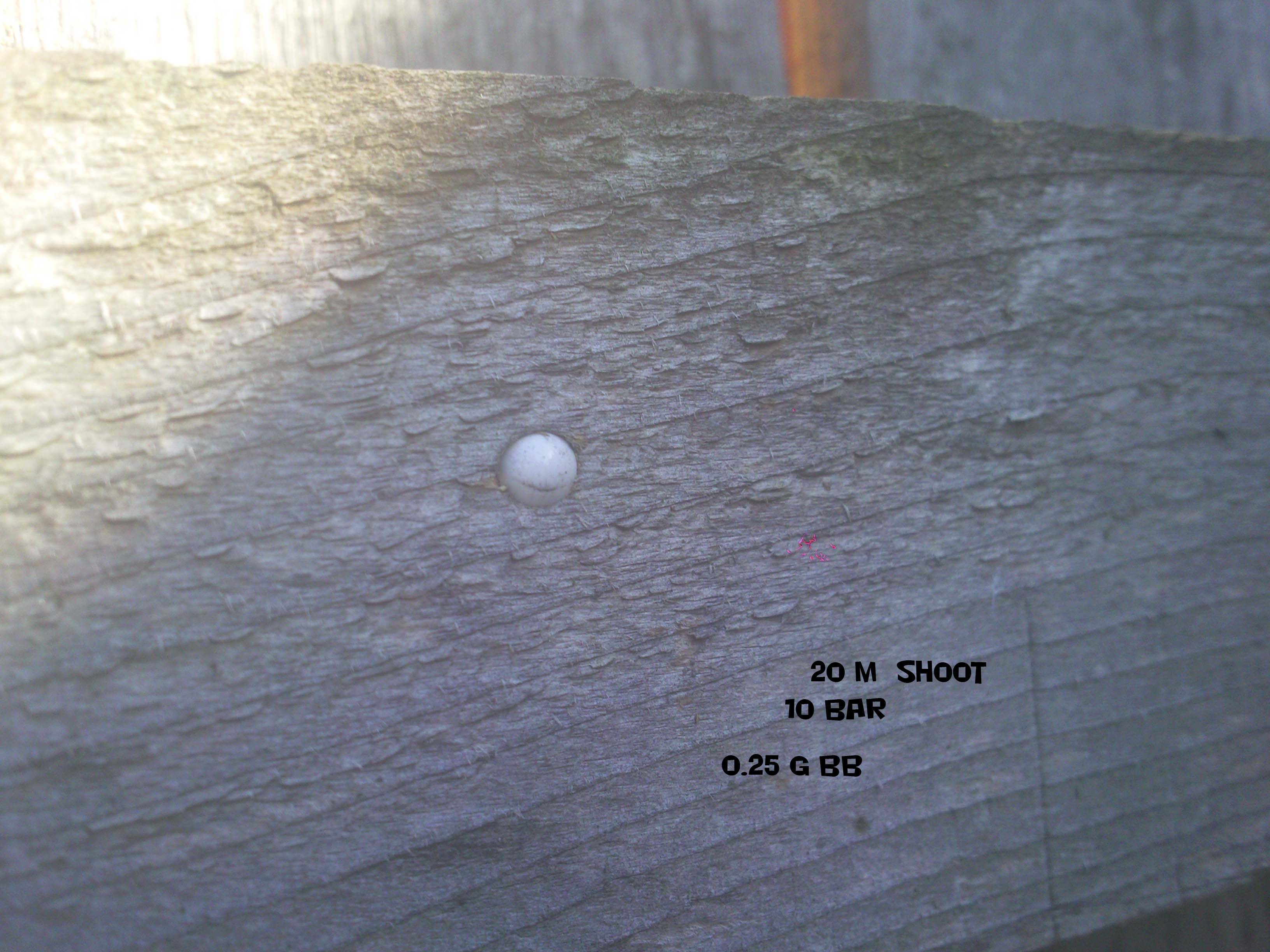

yes, it has but in the video i only charged it with 15 bar and it was set for low power(i increased the shoot sound with the video editor). i was surprised to find out what a small plastic bb can do while i was testing to build it.django wrote:Nice work!!, looks to have good power too

in the vid i shoot by 12 m, but i had test it to 20 and i knock down a small d.bravootome wrote:6 mm multishoot qev finaly finished

it depends of how i set the power and how much i fill it. i usually put 17-18 bar and shoot 25- or less bb's. i can fill it to 30 bar and i get 50 or less shoots. I didn't actually count the number of shoots . I set it to obtain full accuracy and power for a 0.25 g bb.mako wrote:Very nice. This is quite a nice 6mm build. How many shots do you get with one airtank?

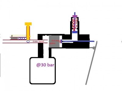

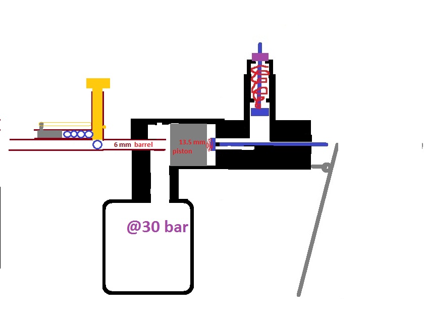

- Brian the brain
- Posts: 3497
- Location: Holland
- Been thanked: 7 times

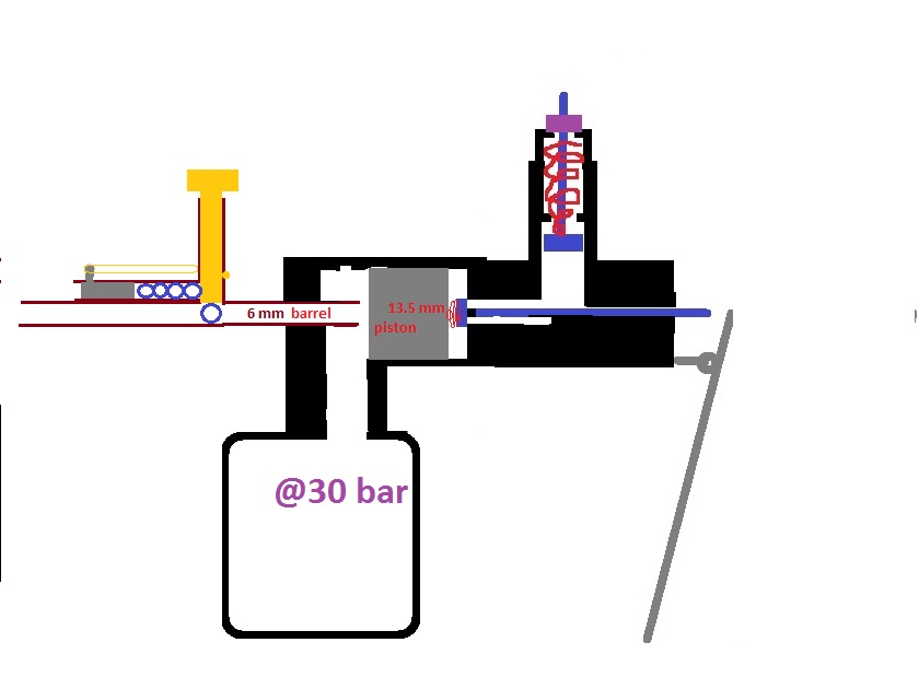

Wow..Would you be so kind as to explain your pilotvalve to us?
It seems to work perfectly!
Oh..Have you looked at blow-forward valves?
That would give you perfect semi-auto!
Auto-laoding a bb each shot with the valve set-up you already have is like the Holy Grail to a lot of members...
