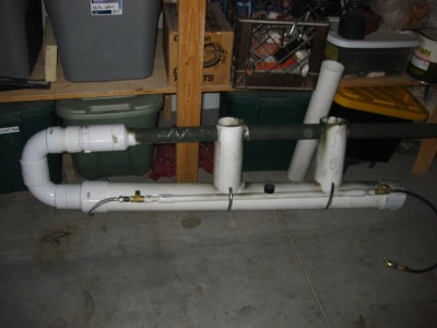

LOL already done. Here are some pics.

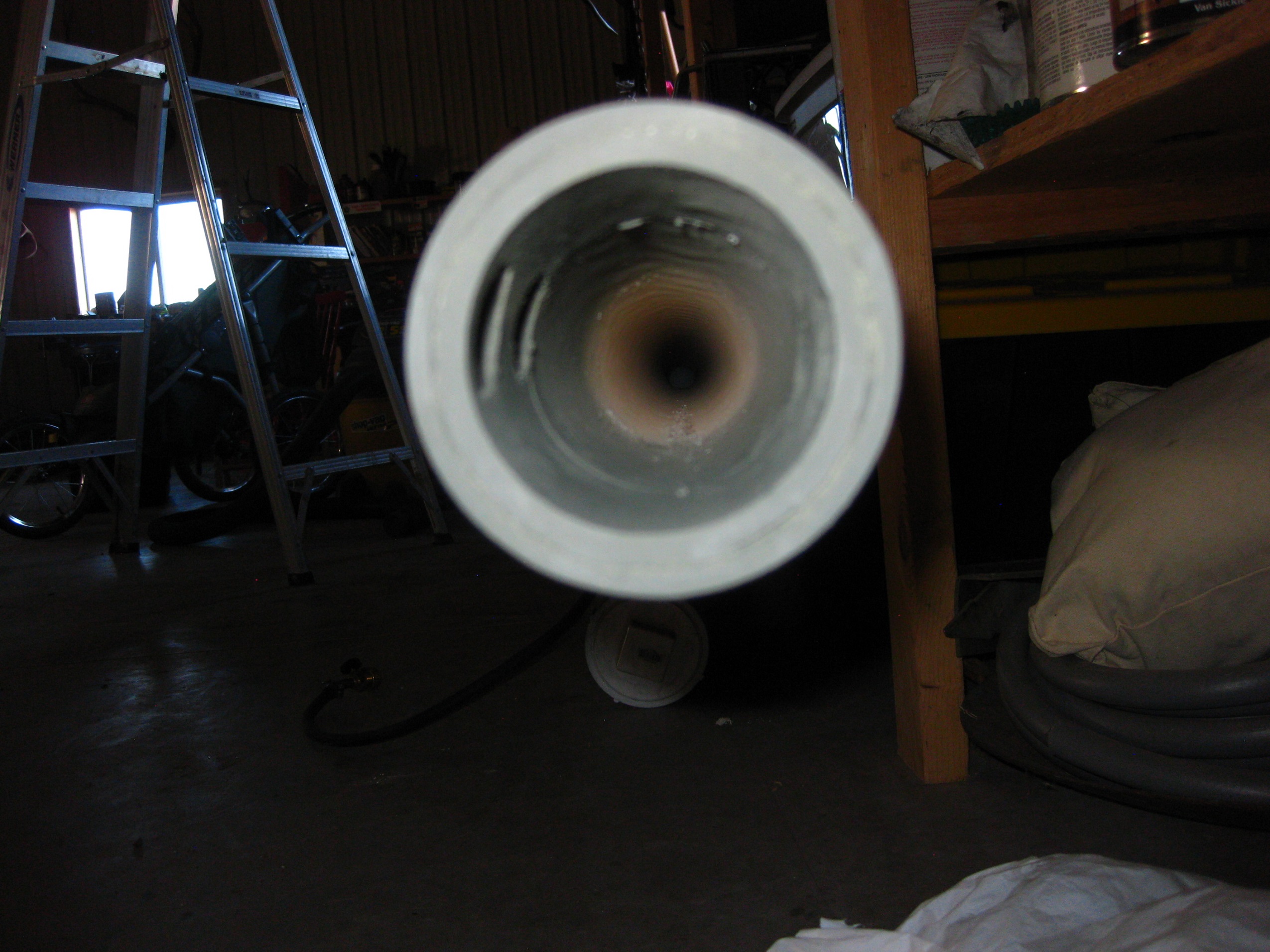

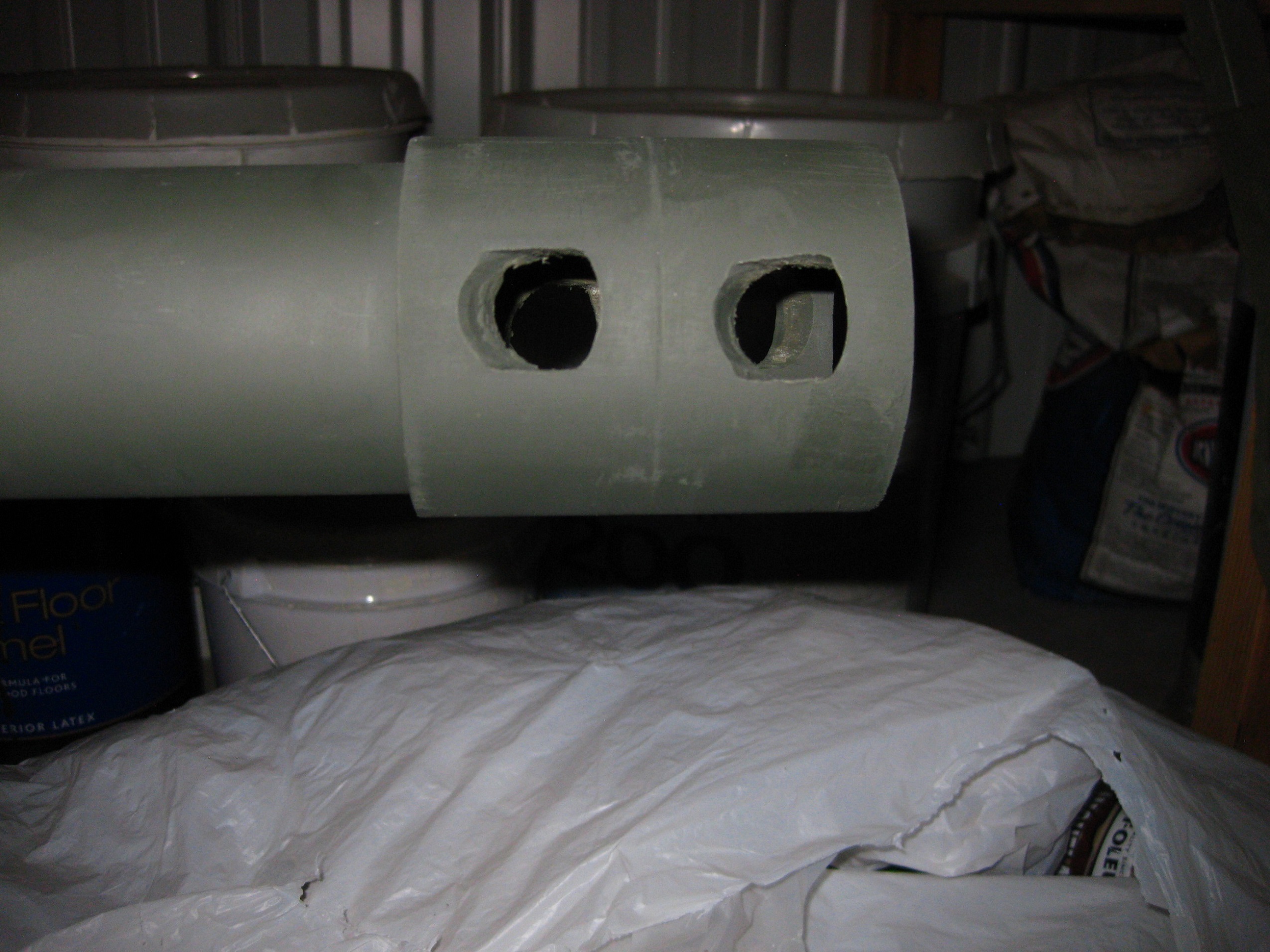

Muzzle BRAKE.
YOU WANT A PIECE OF THIS!?!?!?

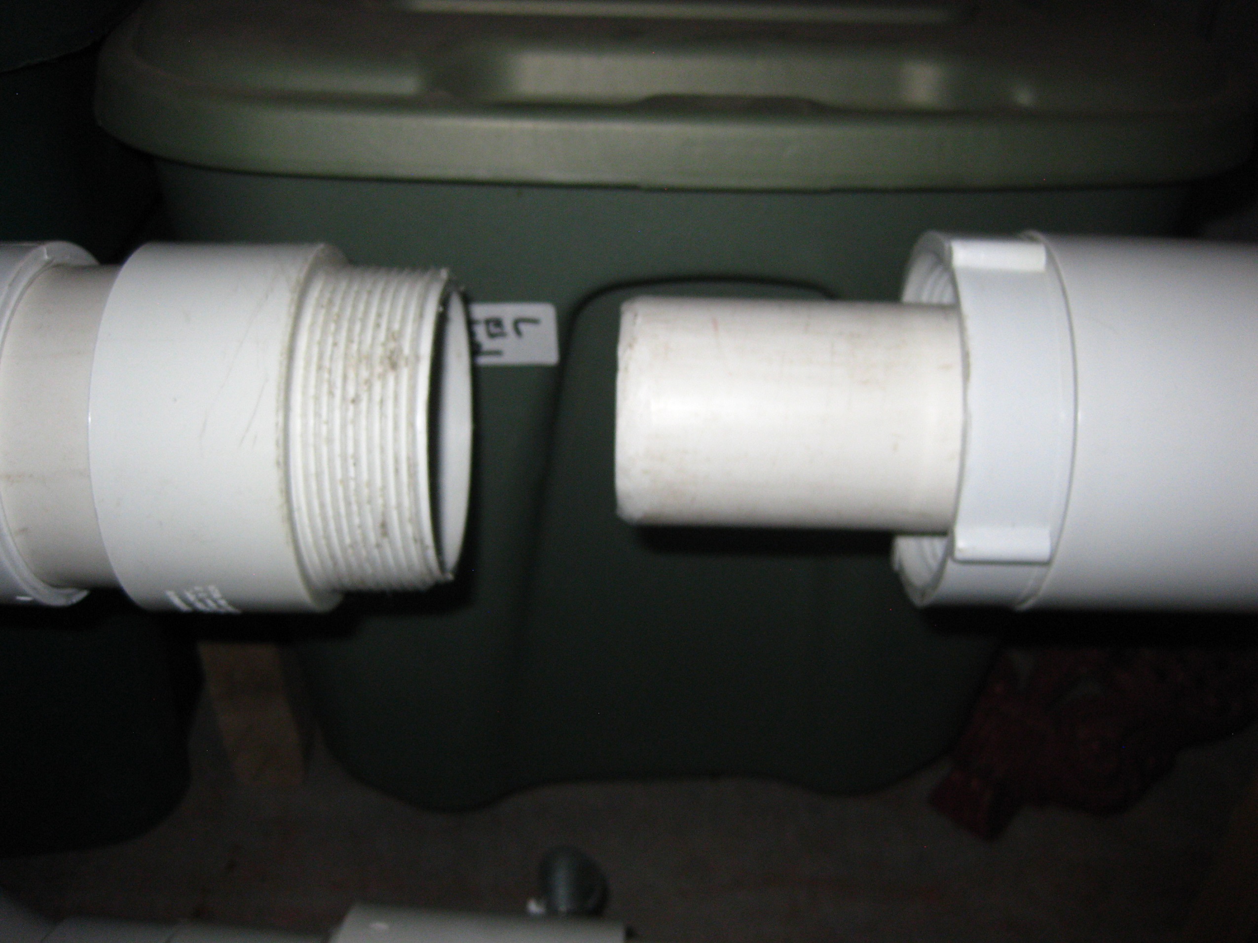

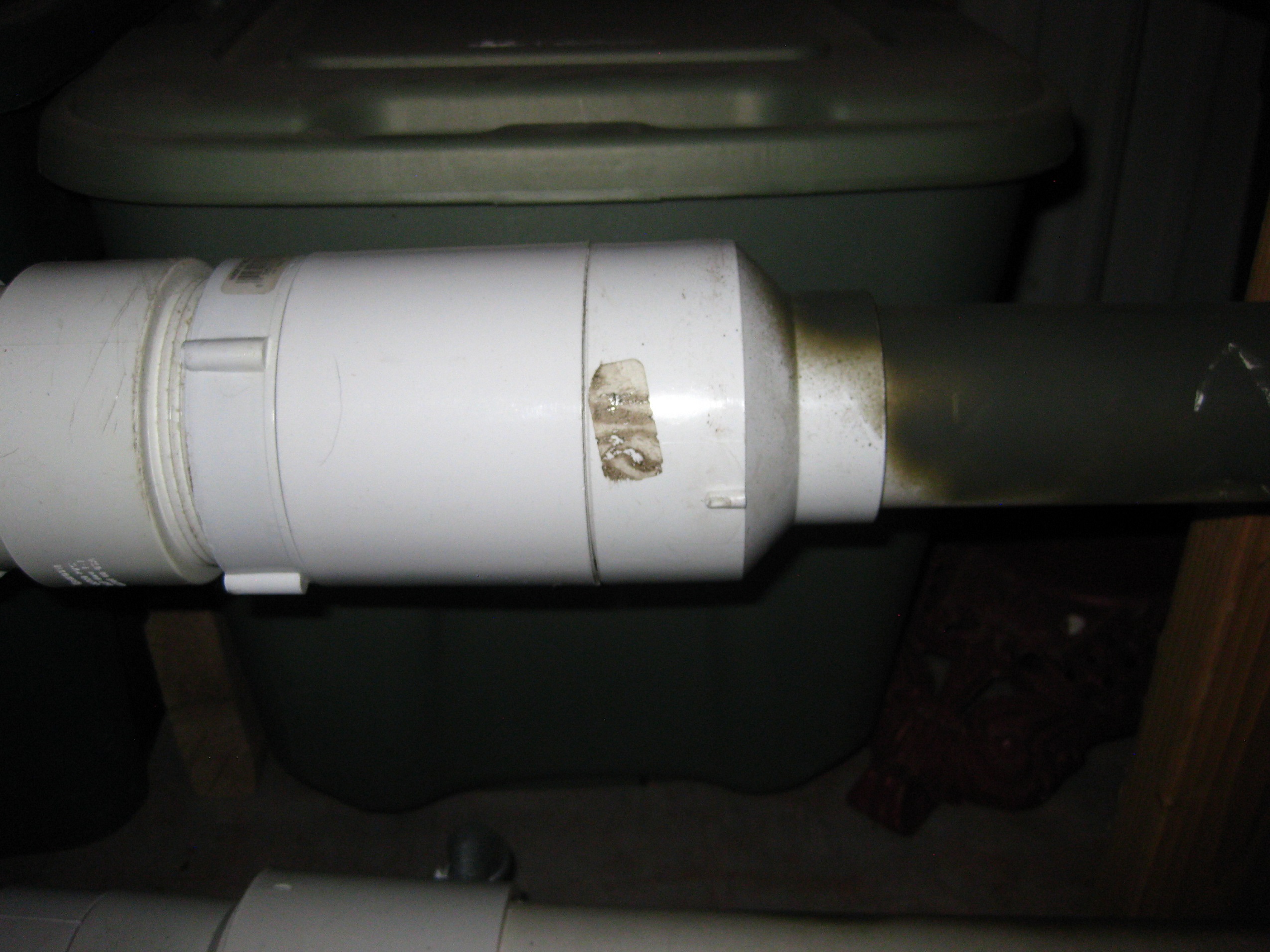

Breech Loading system
More breech Loading System

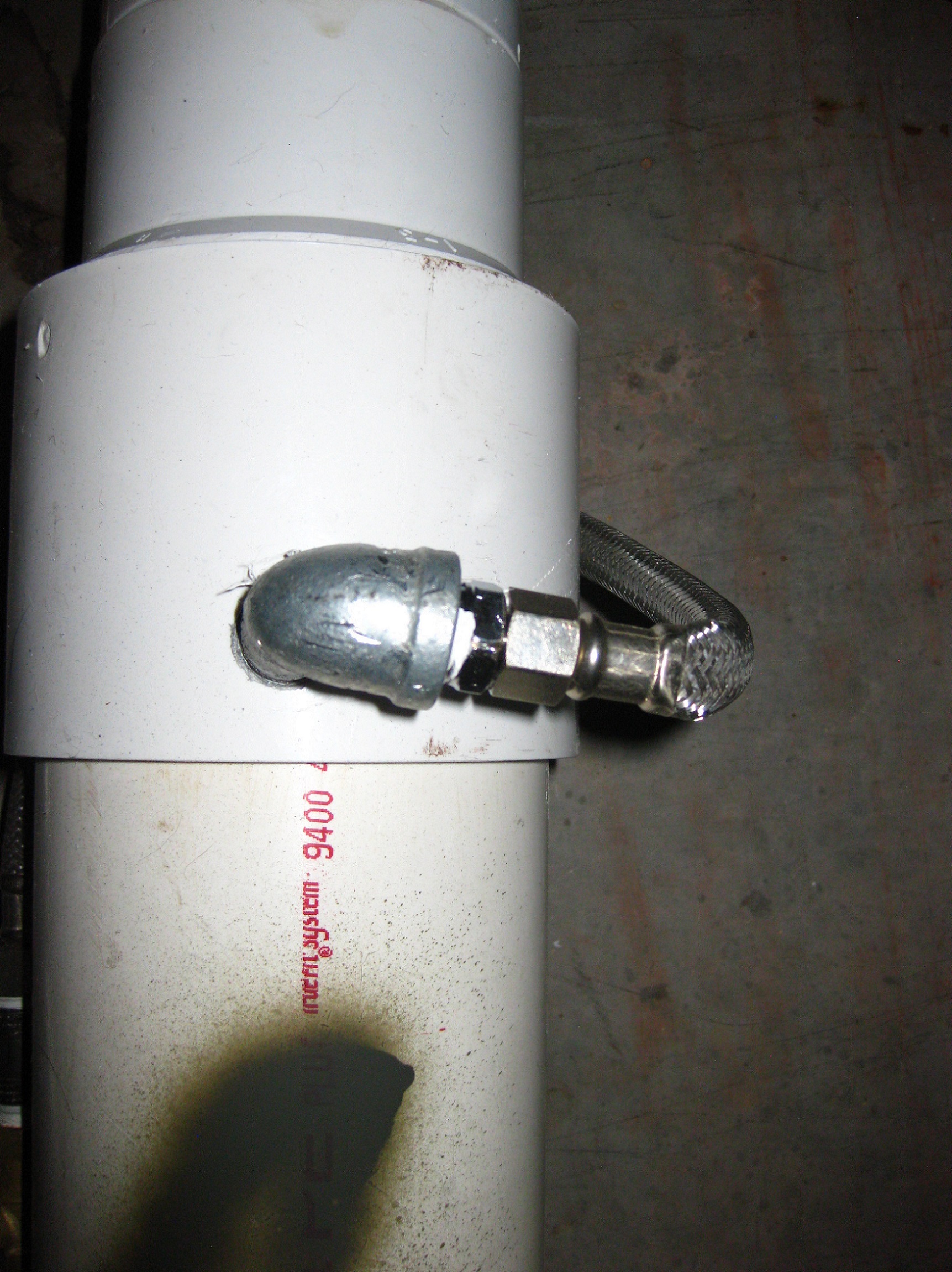

Metering System to the Chamber.

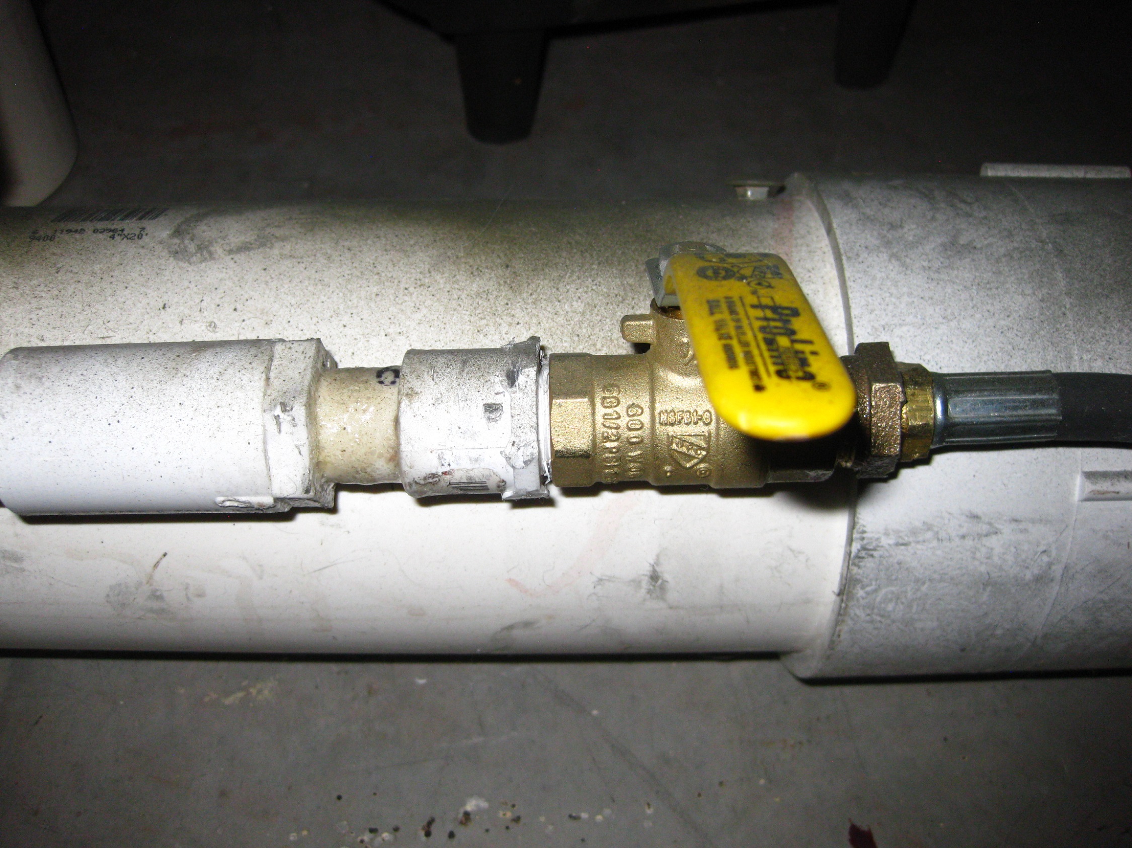

Rear Metering valve.

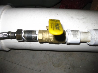

Front Metering Valve.

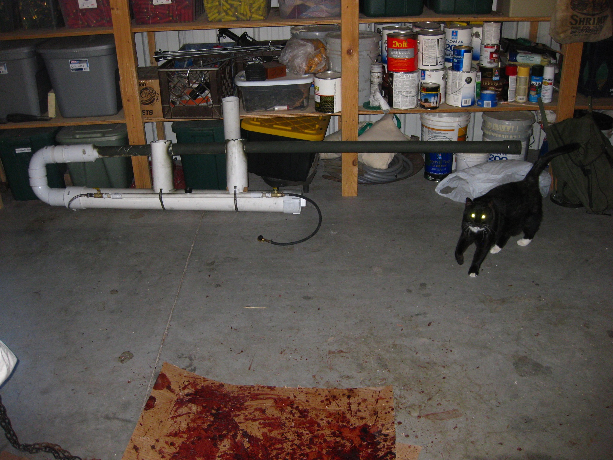

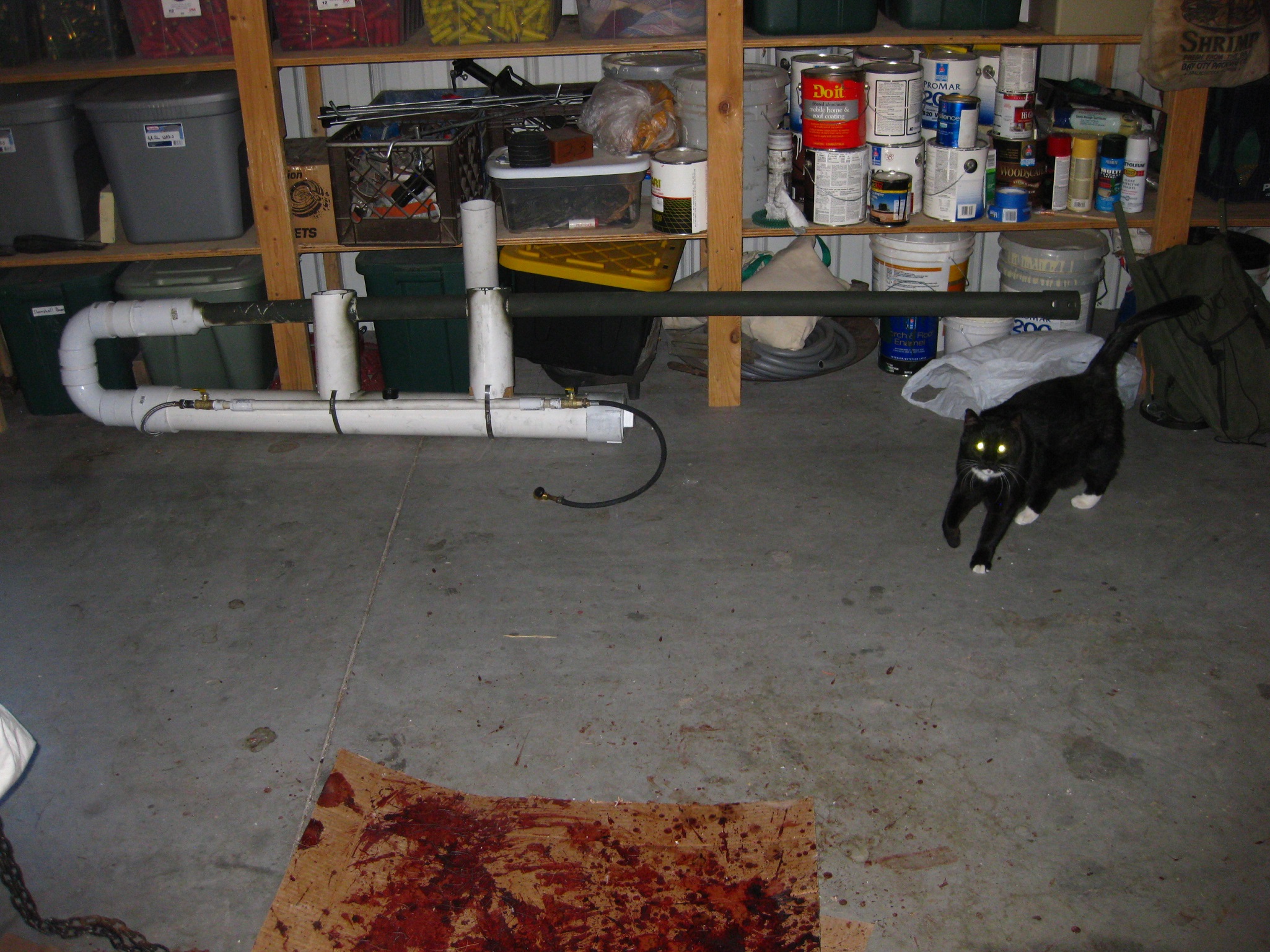

The whole cannon with a cat for scale.

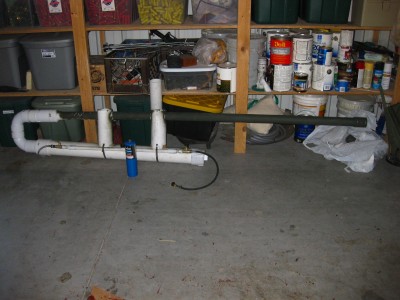

Cannon with propane tank for scale.

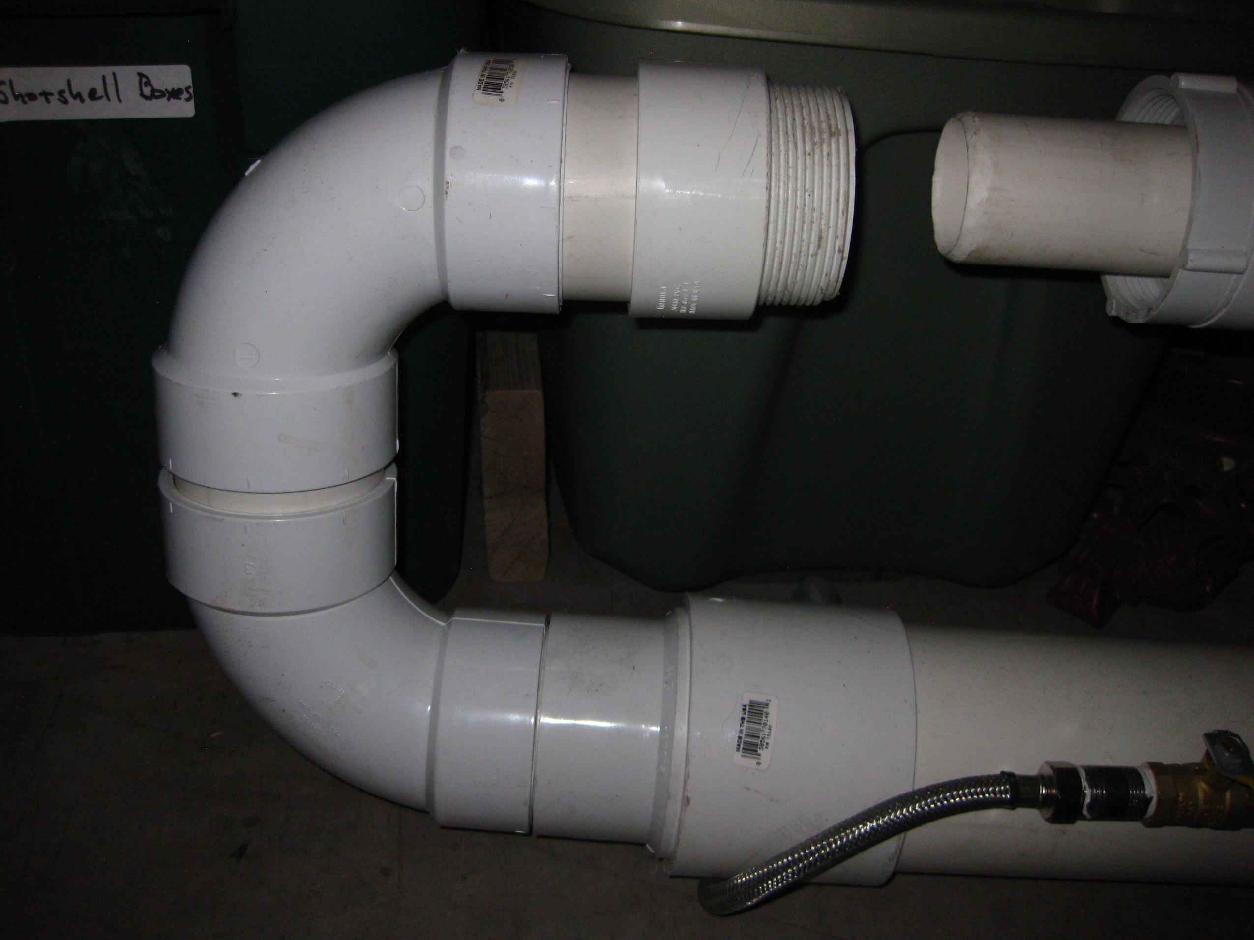

My 3in. U Bend.
Finally the back half of the cannon.

I doubt that muzzle brake is going to be very effective but better than nothing :)

Pretty sure the elbows are not pressure rated, you can see the seams. Pressure rated one are often shorter and seamless.
Also, this looks like your evil cat just murdered something.

I checked they say pressure rated of the labels.

Might want to check this page on identifying the parts.
http://www.spudfiles.com/spud_wiki/inde ... _Rated_PVC
The sockets look shallow and the elbows thin. I would hate to see it come apart in use.
Can you get a macro photo of the rating marking on the 90 degree elbows?
