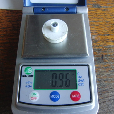

I'm starting with rather exaggerated example - fitting HEAL with the extended (175cm) barrel, and having this "piston"...
... in the breech, and this sabot carrying a .177" pellet...
... 75cm further down the barrel. The space between the two provides a very large dead volume, which shouldn't mix with the cooling air from the chamber.

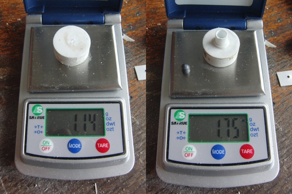

For future tests of this set-up, a slightly heavier and stronger version will be used. Given the gases in the chamber already mass around 18 grams, going a bit heavier on the piston and sabot won't dramatically affect the accelerating mass.

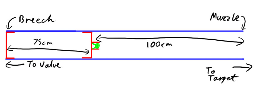

I'm not getting the configuration, care to draw a diagram? Does the barrel have two different diameters?

jackssmirkingrevenge wrote:I'm not getting the configuration, care to draw a diagram? Does the barrel have two different diameters?
No. One completely normal length of 22mm copper pipe - about three hairs over 20 mm diameter the whole way through.
Not to scale:
Any appearance that the sabot and (rather than calling it the "piston", I'll start calling it) the separator are of different diameters is a trick of the camera. They are essentially identical in all but the sabot being fitted with a way of holding the pellet.

Ohhhhhhhhhhhhh... lol I thought the sabot was the small diameter part and you just put it on top to the other piston for some reason
Pistons should be thicker to avoid flexing in the barrel.

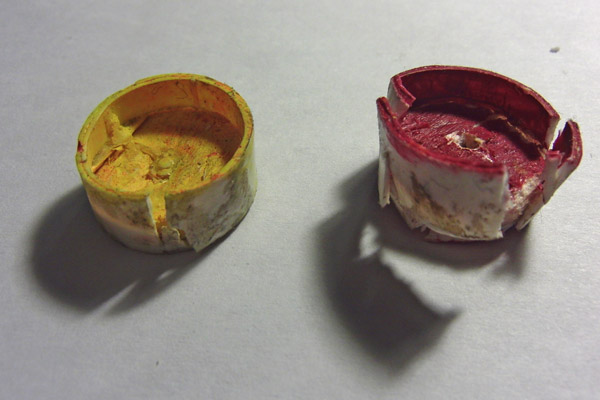

Well, strengthened separator and sabots in hand...
... aaaaaand they didn't hold up:
(I painted them to make them easier to find afterwards).
Well, my first guess from studying them is that I'm getting closer. It looks like rather than the sabot tumbling in the barrel, they exploded from the pressure spike and ditched the pellet off at a wild angle.
Still, there's things that don't add up.
The state of the sabot (purple) is considerably worse than that of the separator (yellow) - the damage is more like it's hit something at speed. Indeed, there's a rather large dent in the HDF target holder that's smeared with magenta paint. (Fired conventionally, the sabots normally just bounce off the target intact at these distances).
There's also something going like a bat out of hell in a few frames of video and a sound spike that matches well.
It's plausible, although not confirmed, it might have been fast enough to have gone supersonic. More testing as and when possible.
