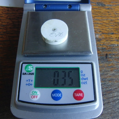

For future tests of this set-up, a slightly heavier and stronger version will be used. Given the gases in the chamber already mass around 18 grams, going a bit heavier on the piston and sabot won't dramatically affect the accelerating mass.

Determining the "piston" strength and reaching a middle ground with mass is part of the shake-down testing.
The first upgrade will probably be enough, but I'll start throwing balsa at the problem if extra upgrading is needed.

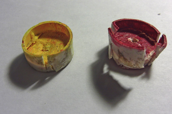

Well, strengthened separator and sabots in hand...
... aaaaaand they didn't hold up:
(I painted them to make them easier to find afterwards).
Well, my first guess from studying them is that I'm getting closer. It looks like rather than the sabot tumbling in the barrel, they exploded from the pressure spike and ditched the pellet off at a wild angle.
Still, there's things that don't add up.
The state of the sabot (purple) is considerably worse than that of the separator (yellow) - the damage is more like it's hit something at speed. Indeed, there's a rather large dent in the HDF target holder that's smeared with magenta paint. (Fired conventionally, the sabots normally just bounce off the target intact at these distances).
There's also something going like a bat out of hell in a few frames of video and a sound spike that matches well.
It's plausible, although not confirmed, it might have been fast enough to have gone supersonic. More testing as and when possible.
