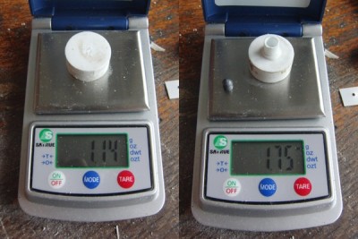

I'm starting with rather exaggerated example - fitting HEAL with the extended (175cm) barrel, and having this "piston"...
... in the breech, and this sabot carrying a .177" pellet...
... 75cm further down the barrel. The space between the two provides a very large dead volume, which shouldn't mix with the cooling air from the chamber.

jackssmirkingrevenge wrote:I'm not getting the configuration, care to draw a diagram? Does the barrel have two different diameters?
No. One completely normal length of 22mm copper pipe - about three hairs over 20 mm diameter the whole way through.
Not to scale:
Any appearance that the sabot and (rather than calling it the "piston", I'll start calling it) the separator are of different diameters is a trick of the camera. They are essentially identical in all but the sabot being fitted with a way of holding the pellet.

Ohhhhhhhhhhhhh... lol I thought the sabot was the small diameter part and you just put it on top to the other piston for some reason
Pistons should be thicker to avoid flexing in the barrel.

Indeed, it's the most obnoxiously oversized sabot going.
Determining the "piston" strength and reaching a middle ground with mass is part of the shake-down testing.
The first upgrade will probably be enough, but I'll start throwing balsa at the problem if extra upgrading is needed.
