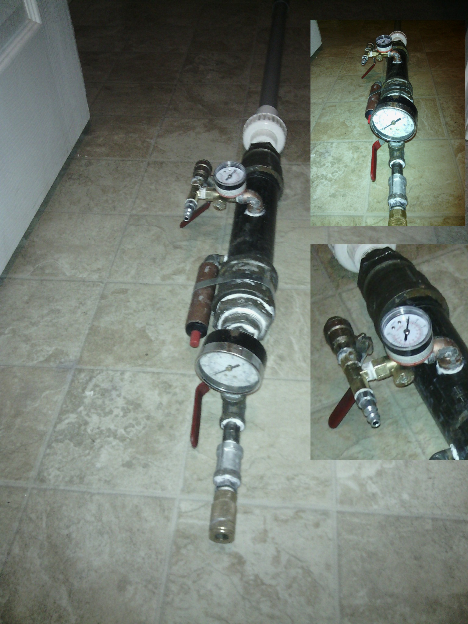

I finally was able to complete my latest build yesterday. This is a basic, run of the mill, hybrid cannon. It has a 48" chamber, propane meter pipe is 1" in volume with a quick connector. The Schrader valve stem is in the center of the chamber and is teed along with a 200 psi gauge. There is also another 200 psi gauge behind the ball valve that separates the meter pipe from the chamber. I only about it at a3x mix but it has much potential!!! Any feedback would be great.

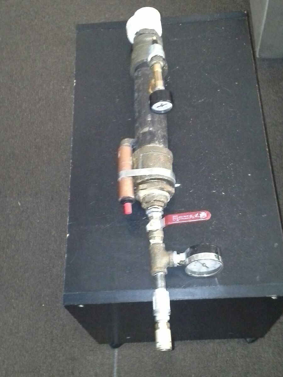

I did that test fire session and had some problems. So i did a fluid volume check and come to find out i was off quite a bit on my chamber size. I was using 737ml but in truth the chamber is 812ml. So i redid my math and came up with 2ci or 34ml of prop needed to be in chamber for normal combustion. So from there i just multiply by mix #. So let's say i wanted to spin up a 3x mix i would multiply 2x3 to get 6 then divide 6 by 1.389 (which is the vol of my meter pipe) to get 4.2 then i multiply by 14.7 to get 63psi of propane and for the air i filled chamber to 3bar. So i did another test fire last night and i set the gun up to exactly for a 3x mix and boom!!!!! It shot excellent!!! Im really hoping that im correct with my numbers. Any advice u have would be great. I got 84 prop for 4x mix. Im posting the latest pics of the updated gun.

Is that a PVC union in the breech?
Yes sir it is. Its rated for 175psi. I was using it for 4x mixes and under. Works f...ing great!!!! Im literally walking in my apartment coming from a test fire session. Im absolutely thrilled at the way this gun fires!!!! Only problem is....the spuds come out as a mist after 3x mix. I gotta machine me up some rounds!!! Roughly 13mm. I must say that i pulled my hair out for many o nights trying to get the correct fueling for this hybrid and finally i got the numbers worked out perfect i can sleep at ease......or until the next build!!! Lol!
I'd advise swapping out the union for a metal one as soon as possible, PVC is gonna blow shrapnel everywhere when it fails. I think the general rule for hybrids is to assume 80-100 psi per mix, so you should be hitting well over 300 psi. Along with the fact that it's a pressure spike rather than slowly building it up, that PVC union is just a failure waiting to happen.
It's unfortunate but trusting that, especially as a handheld, is really risky.
I really like the design of the PVC unions, but wouldn't trust them on a hybrid. Too bad they don't make an aluminum one that uses a similar design.
Cam lock fittings are another option. The pressure ratings aren't too high, but I trust them well above their rated pressure while I don't trust PVC at it's rated pressure. PVC is just too inclined to shatter. I have had some issues with some cam locks not gripping some burst disk materials well enough.

I'm loving all the feedback I really appreciate it. the deal with the PDC Union is because it has an o ring in it and I couldn't get my 1 inch steel Union to seal. but listen I'm going to lose that PVC union asap!!! I actually only had it on the gun to test fire it without any rounds in it I guess I got carried away. Can I modify the steel Union I have to make a better seal it has a lip on it that doesn't seem to make a seal correctly. Oh by the way it is 1". I'm at work right now but ill post a pic of the union when i get home later.

Steel unions as they come from the store won't seal by themselves. I always head over to the gasket/O-ring section of the hardware store, disassemble the union, and find a gasket that's the right size to seal it up. If you can't find one, it's pretty easy to get sheet rubber and cut a little ring. You can just pop the gasket in right where the O=ring is in the PVC union and it should work fine.
