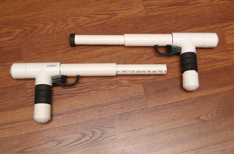

My friend has a big bang cannon when i checked it out it was so simple i figured i could make something like that with PVC. His is one of the smallest ones you can buy but it sure does pop pretty loud.
I like mine better. I built one for him though
These are made from 1" PVC, 2 1" PVC caps, 6" PVC for the barrel down to 3/4" PVC 6" long. 1" PVC Tee all SCH40.
The ignighter i got from walmart king grill ignighter $1.
Everything else i found around the house, the grips are from a shelf from a harbor tools aluminum gun case. The sights are from a toy gun (top) and the bottom are a shotgun fiber optics kits from walmart i used one of them for my AR15-22.

Neat, I really like the way you incorporated the the ignitor into the design to form a trigger guard, nice work!

I almost didnt add the trigger guard but i thought ide try and it worked out ok. A little sloppy with the hot glue but i figure if i paint it you wont see the glue. Then i decided white might not get me shot so ill leave the color safe

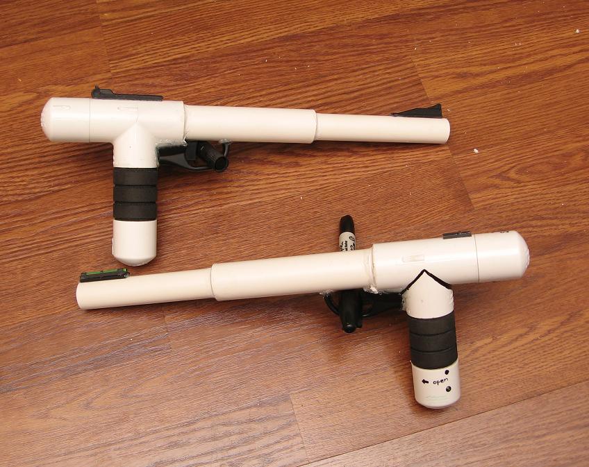

better view of the trigger guards before i cleaned off all the ink and put on the sights.

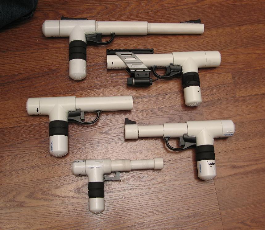

We shot them all day today at my friends watching the superbowl, we were shooting carrots, marshmellows, wads of papertowels, we even stuffed a clean female product down the front.
Ill tell ya for how much carbide we use they have some amazing power. Ide bet if i weighed the amount it would be around 1-2 grains if that.
I made a few changes to them though. When i shot a marshmellow from them at my home the rear cap blew off wich im lucky i wasnt holding it up near my face it might of gave me a fat lip. I added a screw to both caps and cut out a little notch to push in, twist and lock so the caps can both be removed but locked on under the pressure.
I built 2 larger cannons using 4" to 3" SCH40 but im not going to risk putting anything down the barrel. This gas seems to burn WAY to fast to be safe.

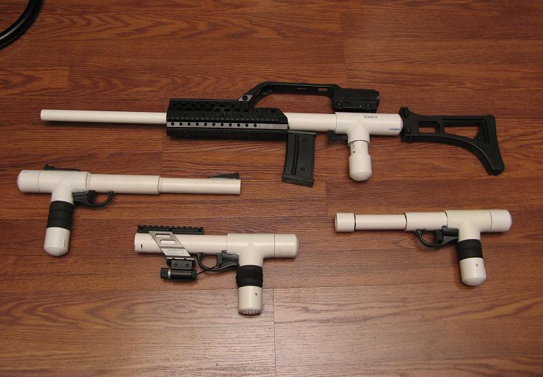

I made a couple more from the parts i had left. Couple friends wanted one after the superbowl party.
Nice collection your building there...

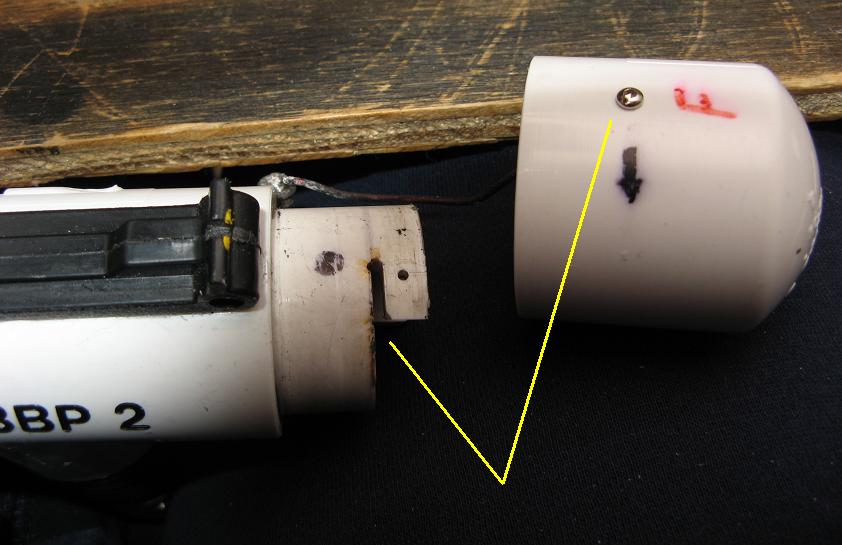

Caution on using PVC for Carbide Cannons. PVC is brittle and will eventually shatter. Calcium Carbide mixed with water does produce Accytelene. Accytelene has a very wide explosive range and does detonate when mixed properly. This detonation is what produces the loud sharp bang that is so attractive. Unfortunately the repeated shock to PVC will cause it to fail.

The first one i built i just put the caps on with my hands, hand tight and it took 2-3 shots before it blew the caps off.
Im working on a Rifle now to shoot the mini marsmellows also. The smallest marshmellows they make 1/2" i thin they are.

Technician1002 wrote:Caution on using PVC for Carbide Cannons. PVC is brittle and will eventually shatter. Calcium Carbide mixed with water does produce Accytelene. Accytelene has a very wide explosive range and does detonate when mixed properly. This detonation is what produces the loud sharp bang that is so attractive. Unfortunately the repeated shock to PVC will cause it to fail.
Maybe you think the caps are threaded?
Ive put 2 safty spots on all of these smaller guns, i put a small allen screw in both caps and i put a key cut in both connections to the tee.
These 2 spots are both pretty weak i could break them off with my fingers. They will let go and blow the caps off before the PVC lets go.
I could test them with a scale using a dowel rod and pushing down on the scale till they break off. We almost have a setup to figure the velocity of the marshmellow. We tried with just the marshmellow but i think we will need to wrap it with foil or something solid to trigger the sensors.

Neat little armory! To be honest I would still go with a quick calculated syringe squirt of propane to give more consistent results while still having a decent bang, but you seem to have the carbide thing figured out :) it could be that your ignition would have to be modified to work with butane or propane.
