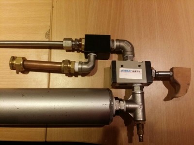

Hey there,
This is my first topic on spudfiles :)
I'm trying to build an airsoft sniper;
The connections are 3/8''. I use a 3 way 2 port valve to pilot the QEV.
So it's semi automatic, and the barrel is 7mm, unfortunately no 6mm :/
I guess my chamber is kinda good for bb's, please comment if it's not right :)
I've weld my own air tank, and am able to charge it to 15 bar max with my pump or compressor ( tire valve )
Thanks to Wyz2285 for this awesome idea for qev and 3 way valve.
I'm pretty stuck with the trigger, made a wooden sample. It's too big and unhandy
The idea was that i'll make a wooden stock with grip to use the trigger valve.
I have actually no idea what kind of magazine I should make, but I've some ideas for loading the bb.
Also the ball detend is a pretty hard thingy to make it functional :S

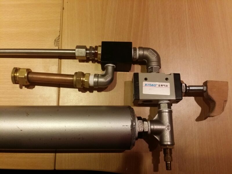

Look at the picture for some usable information.
Really apreciate if you have some comments for me, so I can go further with building my gun :)
When something isn't really clear, just comment and I'll explain it explicit!
Goodluck with helping me!
Airgun picture
Airgun picture

if you want it to be a sniper, you probably want to shoot long range and there is no way to do it with that pipe. and i suggest a fridge compressor for at least 30 bar. any how i think this setup works fine for multishoot with regulated pressure,
come undone
BartSkillZ wrote:the barrel is 7mm, unfortunately no 6mm :/
Unfortunately this is critical, you will lose a lot of accuracy and power too.

Yup, I am going to buy a Paintball tank with pressure regulator, but can't find any small regulators that goes to a low pressure of +/- 10 Bar. I guess my 3 way valve can't have alot of bar unfortunately :(
I own a handpump that can go to 15 bar, and a huge compressor which goes to 9 bar max.
I was thinking about getting an fire extinguisher and modify it with a pressure regulator to connect on my airgun whith push to connect fittings. Good idea? let me know.
And I'm going to order a new barrel of 6mm to have more accuracy with my bb's :)
Please reply for more help, It would be very nice and useful for my ongoing project ^^

you could make a barrel breach after the qev and use custom made ammunition with a 6 mm steel bb and a wax body like I saw on someone on this site. Just an idea .. :P
You could also manufacture your own projectiles from lead or even use 7mm steel ball bearings, your choise
P.S.
are those pneumatic valves ? if so, don't raise pressure, or else they will fail, the max operating pressure is 10 bars for pneumatic valves

try finding a paintball tank with a built in regulator, and you can manually adjust the output pressure for your own needs (there is a youtube video in which it's explained how you can lower the output pressure from 30 bars to less)
I'm glad to hear you decided to change the barrel to a 6mm one. it should be OK for an airsoft sniper(I said airsoft=>not much power)

Kijk hier anders even:
http://www.mattech.nl/index.php?page=pr ... ntluchters
Daar vind je snelontluchters ( QEV) maar ook schuifventielen ( 3-way)
Die werken net iets makkelijker.
De QEV's heb ik gebruikt op 60 bar, helaas redt zo'n 3-weg dat niet.
je kunt wel een "hammervalve "gebruiken als pilot ipv de 3-weg.
Dan gewoon de kant waar je vanaf vult vernauwen, zodat je gewoon kunt pilotten.
Zij zijn trouwens vrij goedkoop op die website..

nice concept for the gun.
if you wanted to make a few alterations to positioning, it could be more gun like and allow for a better trigger with the 3/2 valve.
1 the 90 elbow between the QEV and 3/2 should be straight
2 the 3/2 should have the button down, a trigger can now be added with a pivot point to the top left allowing pullback to be transferred to upward motion.
3 swap the schrader valve and air tank positions that will allow the tank to be used as a stock.
hope this helps, this is the way that i have built 2 fully functioning semi auto C02 rifles. any other questions let us know

Does the 3way 2 port valve operate in a similar way to what a slide valve does?
How do you fix your tire valve to the fitting enabling you to screw into the gun?
anarchy08
Posts: 52
Joined: Tue Aug 02, 2011 10:16 am
if you have the correct 3/2 valve normally open, then yes otherwise the gun will fire on the release rather then the pull of the trigger.
sorry, my mistake by the picture, i meant the fill valve under your tank to swap positions

I understand your alteration instructions except for the second part of step 2 (trigger can now be added with a pivot point to the top left ). top left of what?
