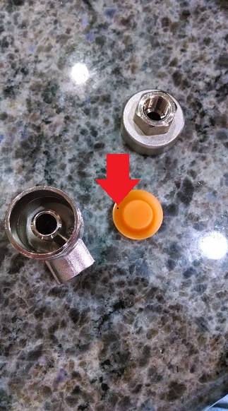

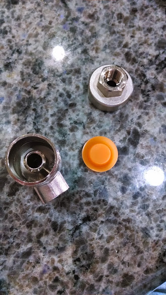

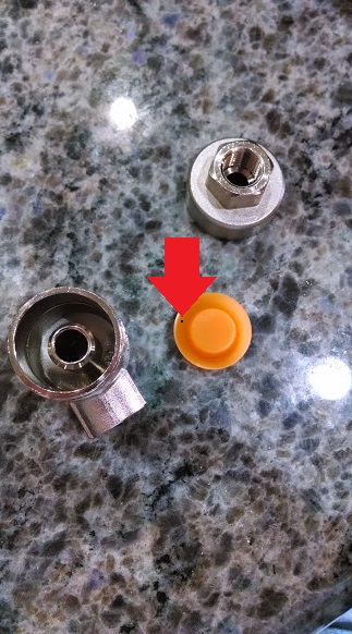

OK, finally got around to this. Here's a pic of the QEV valve disassembled. Where exactly should I make the pinhole?
Been thanked: 350 times
Humancarpentry
