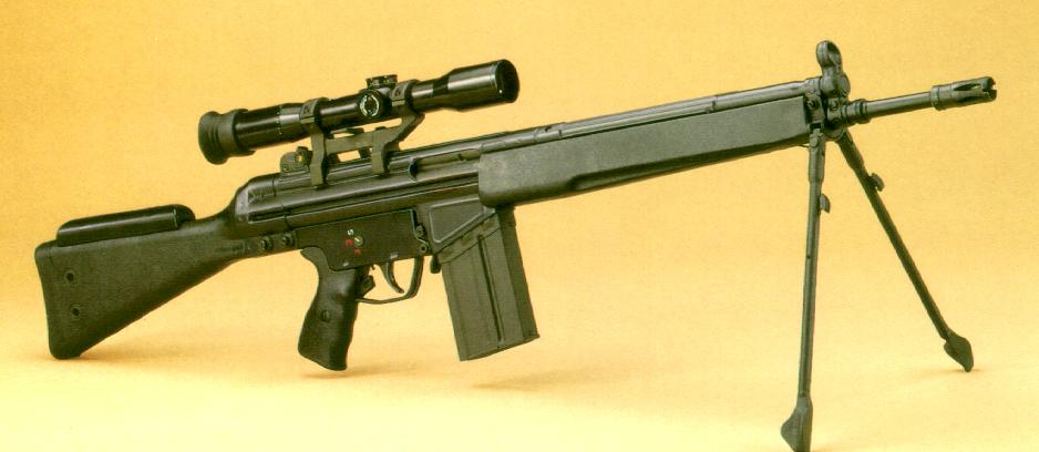

The blow forward bolt catridge ejector(where the mag will be) is away from the trigger ,in most of the assault rifle the magazine is close to the trigger eg: M4,M16A2,AK-47 and for rest it mostly bullpup configuration like Famas and Steyr AUG. In your drawings above, the AR-15's mag is close and your guns mag is away from the trigger.

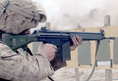

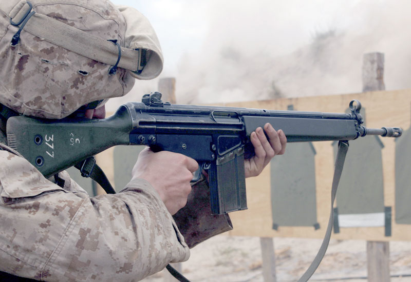

If your main priority is aesthetics then I suggest you change the body from AR to HK-G3SG1 sniper rifle which has the the mag away from trigger maybe you can place the mag a bit further and not mess up the actual look of the gun.

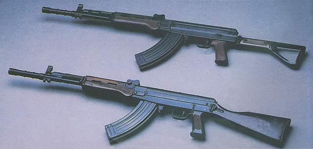

Also another assualt rifle which my country uses is Type 81 (below), has mag far from trigger ,
just some ideas to make the look more realistic.

I completely agree with you. Having the magazine well closer to the trigger is something that I hope to achieve. Unfortunately, I think it would require moving the QEV back further to make room for the bolt. In that configuration, I don't know what I would do with the chamber, as a scope would look funny back that far.
I used the AR-15 for a reference to get the grip and trigger in the right spot with respect to the barrel and action. I haven't designed the bolt and ejector yet, so I likely exaggerated the length of that section, so by the time I'm done I hope to reduce the length of the 'reciever' part of the gun.
