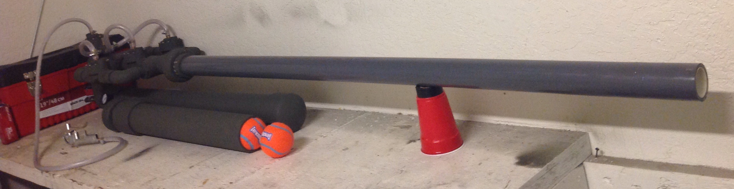

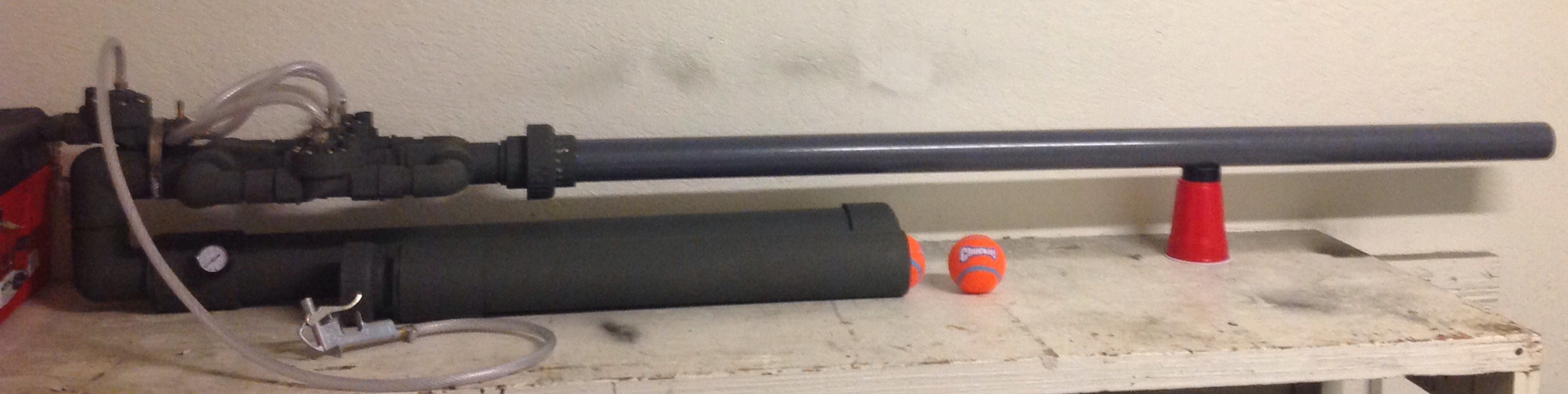

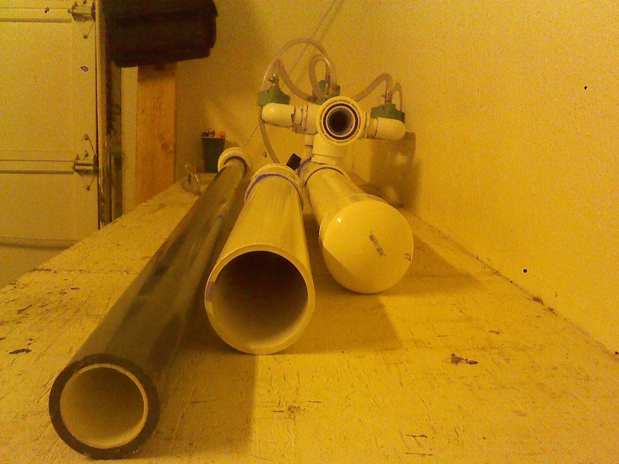

Edit... This is Trinity's latest incarnation. Scroll down to see more photos.
Thank you SpudFiles!
I've been lurking in your forms for many months now, but I finally just joined so I could thank everyone here.
Go easy this is my second cannon. It's fully functional but only about 90 percent complete. Sorry about the Crummy smart phone photos and primer stains, but a little spray paint can fix that.
"Trinity" Named for its three valves.
The basics...
Valves: Three 1" Orbit Sprinkler valves ( Pneumatically triggered by 4th sprinkler valve)
Pilot: 3/4" Orbit Sprinkler valve ( Pneumatically Triggered )
Chamber: 36" pf 3" sch 40
Total air volume: 335 cubic inches
Barrel: 60" of 1.5"(1.73" id ) sdr 26 sleeved with 60" of 2" sch 80 and a 24" by 3" sch 40.
C/B: 2.37/1 with the sdr and 1.9/1 with 3" sch 40
Range: 1000+ feet with golf balls.
After starting with a compact single sprinkler valve launcher this thing is a monster. Thanks again SpudFiles And everyone here for the knowledge to build my first two cannons.
Hooked...Boomer :D
Edit...

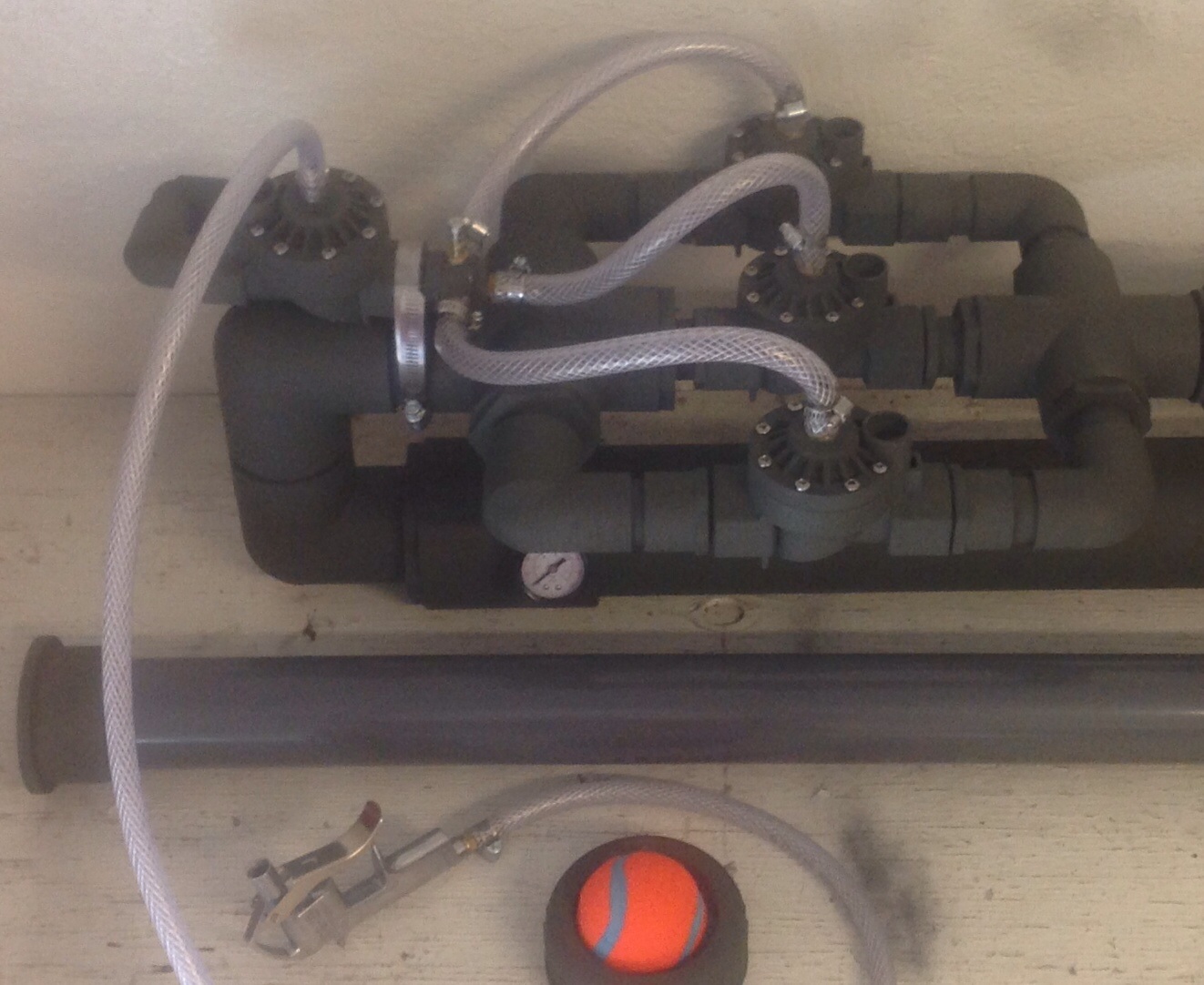

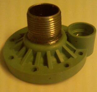

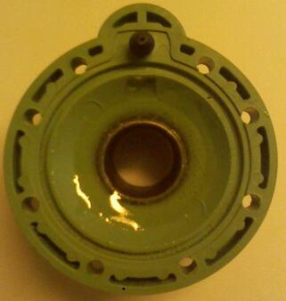

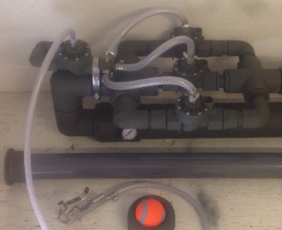

A little info about the pilot valve. When I first started testing I was using a brass cross fitting and a blow gun to pilot all three valve. Well this worked it wasn't ideal. There was a slight delay( 1/10 of a sec maybe? ) before the valves opened. After changing to the sprinkler valve pilot the trigger responds instantly and with authority.

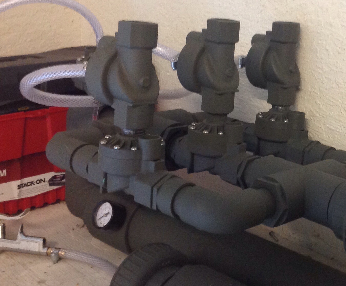

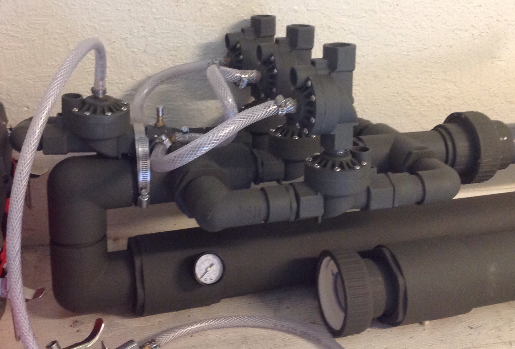

Here's a little better photo of the valves...
Boomer58cal wrote:Here's a little better photo of the valves...
Some photos or videos of stuff you've perforated are always appreciated ;) pretty is as pretty does!

I finally got around to painting Trinity. It's just that flat forest green "camo" paint, but I like it. I was going to full camo it, but once I sprayed the green on I decided To leave it. It looks almost parkerized like a surplus military rifle. I think it looks like it means business. 8) Now I just need to finish the barrel brace so I can take it to the ranch this weekend.
Well what do you think?

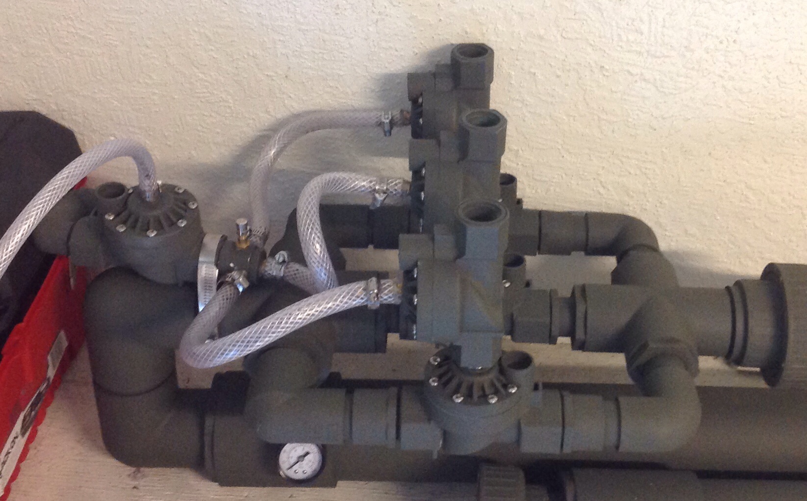

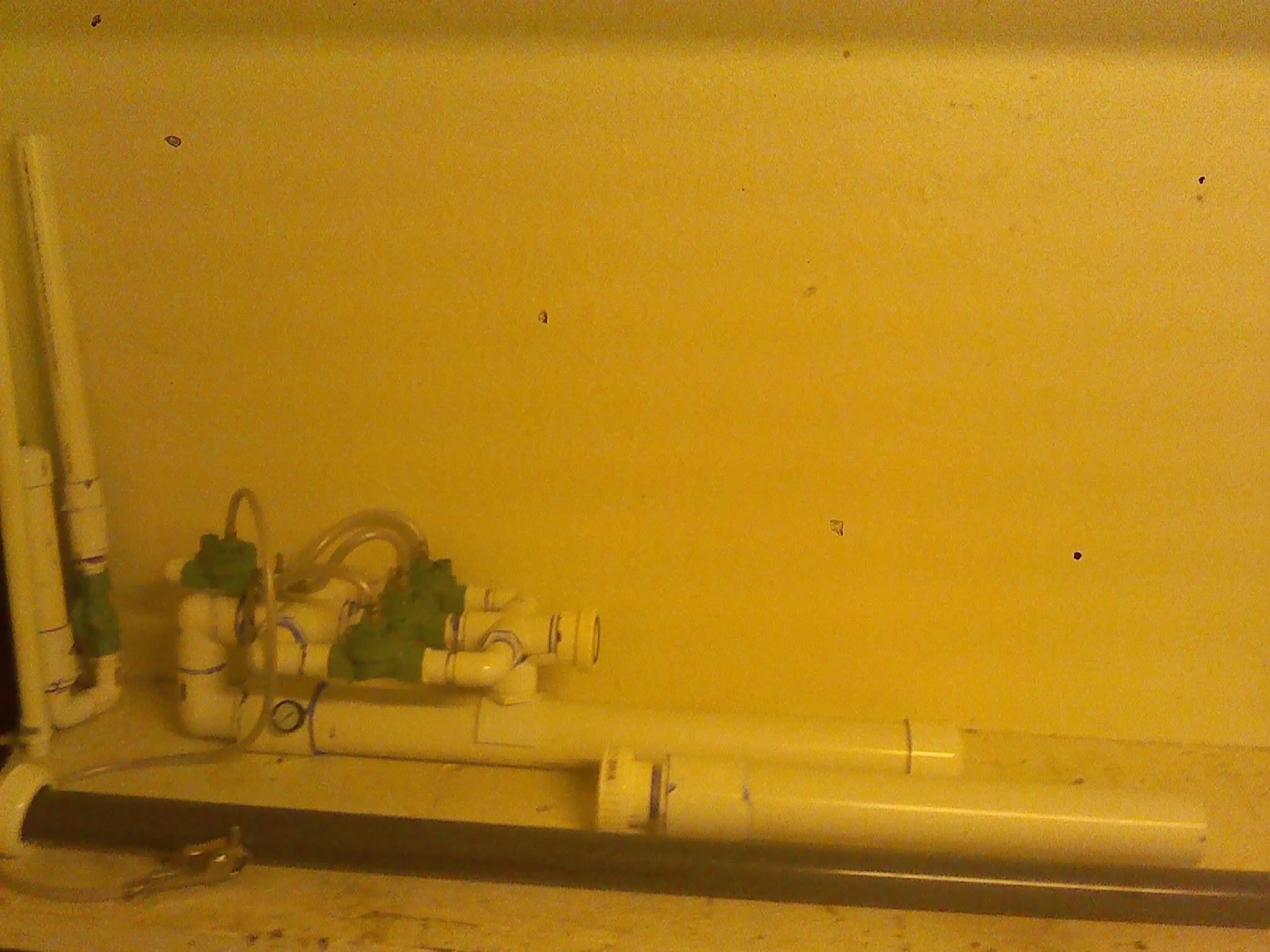

Edit... I finally got the new pilot valves done. Photos at the bottom.
Wanna talk about loud! Have you ever heard four 3/4" and three 1" valves go off at once?
The biggest problem is you can't even see the golf balls now, at best you might get a little flicker of sunlight off them 3-400 feet out. :wink:
I'm getting about 150 yards with a 3" oversized Chuckit! Tennis balls ( they don't have the best drag coefficient do they )@90 psi. Hopefully I'll get a chance to push it up to 120 psi today with my big compressor, yesterday I was running off my small one.
Well I've had a hard time finding the golf balls when fired at max pressure (120 psi) and yesterday I found out why. They're going about 200 feet into my neighbors field, which is about 1400-1450 ft. I can't say enough about how impressed I am with the power of these pneumatic animals

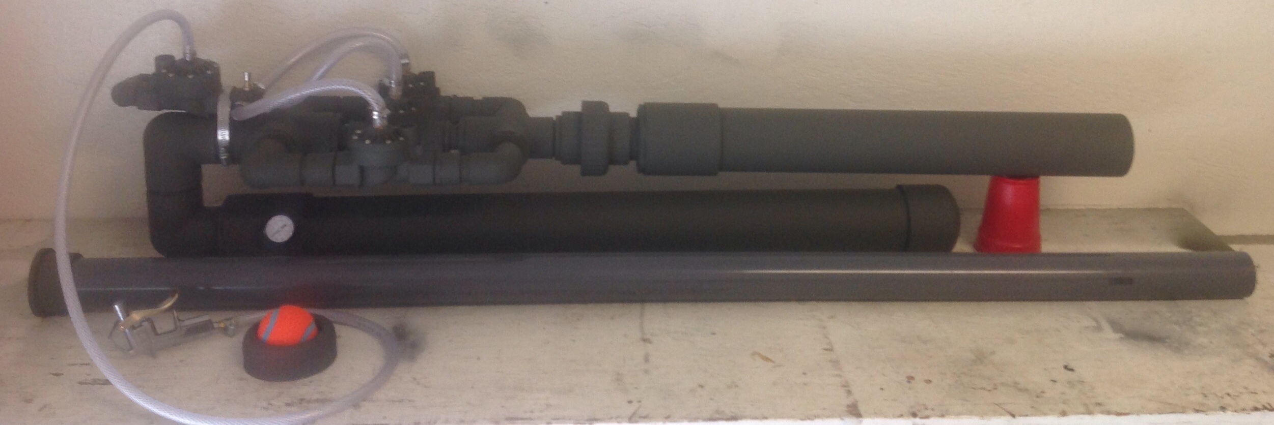

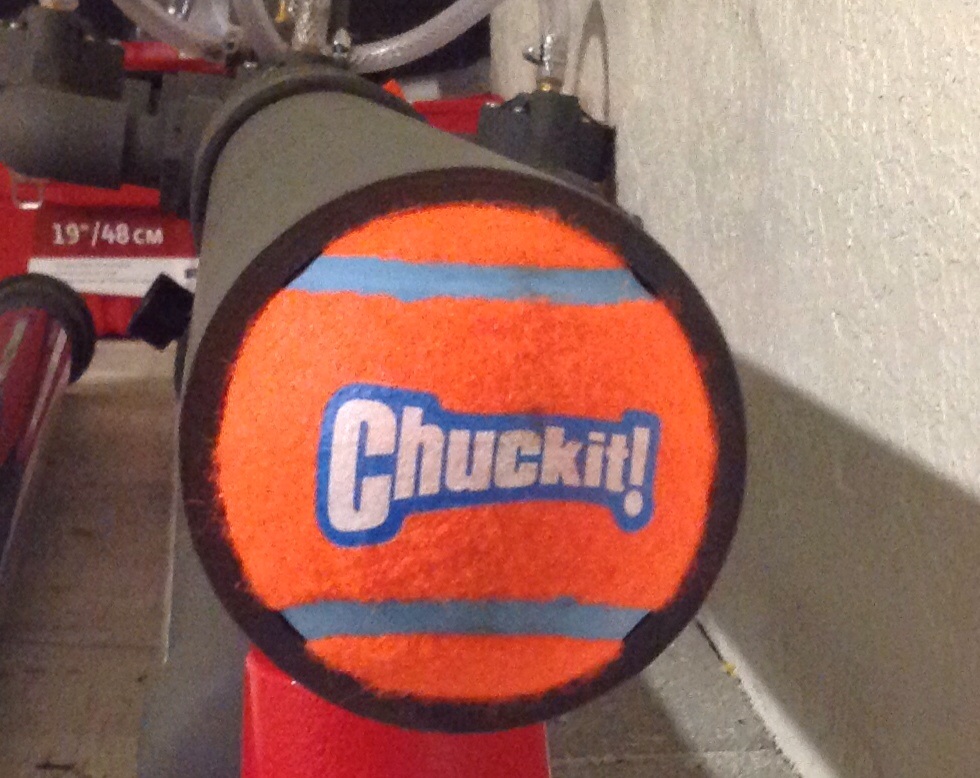

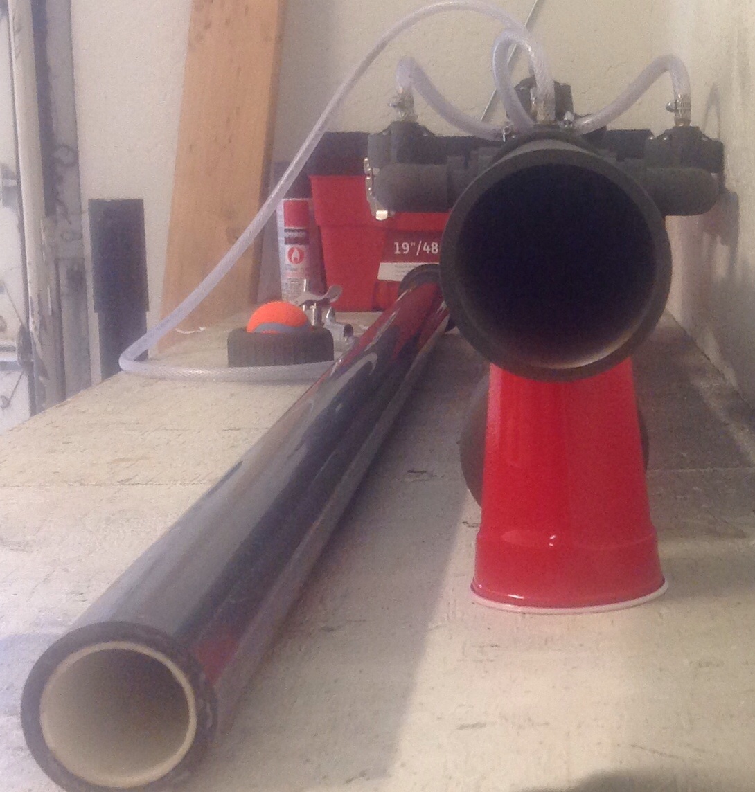

Here you see my 3" L.O.L. ( large object launcher ) 24 inches of 3" sch 40
Edit...I just found out Large size Chuckit! Tennis balls fit 3" sch 40 perfect.

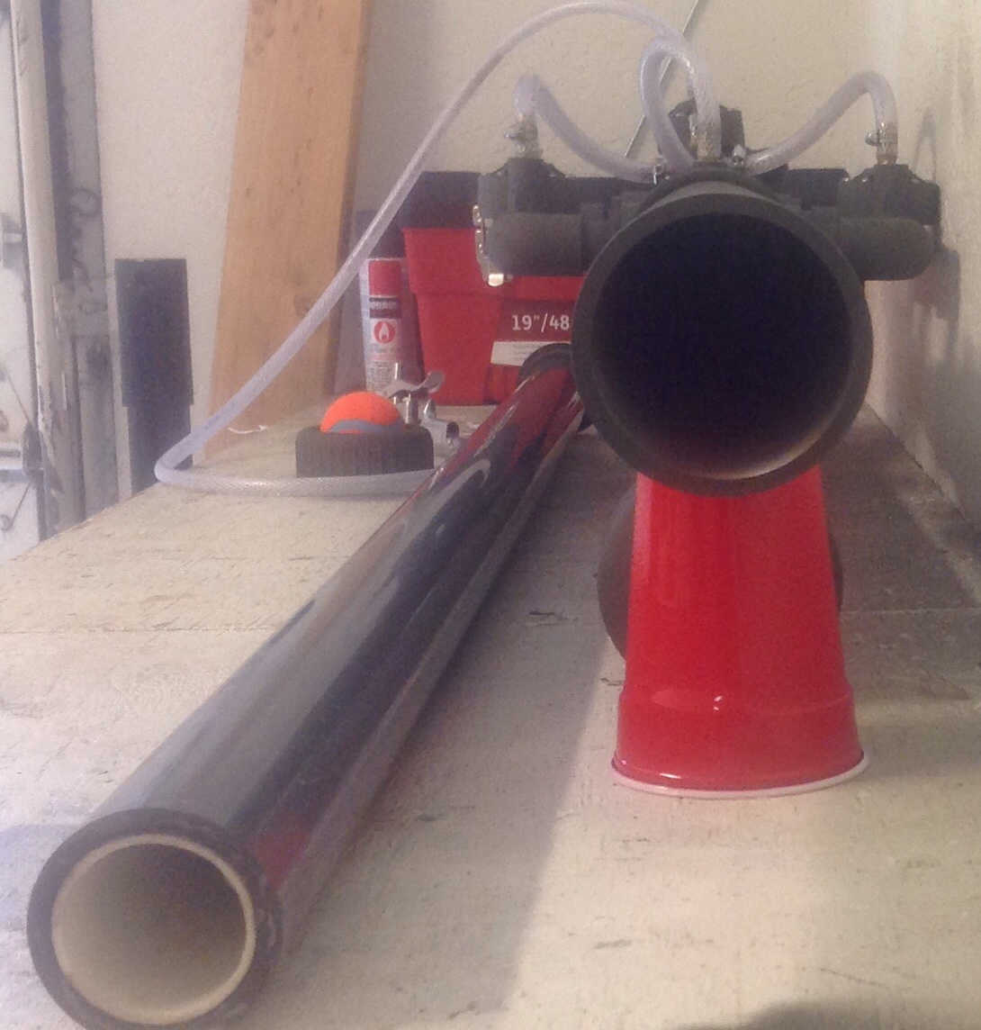

60" SDR Golf ball barrel

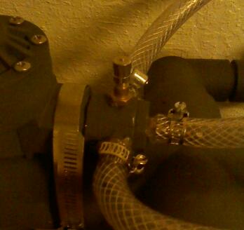

The shrader valve between the pilot and the main valves to get them to closewhen filling.

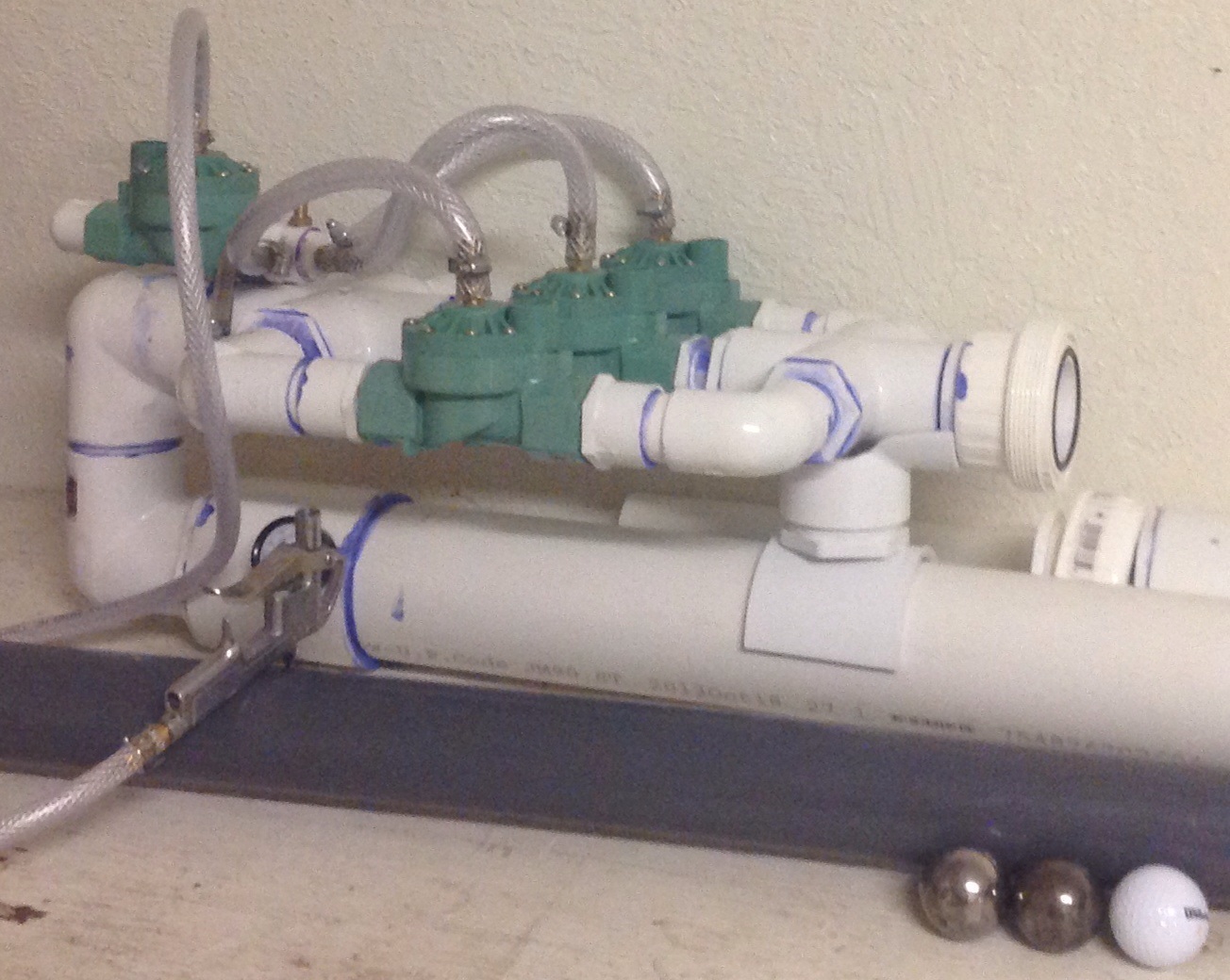

Three 1" Orbits sprinkler valves, piloted by three 3/4" Orbits, piloted by a single 3/4" valve.
