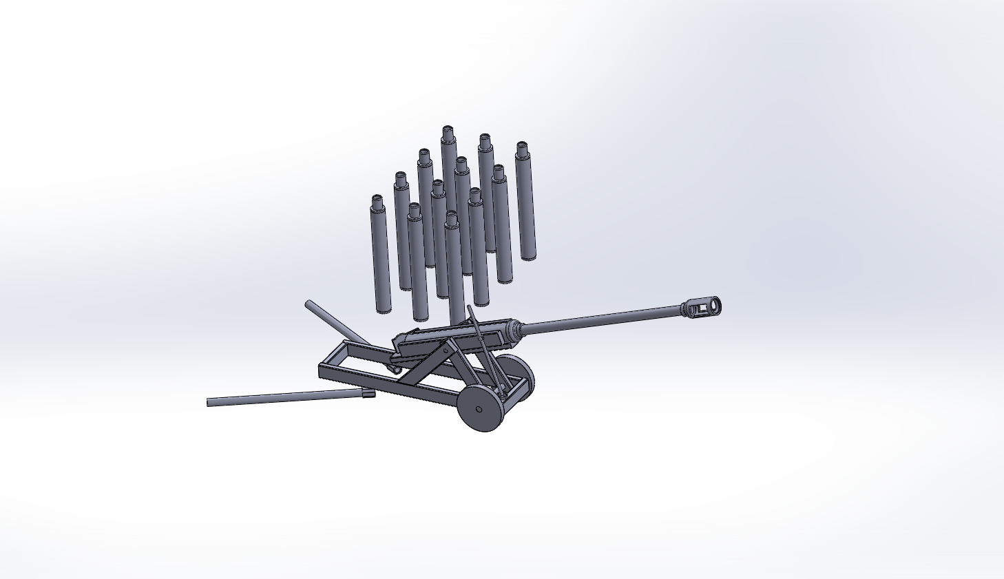

Here's the solidworks working sketches;
Solidworks front view
Solidworks isometric
The shells imaged in the second photo are a little too long, and the A-frame is gonna be a tad different. We're trying to model something like the M119 but with split-legs. Don't bother lookin it up, it doesn't nearly resemble it.
