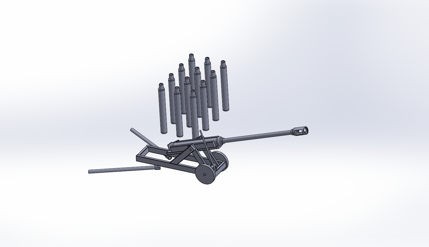

Hello Folks!
This is a post I made on a machinists forum, so bear with me a bit.
I saw a post about someone wanting to rifle a barrel for a PVC potato cannon in search for a solution myself. My friends and I had this idea to make a potato howitzer. We're taking this pretty seriously.
These are the details:
Rifled PVC sched. 80 barrel, 2"
Precharged shell w/ 3" combustion chamber
4" chamber (shell-holding)
Threaded elevation adjustment
Firing mechanism is electronic with spark plug
Muzzle break serves no purpose
For the potato-kings out there;
I'm going to use starter fluid as the propellant
barrel will be 4 feet long,
The name is 100% inappropriate, but rightly fitting. Initials are PI

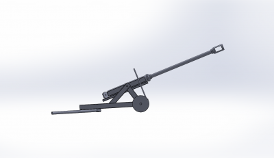

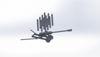

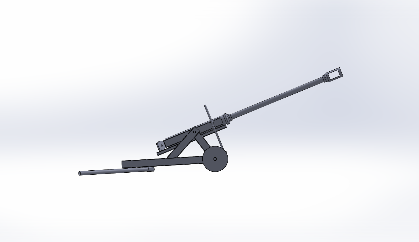

Here's the solidworks working sketches;
The shells imaged in the second photo are a little too long, and the A-frame is gonna be a tad different. We're trying to model something like the M119 but with split-legs. Don't bother lookin it up, it doesn't nearly resemble it.

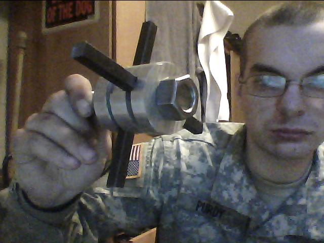

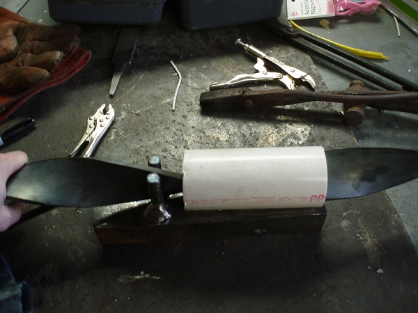

Here's the cutter I machined without the blades made just yet. We're going to try and make a triangular "cutting" rifling.

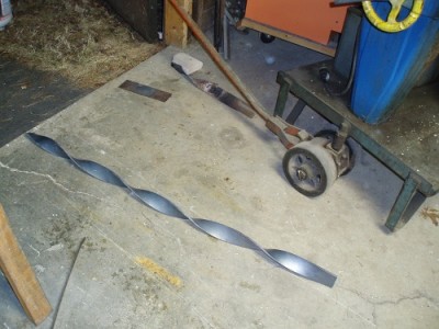

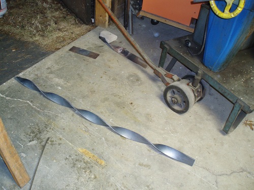

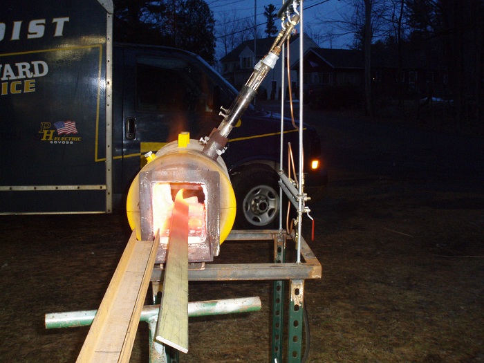

This is what I just made on the forge. This will be welded to the threaded rod on the cutter. A jig will be made to guide the twisted plate into the barrel, which will be clamped to the end of the pipe.

This is the rifling jig so far
