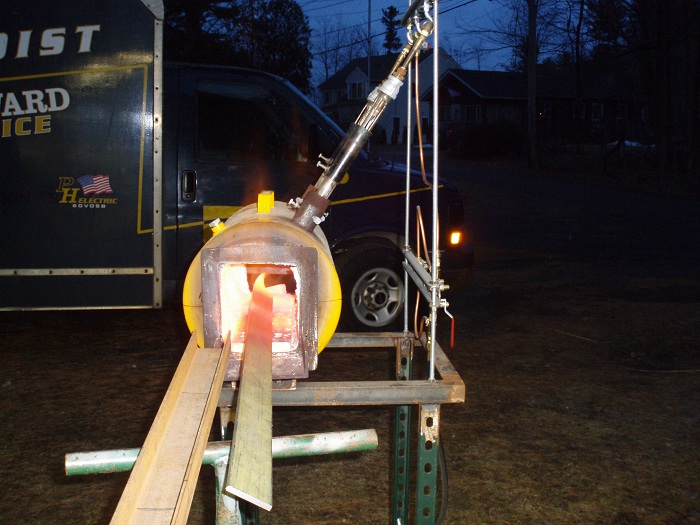

This is what I just made on the forge. This will be welded to the threaded rod on the cutter. A jig will be made to guide the twisted plate into the barrel, which will be clamped to the end of the pipe.
Bar used to twist rifling
This is my forge as I made the twist in the bar.
