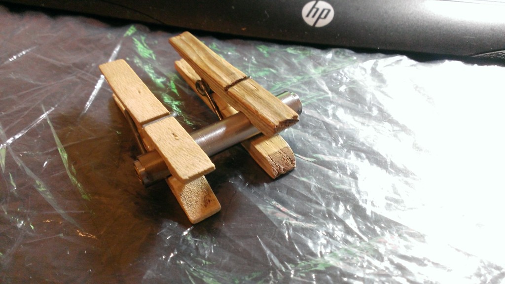

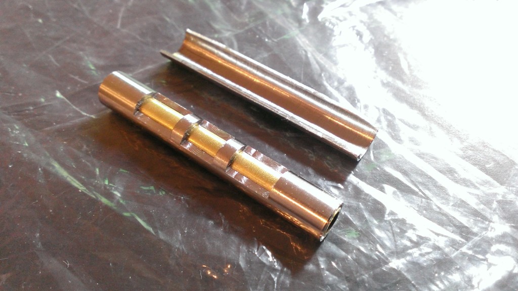

After reading a while (some lousy how-to and few diagrams) I decided to take the trial and error road to find out more about R-hops.
What I thought that would improve the accuracy is increase the hop up bucking contact area with the BB, standard hop-ups only offers a contact "point" or "knob" and R-hops offers a flat surface with it's patches. I bought the airlab R-hop patches once, total wast of 18 pounds, just some badly cut sections of somewhat silicon/rubber tube.
So I decide to make myself some patches and I want to be able to use materials of different toughness. I cut 3 slots on a section of a airsoft 6.01 tight bore barrel that I had left from another project, pushed in a 6mm brass tube using a vise then drilled 8mm ID SS tube to 8.5mm ID and milled it in half. I'm going to cast some patches with this mold using hot glue, silicon glue... Whatever that I think may work and try them out.
