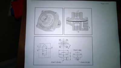

Just received it in the mail today so really excited on startinga build, I am a new and am unable to just look at a QEV identify which port is which!!
The only Info I can find jhas specs for the QEV but doesn't say what connection iswhat , if it is stood up looking like a mushroom (if that makes sense) it has the horizontal port labelled 2 and the one coming out the top as 3.
Looking down 3 and also what I assume is 1 you can see a grill and between these looks to be a rubber diaphram,it would seem to be closer to the grill of port 3 than port what I assume is port1, but it is not easy to see.
Also looking into port 2 there seems to just be a cylinder that looks to be part of the casting
So any help appreciated, thanks

Port 2 is 'chamber'
Blow air into port 2 (using your lungs) - note where the air comes out of the valve - that's your barrel port

Thanks, much appreciated, i will give it a go.

I checked it, turns out that if I blow into port 2 it comes out of 3, so that's the barrel then?
I found this data sheet on the valve, not doubting you but can anyone verify from the schematic diagram what each port is -
http://www.docstoc.com/docs/70982763/Qu ... valves-P4Q

- POLAND_SPUD
- Posts: 5402
Port 2 is chamber (short lenght of pipe/fitting that stores air for each shot)
Port 3 is barrel
Port 1 in piloting side (that's where you put the piloting valve)
Clearer now ??

1 pilot 2 chamber 3 barrel

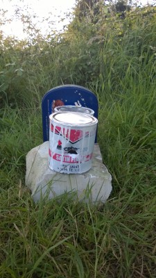

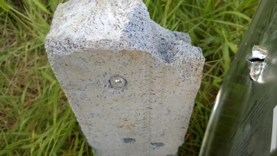

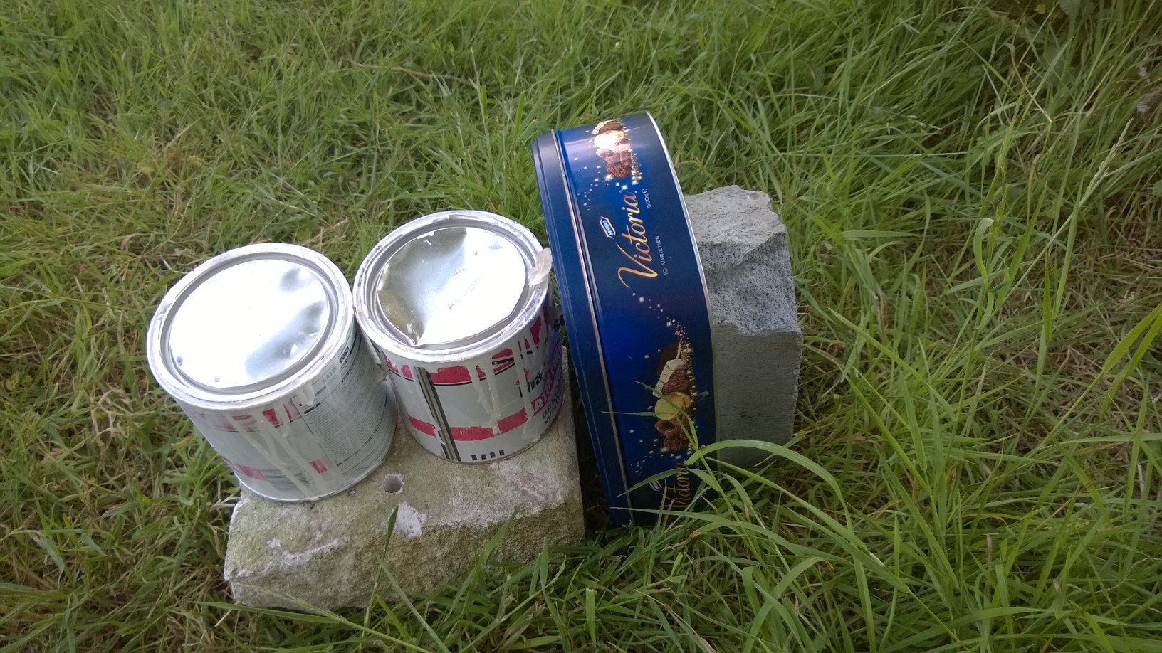

Got my 12mm (just under 0.50" to you guys!:) few parts short for my guuun so it was a bit of a jhash together, mainly for testing. I used the Parker 3/4" QEV along with an unknown sized tank constructed of 42mm copper tube, I just made it the length of pipe I was given, I estimate it to be 65cm long. Therefore way larger than required. The barrel was supposed to be 12mm i.d. but I drilled it out with a 12mm drill. My slingshot BBs are now a perfect fit, I did a bit of testing around 120-140psi and all was fine. Ramped it up eventually to 275psi (too scared to go higher). It doesn't look pretty butm am pleased with rthe power
The photos show how the Tins and block was arranged and it was taken from point blank, but still I am really pleased and it has given me the incentive to use high pressure components and use a few more psi, not sure how much the new barrel helped as it has almost doubled in length, so I guess all the excess air I am using has been working for longer.
Thanks to everyone who helped me along the way, couldn't have done it without your help.
